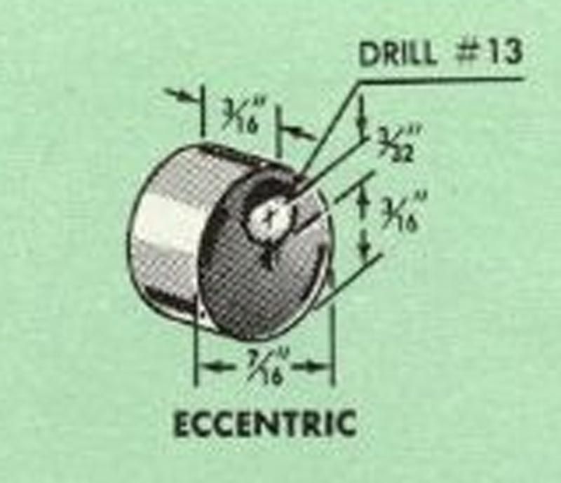

        Hi all,
        Can someone please help me understand a small detail in this drawing please.
        I'm not from an engineering background and struggling to understand the measurements to make the eccentric on this little engine I've almost completed.
        In the top left corner it shows the eccentric as being 7/16 dia, yet the measurement just to the right of the drawing looks to me as if the radius is 3/16 or is that a measurement from the edge of the bore to the edge of the work ? That to me would seem an odd measurement to include and still doesn't seem to fit with other measurements.
        In the bottom right drawing it says the eccentric is 3/16 stroke am I right in saying that 3/16 is the total movement of the eccentric rod but the throw is to be 3/32 ?
        I don't know what you think but to me the drawing seems a tad misleading and any help would be greatly appreciated

          I can't see what the 3/16" dimension refers to; it seems to be just plain wrong? I would ignore it. Correct, an eccentric throw of 3/16" means that the hole is 3/32" off centre, as shown on the drawing.

            It appears to use the idea that a slightly smaller drill than the required hole size will give fairly precise hole of the correct size so for running fit on 3/16 he would choose a number drill around 0,001" smaller. i have a feeling I would buy reamers to make some of them.
            Going on the above the port in the valve is intended to come out 3/16 long. I know zilch about steam engines but wonder if the stroke ( twice the throw as used here) should be somewhat longer ? Some one on here that is into steam engines should be able to clear that up. Also maybe how much top clearance to leave in the steam chest at the top of the valves stroke.

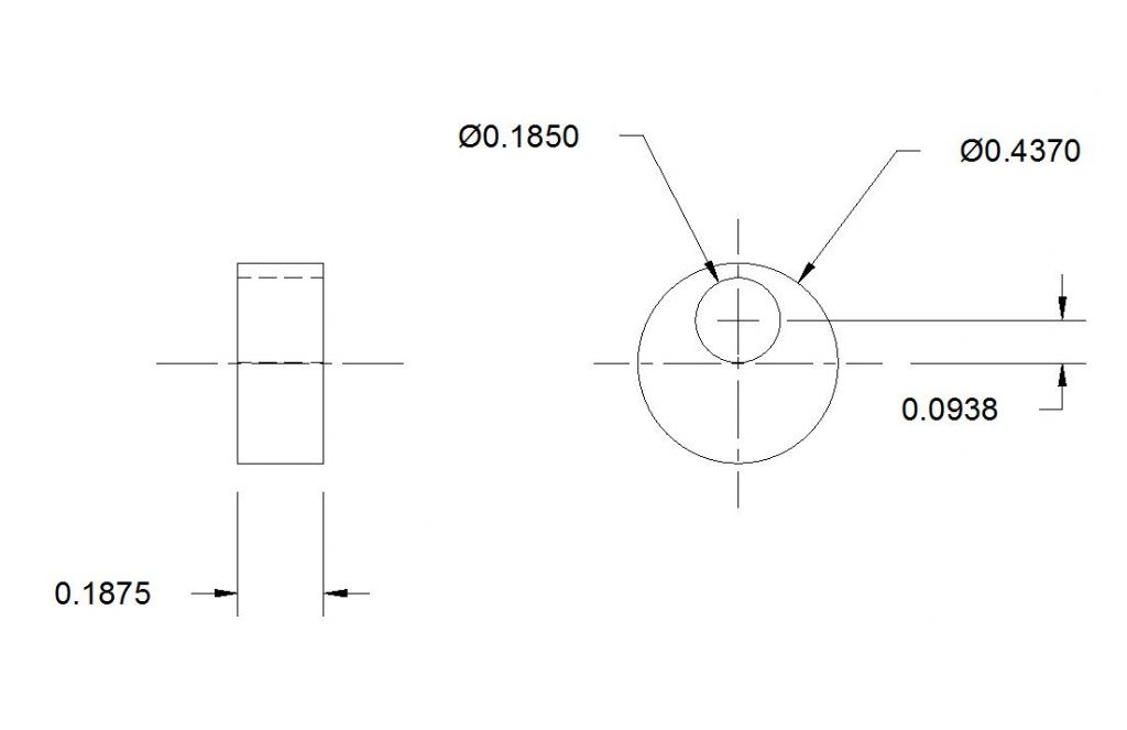

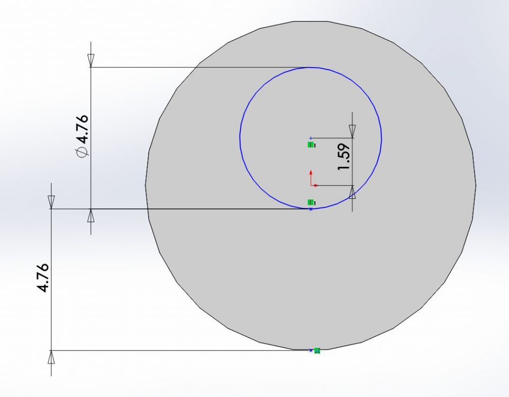

              Hi, I have just took time out at work to model the eccentric based on the dimensions I see. Something doesn't look right. The throw seem too small.eccentric.jpg

                  It's not you Peter, that "sketch" is amateurish. Given that the stroke is more likely to be an important dimension, I think it is supposed to be as below.
                  However that is insanely close to the edge. I would increase the o/d and modify the con rod to suit

                    The stroke of the valve is twice the offset of the hole in the centre of the eccentric.
                    I think it's meant to be 3/16" stroke, it's just dimensioned badly. 3/8" would be way too much.
                    This means the central hole in the eccentric needs to be 3/32" off centre, as illustrated. This means the outer edge of the 0.120" hole is at just under 5/32" from the centre, leaving 1/16" of metal which is plenty in my book.
                    This will only mean the valve opens by 1/32" at each end of its stroke, but I don't think that will be a problem. The critical dimension is the 1/8" at the end of the valve and ensuring that is lined up with the inlet passage at (valve) mid-stroke.
                    I think the 3/32" dimension is a radius for a decorative recess on the eccentric, leaving a rim 1/32" wide. This has no purpose and other wise the engine is very functional, but you can make out such a tiny rim on the drawing.

                      I agree with Neil. The valve throw is 3/16" as shown on the Engine Assembly drawing so the pin is offset by 3/32". The crank plate is presumably a disc so the 1/32" rim could help reduce friction.
                      I have to say that this is an excellent example of how perspective drawings only provide superficial ease of understanding. The shading has only added to the confusion. I much prefer a nice set of orthogonal views and a cross section where necessary.

                        Errr, according to my charts a No. 13 drill is 0.185". If we throw caution to the wind and call it 3/16", that leaves a minimum wall thickness of 1/32". Not much, but probably adequate for the design. Personally I'd drill/ream 3/16" and fit a grub screw (M3?) to affix the eccentric rather than relying on a push fit.
                        Upon closer examination there does indeed seem to be a relief on one side of the eccentric, one up for Neil; although I don't see how the 3/32" dimension relates to it. I still think the 3/32" refers to the throw.

                              Bottom right of drawing says 3/16 stroke. You could always use a shouldered pin if you are worried about it breaking out. Are there any other drawings / text you can post? You could always grub screw a collar onto the main shaft rather than add a side disc to the eccentric.

                                Interesting how a drawing that is perfectly clear in fractions becomes obfuscated by converting to 4 figure decimals. People used to be taught fractions at school.
                                So a 7/16 bar (stock size in the days the drawing was made) needs a hole 3/16 dia (3/32 x 2) with one edge of the hole at 3/16 from the edge. So the middle of the hole which is what you want to mark on the stock to align and drill is shown on the drawing as 3/16 plus 3/32. The author showed the only pertinent dimensions and assumed the reader could add these two fractions in their head without the aid of a Babbage Machine.

                                    I think the "3/16 stroke" on the lower drawing is not the eccentric throw, and is shown as offset from the top of the main shaft seemingly to the centre of a rivet holding the counterweight.

                                        I did like this : Diameter 7/16 minus Stroke 3/16 = 4/16 Split i 2 = 2/16
                                        The hole must be located 2/!6 from top and 5/16 from bottom of excentric.
                                        The strok is the difference : 3/16
