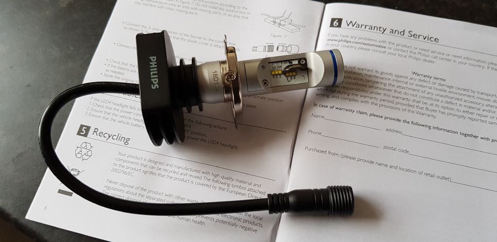

                                              I did look into this before fitting the Philips extreme Led lights. These were very expensive lights & conform with current regs. From memory i paid £132 for them. The problem you raise is that the light defracts & causes glare at the edges of the refractor element. The Philips LED car headlights. Are perfect. I have over the years, spent many hours working on Xenon & LED lights on motorcycles / cars & vans. Most of which were not good for oncoming drivers.
                                              These are great & MOT friendly as my tester who has failed many a vehicle of mine due to this problem has remarked. The beam cutoff point is very good. If you know anything about headlight patterns. You will know how the beam has a cut off & then an angle to match the UK right hand drive code etc. These match. So far i have had them in the Vivaro Sportif for over 2 years without any problems. The light is brilliant. Better than my F-type, which has Bi-Xenon. My motorcycle Multistrada has full LED lights throughout & even turns when cornering. It is a new era.
                                              A snipit . LED lights were illegal in the UK. Suddenly all the new Arriva busses had LED lights. Alla they were no longer illegal.
                                              Steve. My van.
                                              #482819
                                              Robert Atkinson 2
                                                @robertatkinson2
                                                Those Philips LED replacements arre NOT road legal,
                                                The advert you linked to clearly shows the package with a cross through ECE R37 and a "not for use on public roads" warning. The listing also says they are not approved.
                                                There are two interelated reasons for this, technical and apprpval. Technically, as you said, LEDs have competely different optical charatristics to a halogen filament. They are typiclly much larger area and each "chip" has at most a 170 degree emission cone, not the 360 sphere of a filament. The headlights optics are designed for halogen filaments not an LED. You can make a LED replacement that will produce an acceptable beam pattern for a particular lamp design, but it will not work in all lights. The Philips LEDs are probably very good and make an MOT passing beam in your car, but note the MOT just checks for gross alignment errors, not compliance with the full approval requirements.
                                                That takes us to the regulatory part. All mandatory exterior lights on a car (except the reversing light) have to be E marked to show they meet the regulatory requirements. This includes the replaceable "bulbs" which have to meet exact specifications. There is NO specification for LED replacements. So even if you do build the perfect LED replacement the regulatons don't allow )it. Note that none of the cars with LED exerior lights have replacable "bulbs". The whole light is approved and you have to change the whole thing if it goes wrong (you can have up to 30% of individual leds fail before it's an MOT fail). You can get LED replacement sealled beam units as the are a complete lamp.
                                                So basically your car is no longer road leagal. Did you tell your insurance company? If you have an accident they could refuse to pay out (they have to pay the 3rd party claim, but can recover it from you) if they notice. Even worse is if the other driver says you dazzled them.
                                                Robert G8RPI.
