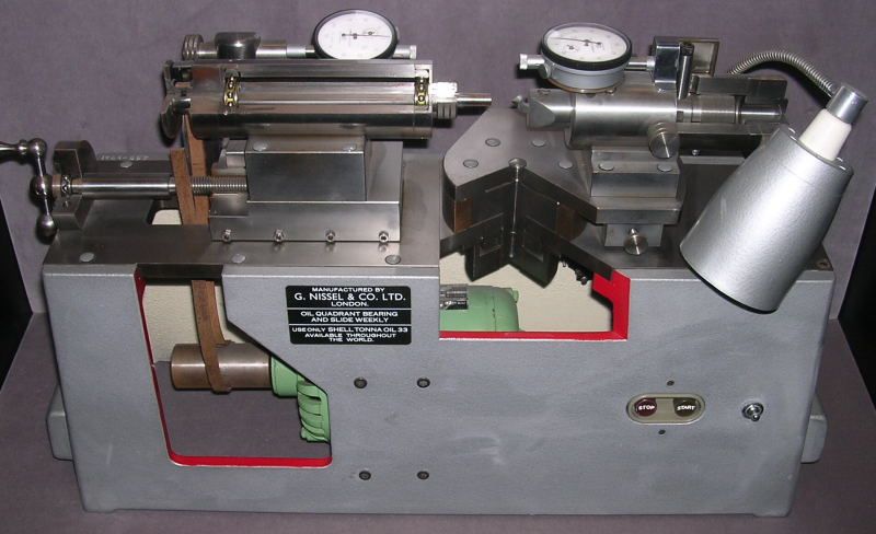

                                            I’m collecting it on Wednesday … hoping to detach the top-plate, etc from the box, for ease of handling.
                                            Grace’s Guide has this rather nice ‘cutaway’ of a different model in the same family :
                                            It will be a while before I can do anything with it … but I’m looking forward to seeing how something with such solid foundations will perform.
