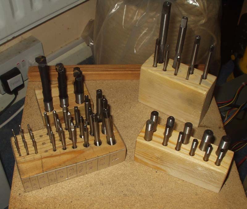

          I store my taps, milling cutters and reamers in blocks of wood with appropriate holes drilled in them.
          Don’t use oak, apparently it reacts with the metal.
          I’ll put some pics on later if you are interested.
          Roy.
          #83063
          wheeltapper
            @wheeltapper
            LIke this
            the wood is given a good wipe over with oil before use.
            Dies are normally kept in dedicated holders hanging on the wall.
            Hope this gives you some ideas.
            Roy

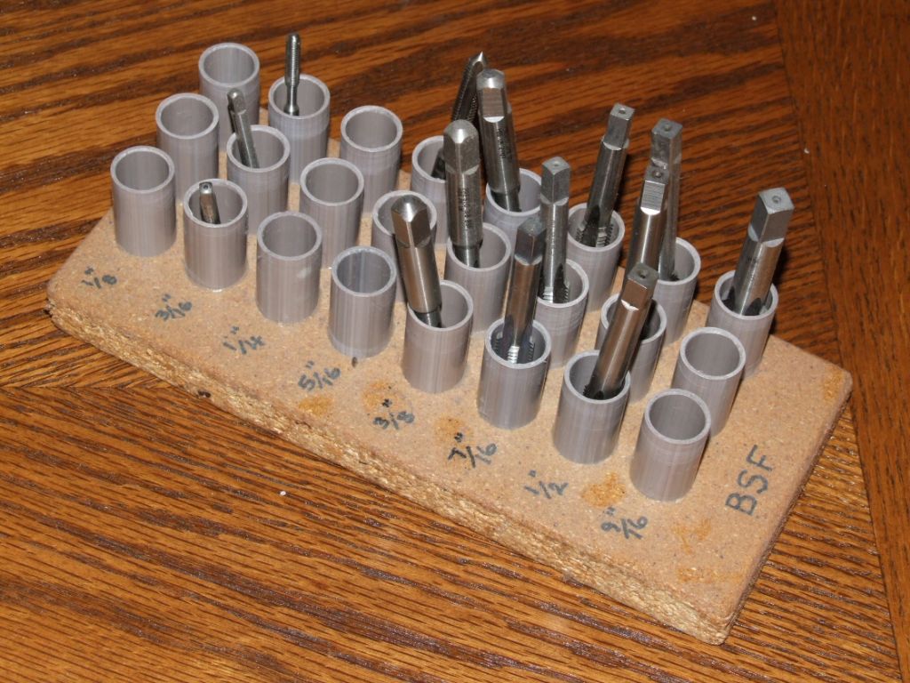

                              I use plastic tubes that the domestic engineer donates to me on a regular basis, these normally contain vitamin C tablets or multi vitamins. They are around 20mm diameter and can be cut down to accomodate various materiels.
                              I mount these in scrap boards of MDF, pine or whatever comes to hand. With a small quantity of light oil or paraffin they provide a rust free storage environment for many small components including taps, milling cutters, drill bits etc.

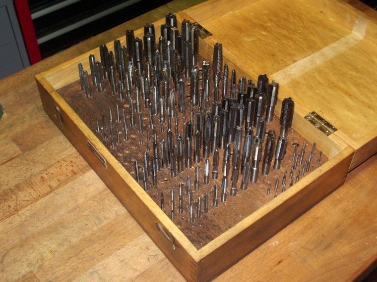

                                      many years ago, I ‘picked up’ and old office KARDEX filing system. These were postcard sized cards which were used for addresses, work progress etc, and were stored flat in a nest of drawers which are about 3/4 inch deep x 24inch long and 7 inch wide. Sling away all the cards and their suspension system and you have a set of super storage drawers – perhaps keep 1 drawer to use for the progress of your model build. With a few wooden divisions, I store taps, dies, drills, reamers, silver solder, marking out tools etc etc. Each can have its own drawer. Perhaps look on flea bay
                                      #83139
                                      Speedy Builder5
                                        @speedybuilder5
                                        This is what my KARDEX system for tap storage looks like, chewing gum tins are good for tiny taps – bottom drawer is a set of chasers.

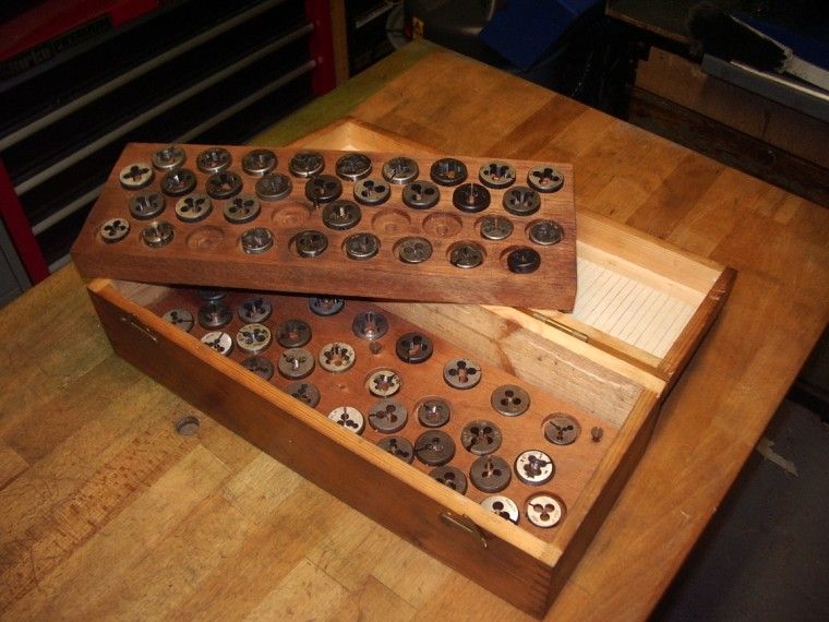

                                        #83153
                                        Roderick Jenkins
                                          @roderickjenkins93242
                                          Here’s my solution:
                                          Taps
                                          Dies
                                          The boxes were scrap timber which we used to be able to purchase for 50p a sack from my employer. The tap box had contained a Mercer surface gauge and , I think, the die box was for storing glass photographic plates. The tap box contains pretty much all of my collection: BSW, BSF, ME (26,32,40), BA and metric coarse. I don’t have many taps above 1/2″ (12mm). The base is 1″ tropical ply and there is some minor evidence of rusting on some shanks, presumably from the tannic acid in the timber. When I made the base 20 years ago I put a drop of oil into each hole. Perhaps I should repeat this. The dies are in solid mahogany and do not seem to have attacked the dies but they are in less close contact.
