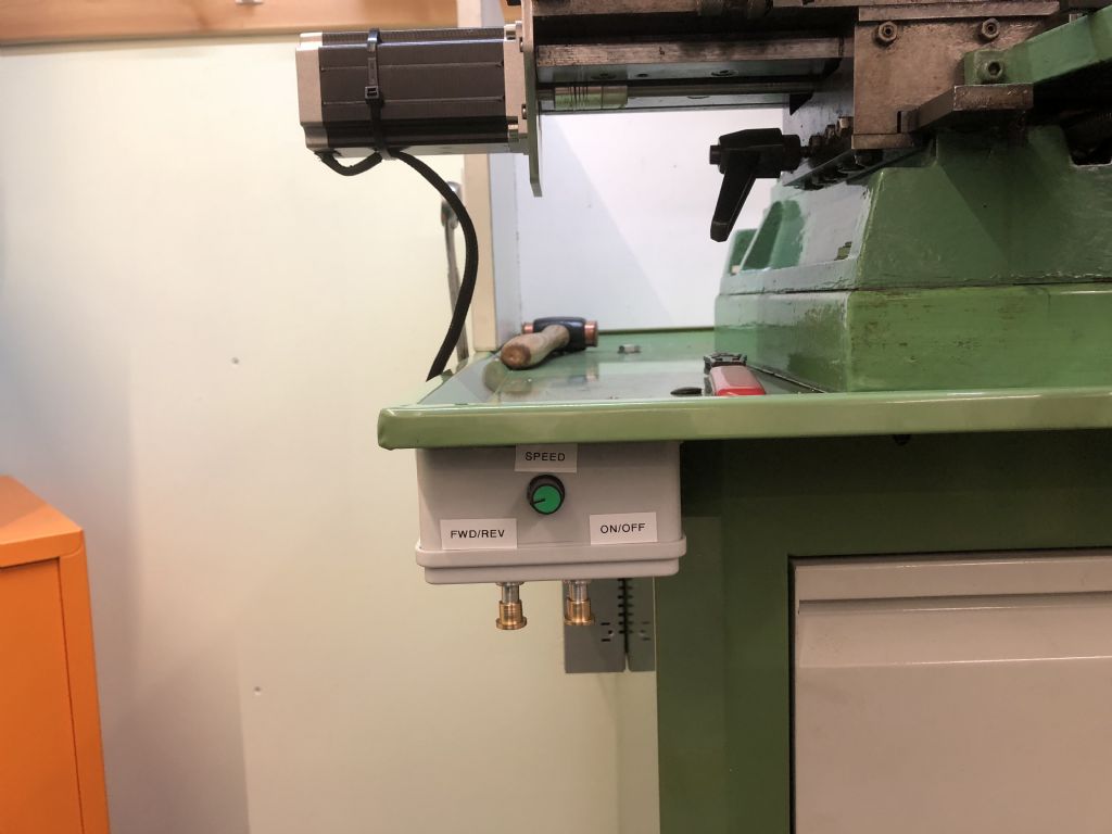

      Thinking of replacing the mill table feed on my Dore Westbury with a stepper motor fed using one of the Pwm speed control units from eBay etc.
      I am thinking in terms of a nema23 motor with a quimat 6600 driver with a direct connection to the feed screw.
      I see how the motor connects and sets up, but am not sure of the connections from the speed control module to the driver are made.
      Has anyone used this set up or knows how to connect it.
      Ian

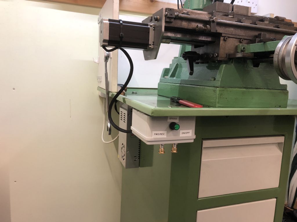

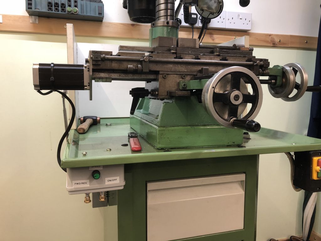

                                              Ian Hewson
                                                @ianhewson99641
                                                img_0834.jpgimg_0832.jpgHi
                                                Finally got the speed controller from China today and wired it in, used spring loaded push buttons for the fwd/rev and on/off control.
                                                Thanks once again for all the help given, especially Myfordboy.
                                                the set up works fine, plenty of power, just needs a swarf cover for the motor and perhaps some limit stops.
