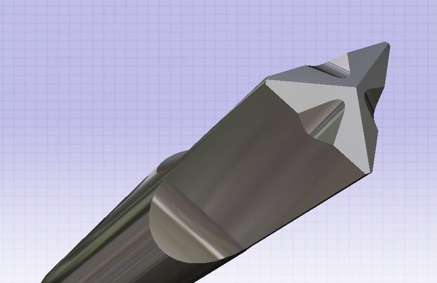

                                  Sam Stones
                                    @samstones42903
                                    Martin,
                                    I cannot recall the grade of Stellite used for the triangular drills in our toolroom. The drill tip had a (very) negative rake. The three notches are about how I remember them, although they may have been a bit wider.
                                    As an apprentice in the early 50’s I had the task of drilling through the nitrided skin of the cavity of a compression mould.
                                    Once through the skin the rest of the drilling exercise was with a conventional HSS twist drill.
                                    The operation required that enough downward pressure was applied to the drill to virtually melt the mould steel. Drilling was more about pushing the metal out of the way. A quick Internet scan shows that nothing seems to have changed to the drill-tip geometry .
