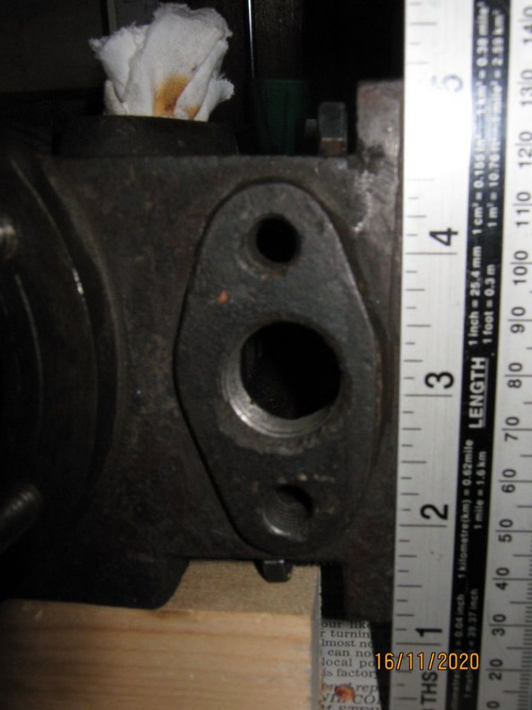

        Hi, Im pretty new to the forum, so apologies if this has been covered before – however I have searched at length both here and on the rest of the internet with no clear answer. I'm restoring a 19th century workshop steam engine and its going well so far (I'll put up a 'ongoing project..' and album when I have time).
        Can anyone assist in identifying the type of steam pipe connection that would fit the input, looking at the attached photo the flange mounting threads are about 2" apart and the port tapped 1/2" x 14 BSP. I ASSUME there would be a union screwed into the port, then possibly some kind of matching conical pipe end clamped by a 'free' flange of some description?
        Most pictures of engines of the same era just show the flange bolted directly to the steam chest, without enough detail to determine how the 'internal' bits are made/put together.
        I have nothing to go on, and have been unable (so far) to find a book, web page or drawings etc that might give a clue to what would be typical in this era.
        Would these be brass or iron? Would copper pipe be the norm? etc. Just if someone could point me at a practical book that covered such topics that would be great!
        Any help much appreciated. regards Mike

            Prototypical would be a gasket between machined flanges (Pipe and cylinder)
            Non prototypical solution might be flanges, sealed with silicone rubber, and tightened immediately. This is effectively a metal to metal joint with the silicone rubber being used as gap filler. How much pressure it would stand would depend on the out of flatness of the cast face vs the machined face of the pipe flange.

              Someone may have tapped that 1/2 x 14 BSP intending to use airline heavy galvanised pipe straight in.
              Originally I would have expected copper pipe lagged with asbestos tape. Don't use brass if steam goes through it

                    Looking in my books, slightly newer than your engine but probably not significantly so, it's probable that the pipes would have been iron or steel, connected to the engine and other parts of the plant by bolted flanges, and to each other by flanges, unions and malleable-iron fittings as appropriate for the particular pipe sizes and installation.
                    The examples in Spooner 1913 show iron screw-on fittings, whose general forms are still readily available simply because no-one has devised any better for fairly general-purpose work, as this would have been.
                    The flanges, union-nipples and their mating flanges, and the T-pieces, elbows etc. are simply screwed onto threads cut on the ends of the pipes.
                    The pipe thread would probably have been and still be BSP, possibly Taper whose length standards give proper taper length without the pipe protruding from the fitting.
                    However, the same author does also describe copper pipes being widely used for steam supplies to engines, ,but does not cover this aspect in great detail. The material was problematical in larger engines, with pipes several inches and larger diameter. It was certainly common for the auxiliary fittings, drains and the like.
                    The same reference also stresses the installers need allow for expansion. On a small installation with the engine and boiler close together this is probably taken up by a couple of bends or elbows in the steam line.
                    I am surprised that the pipe boss was left un-machined, and not even particularly fettled, if those pimples are in the parent metal. It is clearly intended for a 2-stud flange, and therefore should have been faced.
                    If intended for a screw-in pipe I would expect the designer to have specified a circular boss thicker than what is there, and no stud holes. Studying my books and from seeing many actual old machines, I doubt that intention in this example – the threading was an installer's idea. .
                    The complete installation would look right with a flanged connection – it is feasible for you to mill it, skimming just enough off to give a fair joint face? Even careful dressing by file would be appreciated by the gasket – either way, be very thorough in cleaning out all the swarf, as the grains could badly damage the working surfaces. Note that the skin of the iron could be hard.
                    I would not rely on silicone rubber sealant lasting long as a gasket especially on that rather rough face, but silicone rubber sheet might be satisfactory.

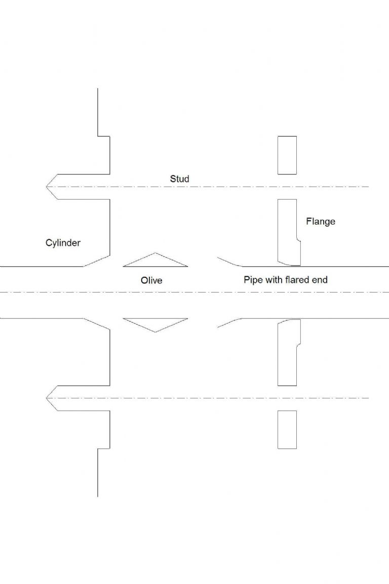

                          Just a suggestion – maybe the taper is the clue. A bronze olive would sit in there and a flare in the end of the steam pipe would fit the other end of the olive. a matching taper in a loose flange would permit the whole lot to be clamped together. I think this sort of connection was favoured in flash steam engine construction. Hopefully there is a basic sketch below.

                            You could right, Jason, that whoever installed that engine in its past screwed a union nipple into the flange, but I do not think that was the manufacturer's intention. Nor of course was a 4-bolt flange.
                            It was evidently designed to take a 2-stud, oval flange, and plenty of smaller engines and their fittings used those; but it's puzzling why the manufacturer machined the exhaust connection but not the more critical inlet.
                            Not cost-saving – as facing the inlet but not the exhaust would probably have cost the same.
                            So was it somehow overlooked by both the machinist and the inspector, assuming the makers had any reasonable quality control!* Probably. We would naturally assume facing the seating, and drilling and tapping the stud-holes, on one set-up on a milling-machine or a horizontal borer, but that is our mistake. The drilling and facing on this engine were separate operations, as Michael points out the exhaust face was shaped (or planed).
                            I do not believe that thread was original. I think it was put there by the engine's installer, either from new where the customer bought only the engine without installation service; or in some second-hand location done down to a price. There does not seem sufficient metal for it – it looks like no more than 3-4 turns, and concentrates the load on too small an area.
                            I would advise flattening that oval as well as possible, preferably by machining, and using the proper oval flange and studs, with a suitable sheet-material gasket.
                            The flange fitting the designer probably had in mind was an oval, malleable-iron one with a generous tapped boss that would have been screwed to an iron pipe – a catalogue item. By the early 20C pipe-fittings were readily-available, commercial items; and quite likely were in this engine's time.
                            You could use a copper pipe with a gunmetal / bronze flange silver-soldered on, and from my books of near the time, that would also be in keeping, though you might want to lag the pipes anyway.

                                Again, thanks for all the input. Geoff – its not 100% clear from the photo (best I could do) but the 'taper' on the hole doesn't appear to have been machined, Its a bit rough and eccentric so I think it was as cast. With some of these things though its difficult to be sure as parts were heavily corroded externally – not sufficient to weaken the castings structurally more cosmetically.

                                  I wonder if what has been assumed to be a cast surface is a pitted one that has been cleaned up and painted at some time. The exhaust connections may have stood protected by their flanges but just a threaded pipe going into the inlet would have allowed the uncovered machined face of the boss to rust and pit.
                                  On what is quite a small engine I also wonder if they would have cored the inlet hole giving a "cast face to the edge" or if again rust has pitted it at some time.

                                      Badly pitted – it could well be.
                                      There is a definite hollow by the 3-1/4 " mark, possibly a few others; but there seem to be pimples on it too, as at 4-1/8 " altitude (look at the shadows). Pimples would be casting artefacts.
                                      The " countersinking " may have been to ease the tap starting and minimise swelling, but is badly chipped, as is the metal around the stud holes.
                                      Looking again at the photo, have the stud holes been lightly spot-faced?

                                        Thanks guys. After looking back at it yesterday following all the various comments and suggestions, I realised (proving how observent I'm not) that the threaded holes are through into the steam chest, not blind as I had in the back of my mind. This seems to confirm that there must of been something fitted in them or steam woud be blowing all over the place, so a flange & bolts the most likely. A definate conclusion about the threaded BSP hole still remains unclear.
                                        Cannot see any indication of spot-facing around the thread holes.
                                        As I said in an earlier post I seem to be getting a feeling that a straightforward flange bolted on directly (to a cleaned up casting) with a suitable gasket is going to be the way to go. There are so many 'maybes' that after a time you start going round in circles and almost forget why you asked a question in the first place. However the comments from all in the thread have been interesting and I've picked up some useful ideas and tips, so thanks to all. This forum is a really valuable resource. Regards Mike
