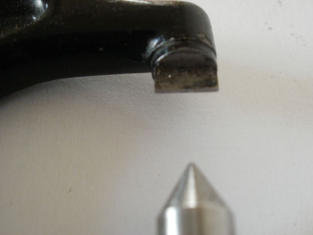

      Hi . Can any one identify the use for this Starrett micrometer. It has a pointed spindle and a single"V" anvil.
      Regards Ian

          Hi Ian
          Screw thread micrometer I think you will find.
          Cheers
          Norman

          MICHAEL WILLIAMS
            @michaelwilliams41215
            Yes – screwthread micrometer and it will be specific to one thread system eg Whitworth or ISO.
            The slopes of point and anvil engage the thread flanks .
            MW

              Thanks for that.
              I assume its Whitworth as its stamped No. 436-1"
              Ian

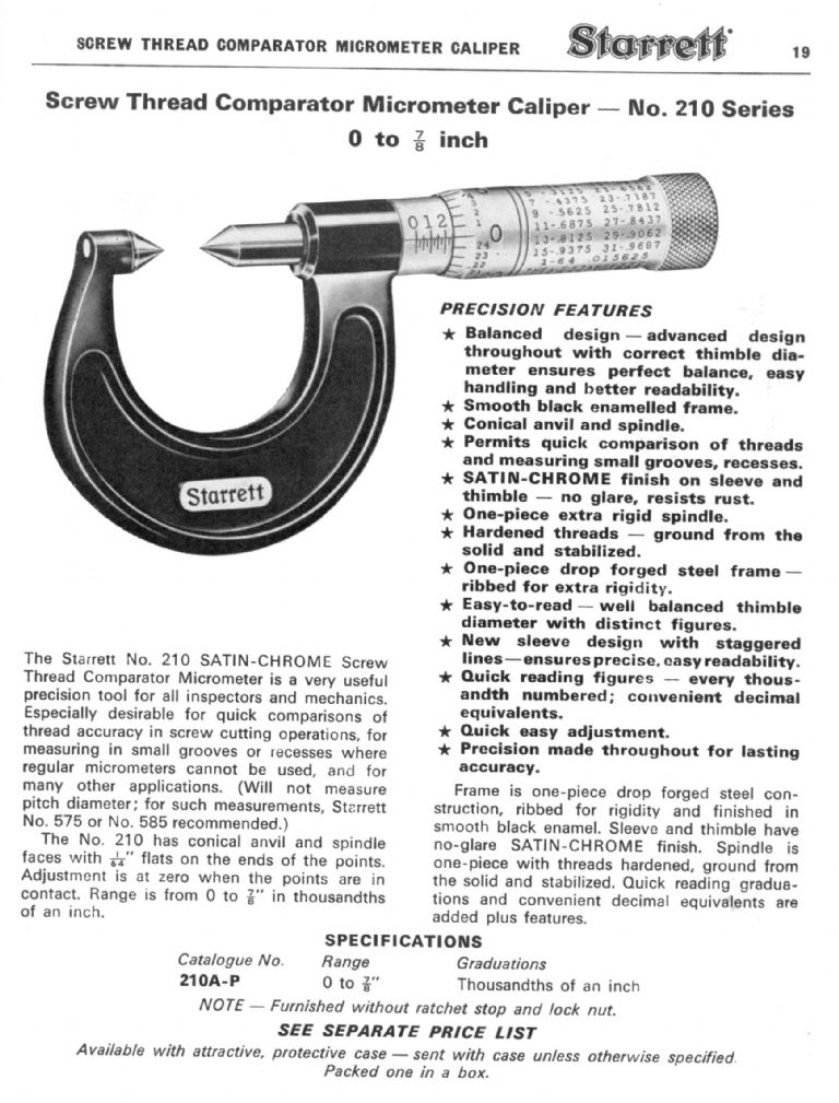

                  Screw thread comparator micrometers are 210 series, and have a conical anvil and spindle. Please see scan below.
                  Starrett 210 series

                      Hi.
                      Dick. Good point. I've measured the pointed spindle angle and it's 55 degrees.
                      Nick. I also looked on the Starrett web site & their thread mics have a double "V" on the anvil. The one I have looks to be original not modified.
                      Ian. Yes I can see how it could be for that.
                      Regards Ian

                        ianj
                          @ians
                          Now that I look at the anvil "V" more closely, it's actually flat topped so would not bottom in a thread.
                          I can see how it would measure tube wall thickness.
                          Maybe it is a user modified one.
                          Ian

                              ianj
                                @ians
                                Hi Norman.
                                Thanks for that information.
                                The description states:-
                                "This Micrometer has a pointed spindle and a double V-anvil, both shaped to contact the screw thread. The micrometer reading therefore gives the pitch diameter."
                                The anvil on mine has a single flat topped "V" which lines up with the point on the spindle.
                                As MikeW states above that would not measure a thread.
                                I think I'm going a long the line of thinking it's for measuring tube wall thickness or it's a user modified one, although the spindle & anvil do look to be factory produced.
                                Regards Ian

                                      ianj
                                        @ians
                                        Hi All.
                                        Just emailed Starrett with the photo & description of my micrometer. Will post you with there reply, if any. ( I find some companies are better than others over such questions)
                                        Ian

                                        ianj
                                          @ians

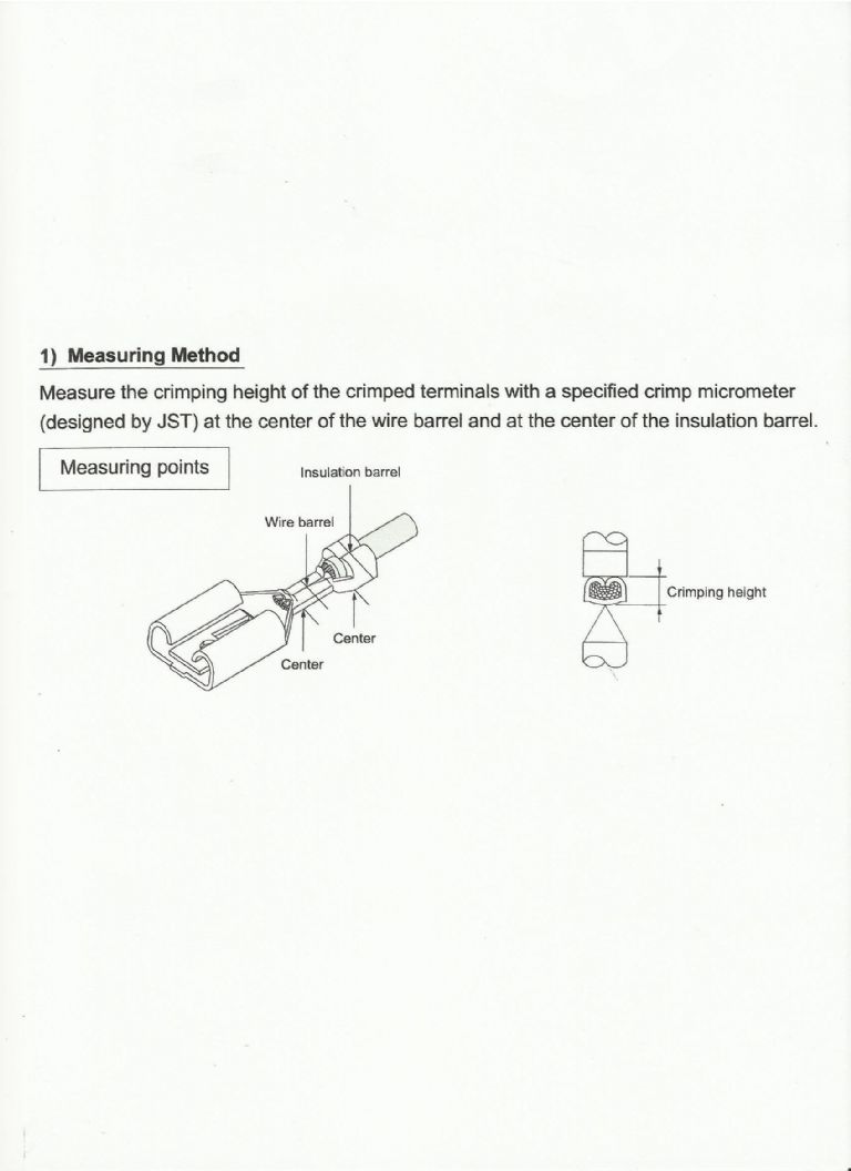

                                          crimp micrometer
                                          Well straight from the horses mouth (Starrett) the mystery is solved.
                                          It's a crimp micrometer.
                                          We can all sleep easy to night now.
                                          Regards Ian

                                          NJH
                                            @njh
                                            Well Ian so there you are – we are all wrong!
                                            Still a very useful item to have in your tool box – just get out at every opportunity and measure a few crimps!
                                            Cheers
                                            Norman
