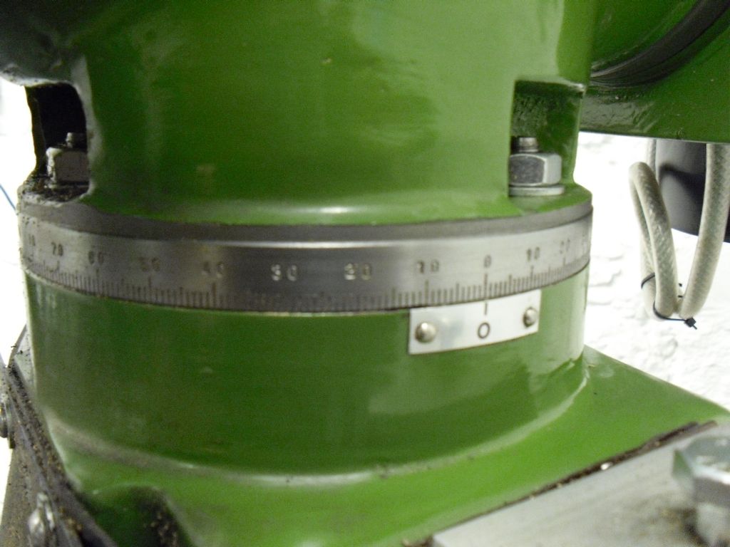

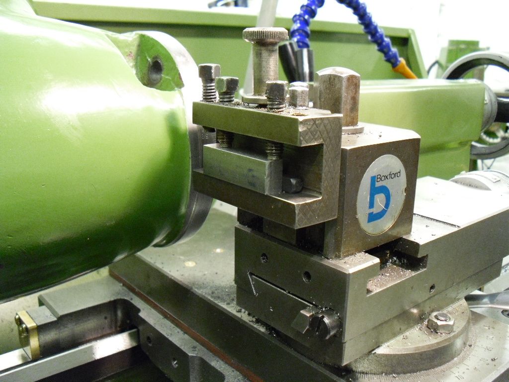

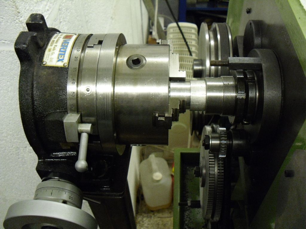

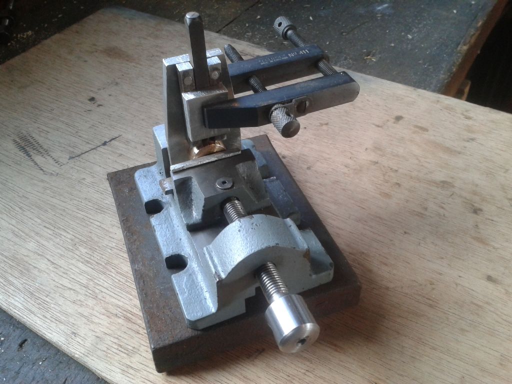

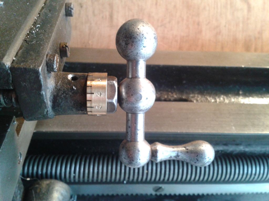

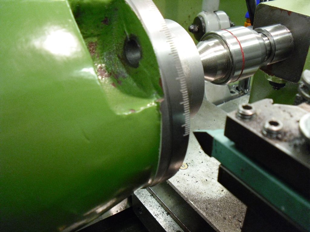

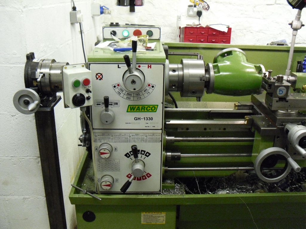

                          I used my rotary table mounted on a stand and connected to the lathe spindle to cut new divisions and stamp new numbers onto the flanges of my Warco VMC mill. This was to replace the standard factory glued on scales.
                          I made an expanding mandrel to grip and drive the lathe spindle, and first I cut the divisions with a cheap carbide tipped lathe tool mounted on its side.
                          The fourth photo shows the numbers being stamped. The number stamp can just be seen mounted in the toolpost behind the block of steel used to guide it. The turret castings base flange and front verticle flange for the swivelling head were both done this way.
                          Dividing.Dividing.Engraving.Numbering.Head degree scale.Turret flange degree scale.

                            11/10 for improvisation!
                            #282047
                            Tony Pratt 1
                              @tonypratt1
                              Excellent set up, well thought out!wink
                              Tony

                                    That's exactly the sort of story and photos many readers would like to see in MEW.
                                    Please consider writing it up!
