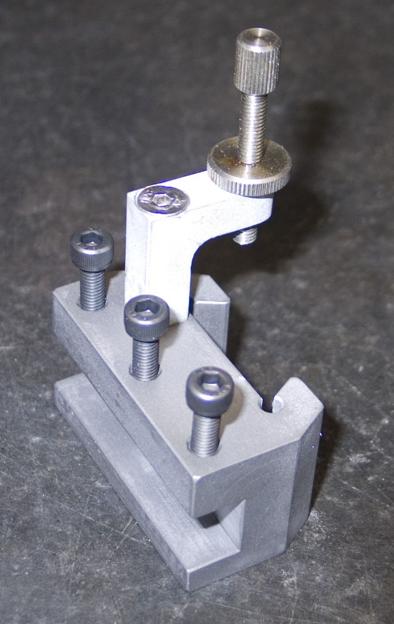

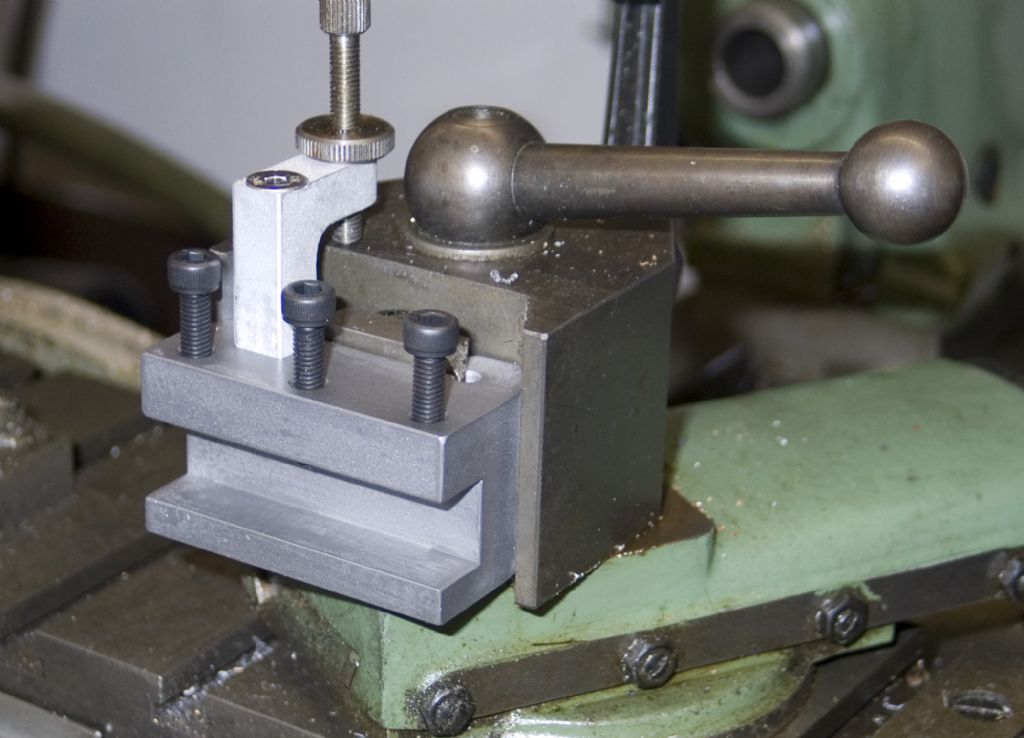

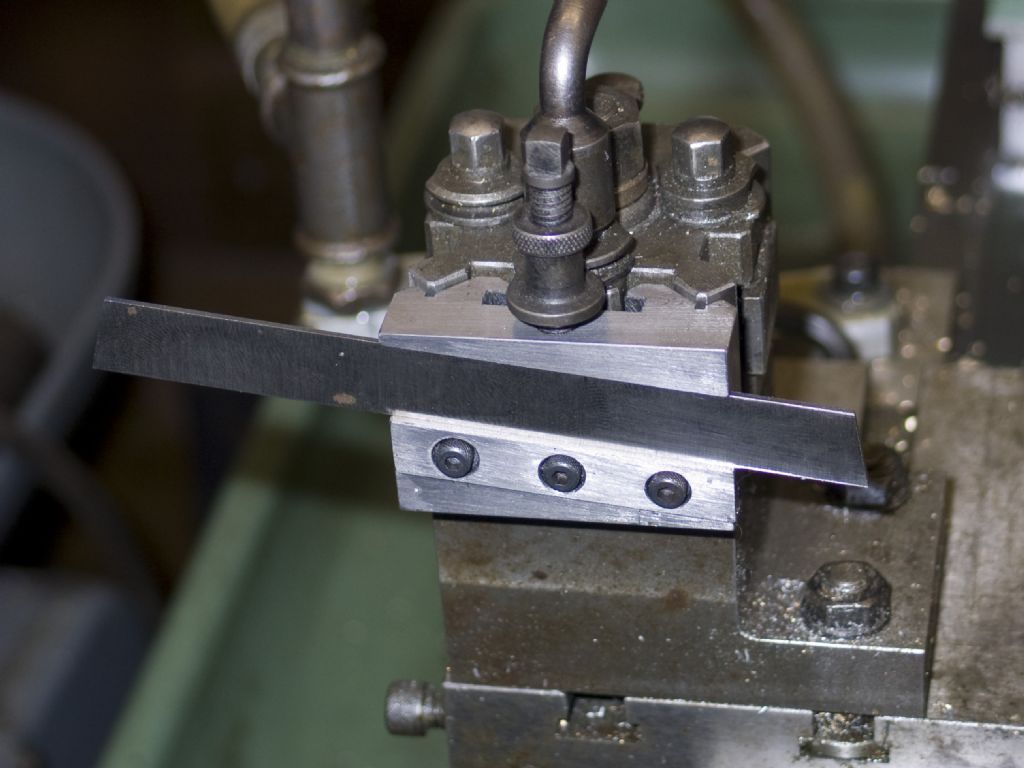

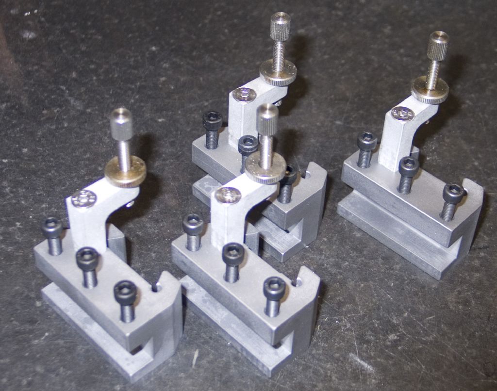

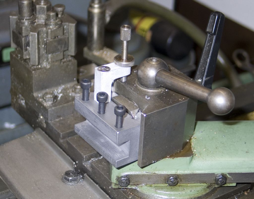

        OK lets put this to bed, I have stuck with cap head screws and just slightly domed the ends. The Tool "Holders" are now finished.
        A few piccies.
        Some people might not recognise this toolpost design, it was originally intended for an Emco lathe. I bought the original block and one tool holder from Neil Hemingway in Rochdale many years ago.
        The quick change toolpost visible at the back of the cross slide is like a miniature Dixon type but the tool holders are less than 2" long so it is tiny. It gets used with various parting and grooving tools as well as chamfering and boring bars, all upside down of course. I have made a few special holders for this one as well.
