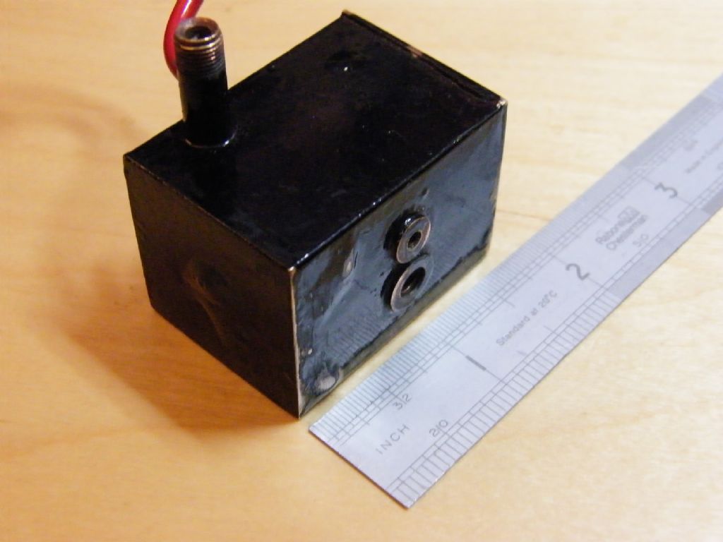

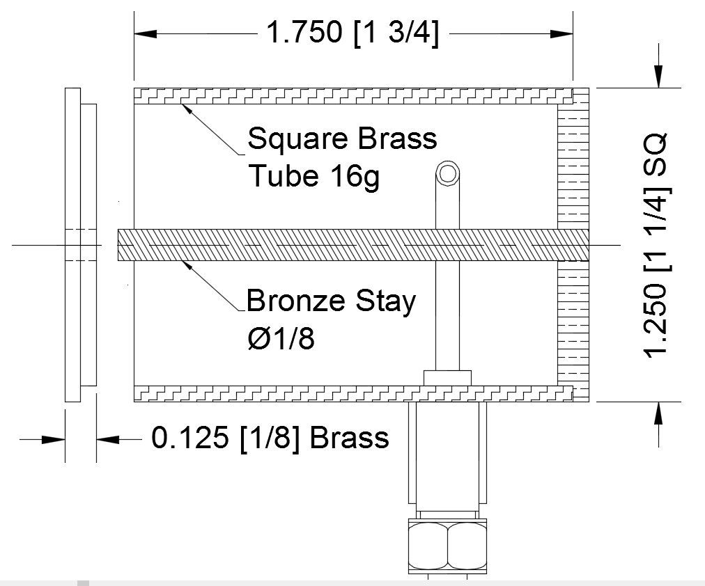

As we do not possess a test certificate for the tank or boiler, we decided to test both before presenting the boiler for testing. An earlier thread carried a link to this test schedule, so our intention was to test to 185 psi and to use only pure butane.
**LINK**
The tank is in a well ventilated position right under the roof of the open backed-cab and in operation is unlikely to be affected much by the boiler, but it could become heated in the sun as the model doesn't have the double roof of the prototype.
I had wondered about a round tank concealed in a box, but didn't want to make any change to the gas capacity until we know the run time of the loco. As the tank/valve/jet assembly is easy to remove, one option might be to do this as a display tank, with an alternative longer cylinder (perhaps rated for mixed gas) for extended running, although the off-axis location of the filler (dictated by the existing hole in the cab roof) could be an issue.
