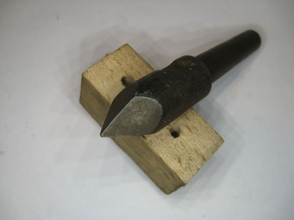

      Having a look for something today I came across some No1 dead centres which had been ground (accurately) into a now square point. The smallest of them has had the end reduced to about a quarter of an inch dia with the square ground on the tip.
      What would they be used for? I have no idea!

          Could have been to turn a particular part that had a square recess at one end, between centres.

            This is a cutting centre . You will find references to them in old books on turning . In olden times the recommended method for making centres in the end of a bar for turning was to mark out and drill the ends with a small hole by hand . The work was then mounted in the lathe between one plain and one cutting centre whereon the cutting centre turned the original plain hole into a nice neat conical centre hole . Reverse ends to make another one and then swap cutting centre for an ordinary one and proceed with turning .

                I’ve got one. It isn’t great but useful for centering something that won’t fit in a chuck easily.
