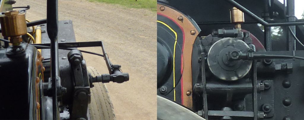

            Paul Lousick
              @paullousick59116
              One of my friends who owns a full size Fowler traction engine has fitted a cable driven tachometer (same as a speedometer) to monitor the crankshaft speed.
              The input shaft of a small 90 degree bevel gearbox is attached to the end of the crankshaft and the output attached to the cable from the tacho. The bevel gearbox is a standard unit, used on car speedo cables. Very useful on road runs to maintain a constant speed and not over rev the engine
              Paul.
