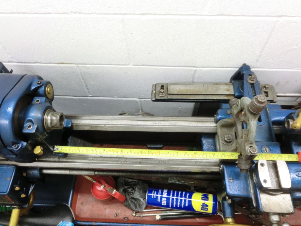

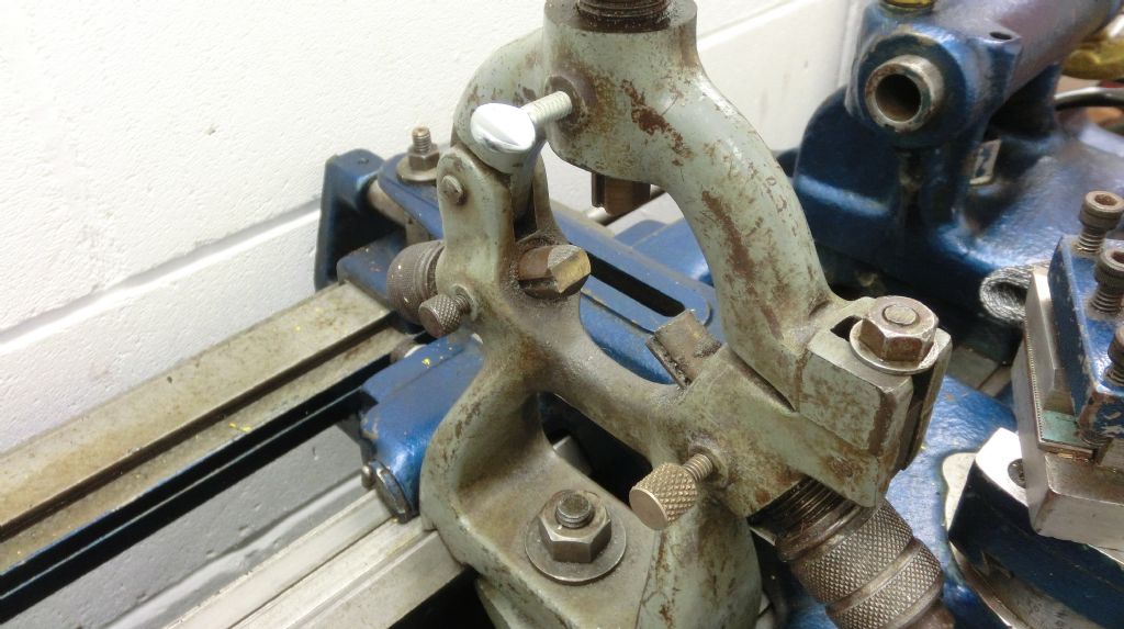

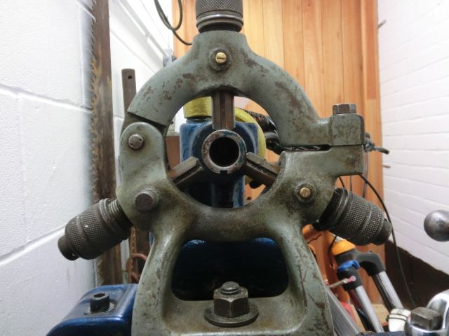

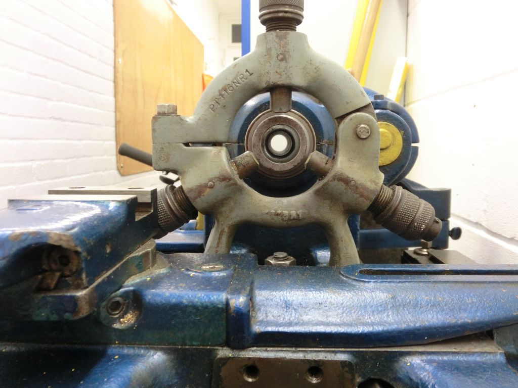

        cimg9351.jpgMerry Christmas and a happy New Year everyone.
        My planned Christmas present from Mrs B was delayed, but fortunately an item I happened to see on Ebay turned up just in time to replace it.
        A fixed steady for the South Bend lathe. This is a very rare item in the UK, where these lathes are uncommon to say the least, and an expensive import so this one was worth a punt. In the event this item not only fits perfectly but also works perfectly as well, so I am very pleased. The only point of note is that two of the knurled locking screws have been replaced with brass slotted grub screws, this has happened recently as the screws are bright; I would have thought that they are a bit easy to damage, so I shall seek or make replacements.
        This should allow me to machine long shafts and tubes, especially some steel I have that will be good for wheels and rolls for the small traction engines and rollers that I like, I am still crossing my fingers as the diameter that this fitting allows is a bit small. That's what you get with a tool room lathe that assumes that there is a bigger lathe somewhere. The upside is that this casting is very strong and flows metal around the adjusters, which are sublime in action, so it is many times better than the current style of inexpensive lathes that have most of the metal slotted out. Either way this important piece of kit was missing from my machine so it is now complete in that I have a travelling steady, three and four jaw chucks and a taper turning attachment.
        Allowing for the chuck I should be able to cope with 500mm long workpieces.

          That's a good stout steady. Makes the flimsy Myford equivalent look laughable. Very handy for machining and parting slices of the ends of bar too big to fit up the spindle bore. I have plans to make a similar one for my Myford. Made one for the old Drummond and wouldn't be without it.

            Nice taper turning attachment too.
              My guess being that the originals had the scars of Mole Grips all over the knurling
              … Nice steady yes

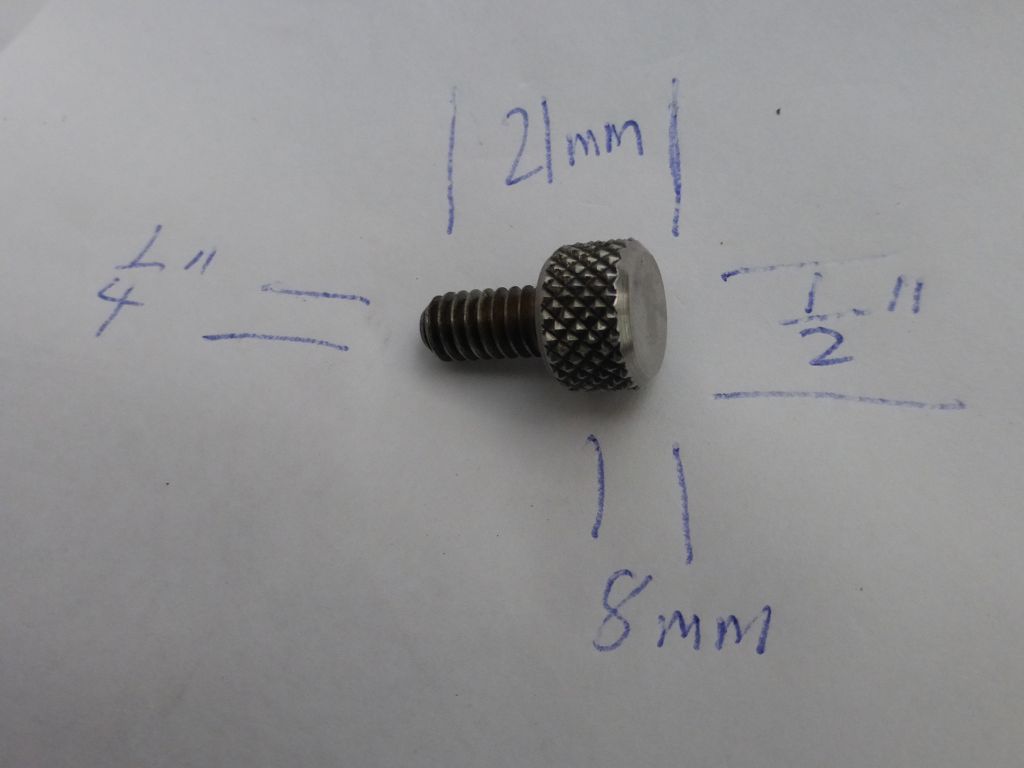

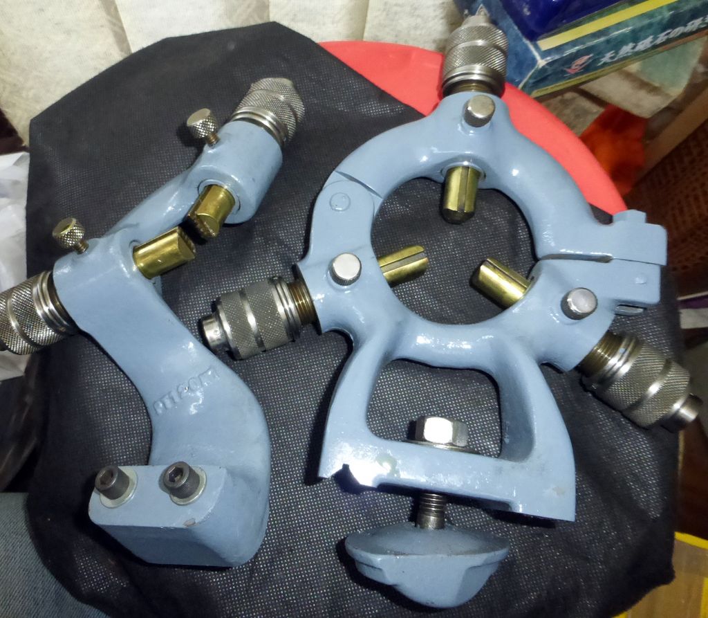

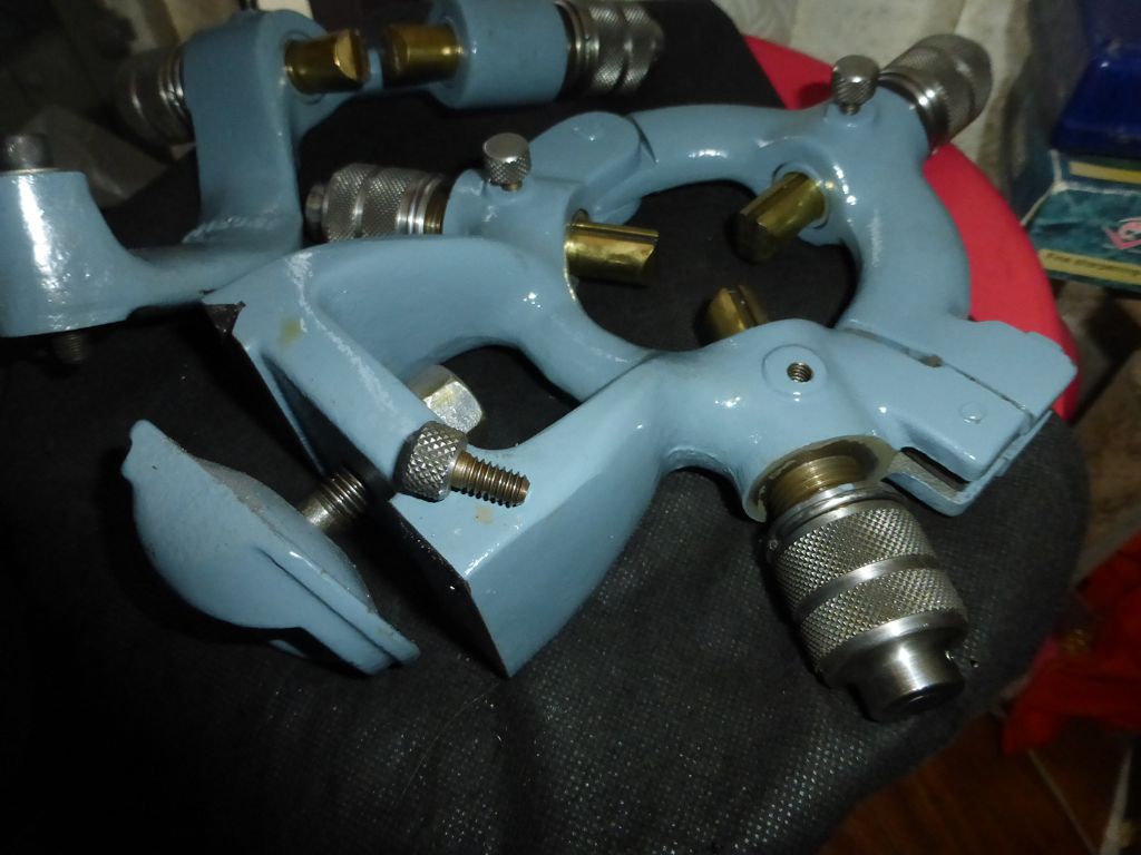

                  They are nice rests , i got both with my SB 9A. A few pics and one of the thumb screw attached.

                      If you have a mill, you could easily make a second set of fingers with little ball races at the ends, then your steady will be complete. When usung a steady, cut a disc of card to fit on the work to stop swarf getting caught in the fingers.

                        Mark – 1/4 what? UNC maybe? Thanks for the pictures, they will encourage a paint job and buff up.
                        Old Mart – good tip, thanks. This is an old machine so there are very few rolling element bearings, a few small races would be a good update.

                          I think they a 1/4" x 20 UNC

                            Thanks, a good place to start.

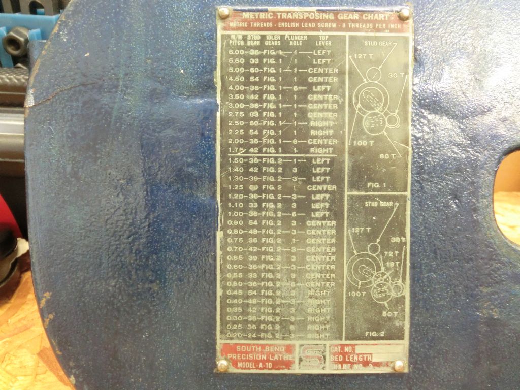

                                No Pete I don't. It has a table of metric settings and a diagram on the cover but the extra bits are missing.
                                Not a big deal but sod's law a says I will regret it one day.

                                  I would appreciate it if I could get a good pic of the metric setup diagram Roger. I mean to make a metric banjo and gear set of my own. Would you be able to take a photo of it do you think?

                                    Certainly Pete.
                                    I have one at low resolution but it isn't clear enough, I will take a better shot today.

                                      I have put three images in my album at different resolutions, I probably should have cropped them down. (DOH!)

                                          Seems like the forum has re-sized them all to 1024. No matter, they are legible so I'm off to make a set of gears and a banjo.
                                          Thanks Roger.

                                            There are differences related to the gearbox used, which do you have? The later machines seem to be a lot easier.

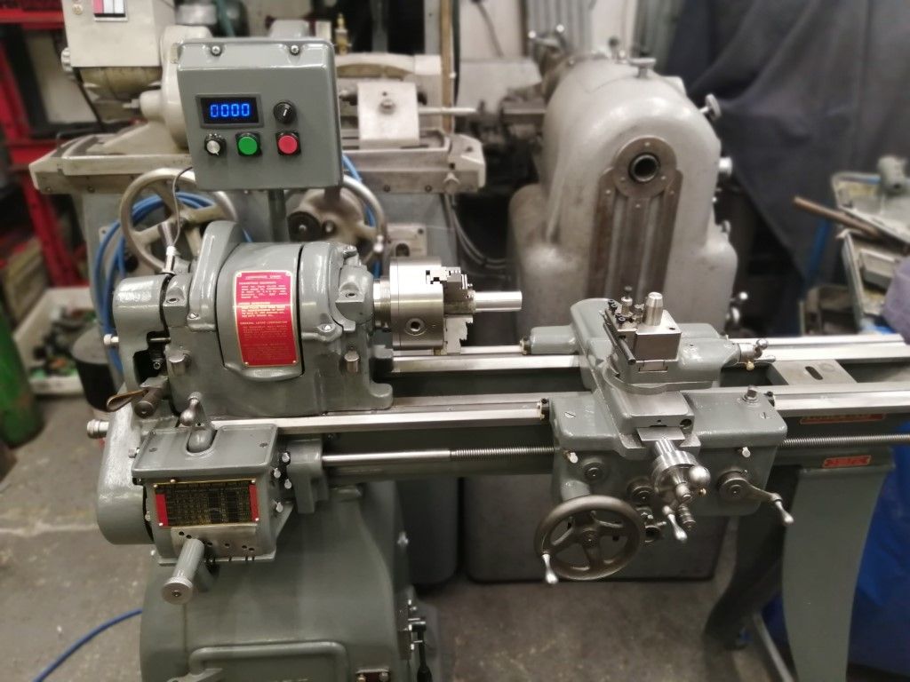

                                              I have the same setup as you Roger, I'm pretty sure. Yeah the later 2-tumbler box would be much easier to do.

                                                  Roger, I have some knurled screws that are 1/4" x 20 whitworth that would do nicely, they should fit OK, I will send some if you PM me with your address.

                                                    Ooh Pete, that looks like it should do. Are you trying to encourage me? smiley
                                                    Is there a post on speed control and large dials I should be looking at?

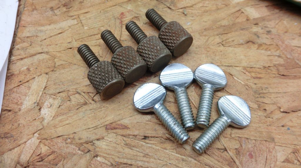

                                                      Super screws arrived in the post, big thanks to Chris Gunn and Mark Smith 20 for being so helpful and inspirational in their machine maintenance.
