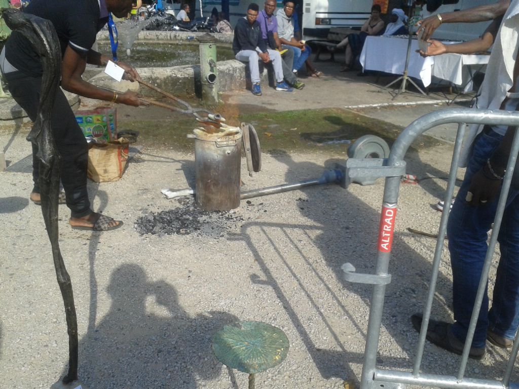

                                  Speedy Builder5
                                    @speedybuilder5
                                    this is the way to do it. As seen at our local fair in SW France. Note the safety gear.
                                    Not quite so clear in the picture, but it was an old 5 gallon drum with a hinged lid, some refectory clay pasted onto the insides, and a blower pipe stuck thro a hole in the side. This guy was melting copper and brass using charcoal as the fuel, a refectory pot and some more charcoal on top of that. He must have had a bigger system at home as he was selling "statues" which must have been 20lbs or more in weight.
