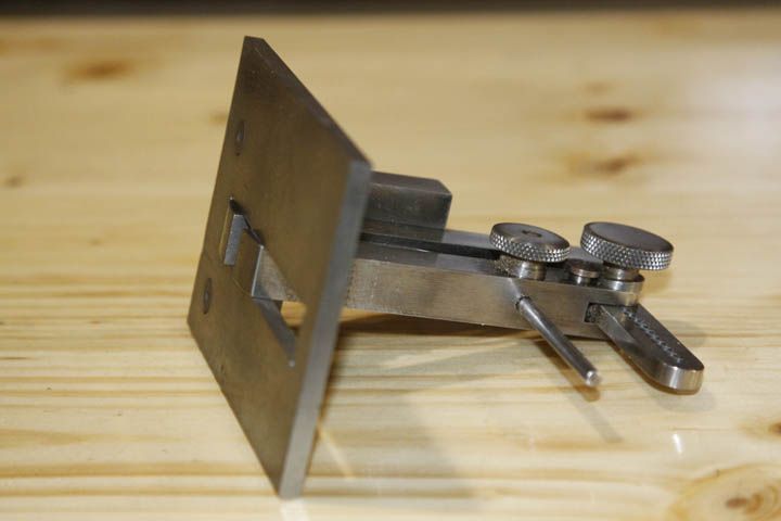

        I have some small parts in sheet brass that I need to hold for filing the edges. I've tried a search for small part holders but most of the hold parts for machining etc.
        Has anyone any suggestions?

              I made this small parts vice some years ago and is very useful.
              I believe it is a GH Thomas design and appeared in either ME or MEW magazine.
              Regards Barry

                          Many thanks for the interesting suggestions.By playing about I've discovered that the part is best in the flat, horizontal position making it possible to see the lines without straining either my eyes or my back. I've been holding the parts with my fingers but it's very hard work.
                          I'm coming round to the idea of something like a fretsaw table and using the files vertically.
                          I think I may be able to use the toolmakers clamp idea until I can get around to making something
                          Brian

                                  Many thanks for all your suggestions. The Eclipse hand vice suggestion rang a bell; I bought one at a car boot years ago and had forgotten all about it.
                                  I've had a play and it's perfect but I was quite taken by the miniature die filer and can feel a project coming on! (although I don't need any more)
