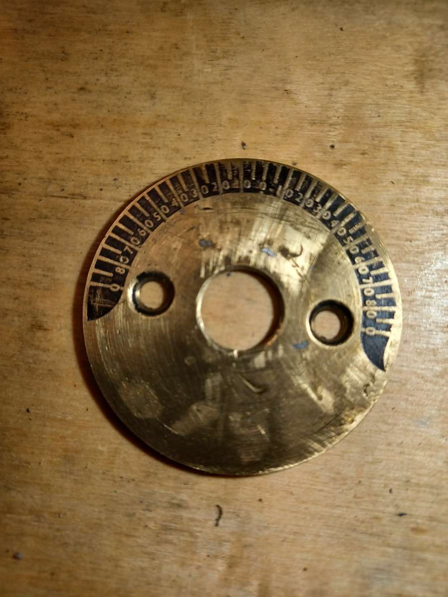

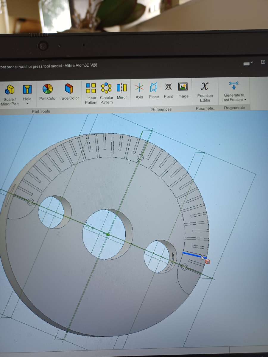

      Alibre Atom 3D text doesn’t seem to be installed on my version of soft ware but when someone who has had a look at my dilemma of not been able to draw numbers on a press tool to make an angle dial has added them to a model of the finished item model the option appears on my screen to show more options. Is there anything I can do to action the text option on my  pc.

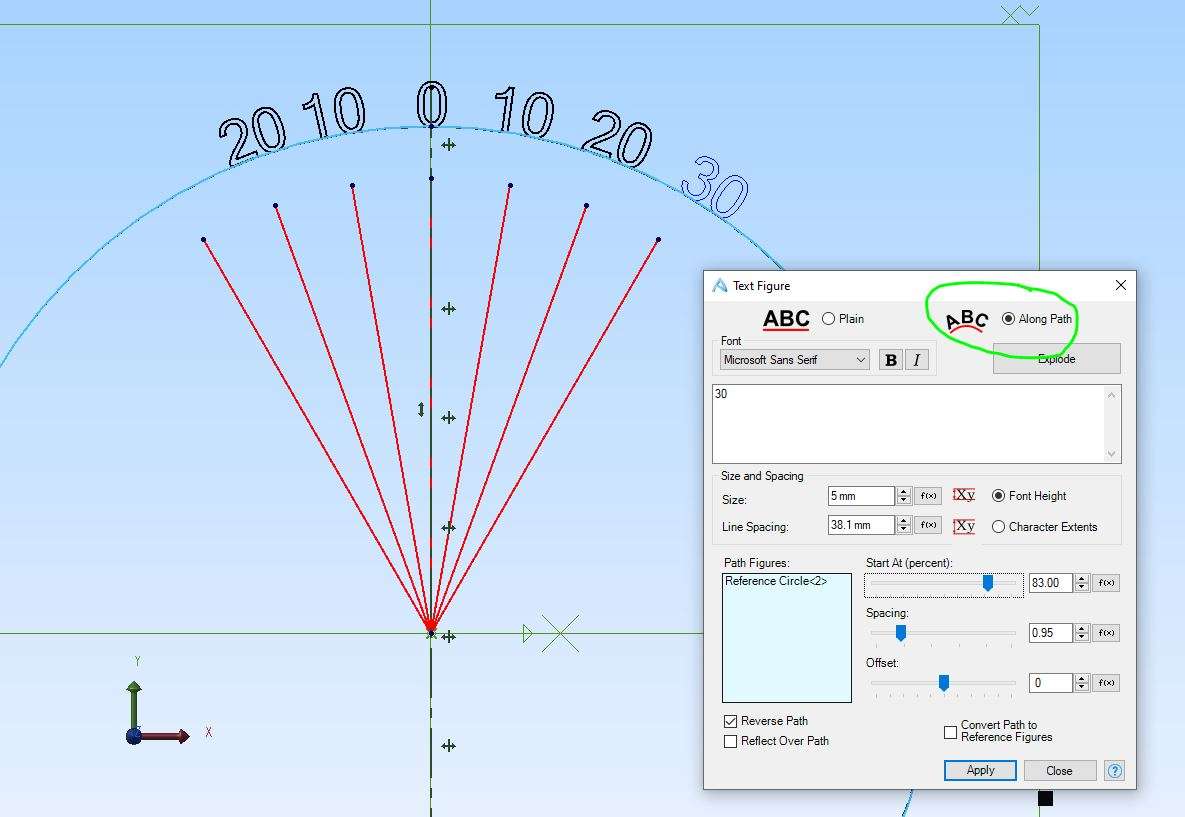

          Based on my Pro version you won’t be able to get the text to follow a curve if Atom has not been updated to the latest version in the last 18months or so. Prior to that I have individually set the angle of each number.
          Atom may have some functions stripped out.

            This are the pictures of press tool model and old dial
            20250814_083024
            20250807_154458
            David

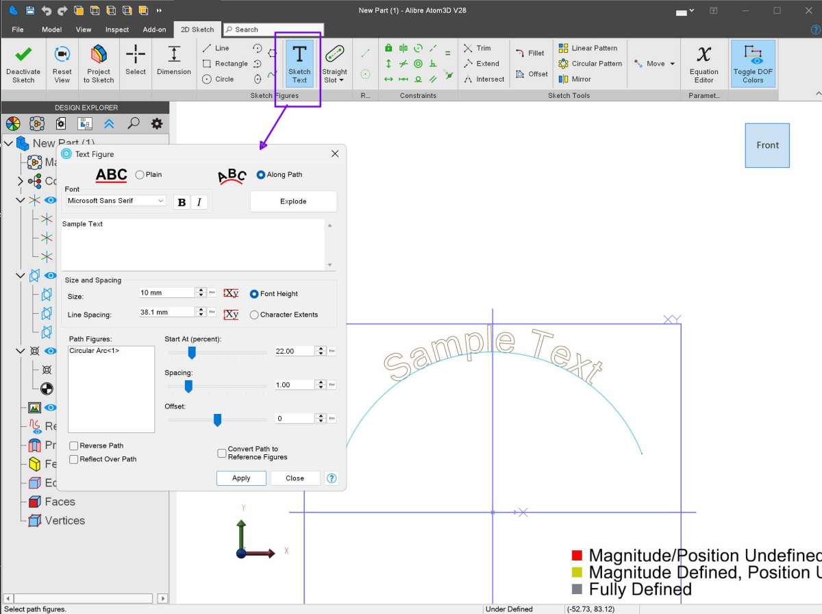

              Text is an option in 2D sketch – see below
              Atom Text
              The help file may also be of assistance
              https://help.alibre.com/articles/#!alibre-help-v28/sketching-2d-sketching-2d-sketch-figures-text-figures-creating-and-deleting-text-figures
              Once you have the text in a sketch, you can extrude boss or extrude cut it to form a 3D feature.

                maybe not obvious in David’s screen shot but click the button next to “along path” to get the dropdown with more options for placement
                path
                #812399
                David George 1
                  @davidgeorge1
                  Thanks Jason I hadn’t found that before. On my way again.
