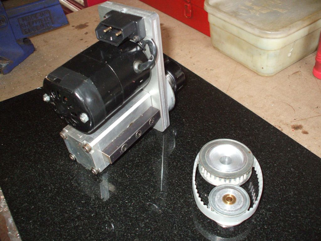

            Not Singer, but …….
            For what it's worth, this generic sewing machine motor that powers my toolpost grinder/drill is rated at 90w and the blurb that came with it claimed up to 10,000rpm! I've no way to check that, but it does whizz round at a considerable rate of knots at full chat.
            Toolpost spindle v3 rear view Toolpost spindle v3 front view

            #280911
            Andrew Moyes 1
              @andrewmoyes1
              The Potts toolpost spindle shown in my album has a sewing machine motor that runs at 9000 rpm on light load.
              Andrew M
