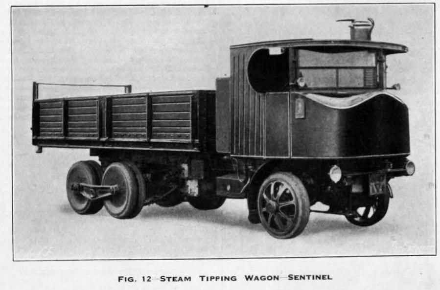

                      Not much in The Engineer, one piccy from 1929

                        Thank you all once again for your replies, the S6 is a much later model than the one forwarded by Ady. The suspension on this S6 will be under the chassis.

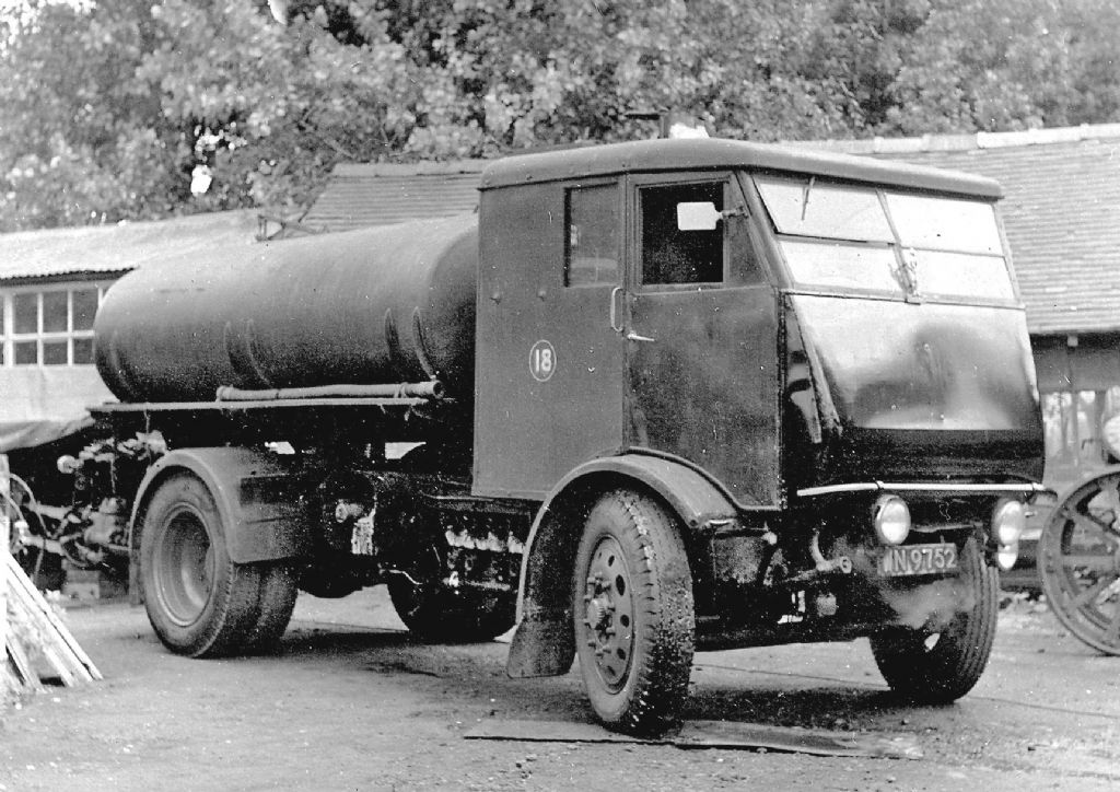

                                                    I thought I had this somewhere. Posted just for interest. The waggon in question in it's working guise as four wheeler.
                                                    Diane

                                                      Dear Diane the beast in question before export to Canada. The engine, gearbox and driven axle look to be in good order, the boiler is being rebuilt and the cab requires work. I will try and phone soon but some images of the rear axle and springing arrangement would be most helpful. Robert Butler
