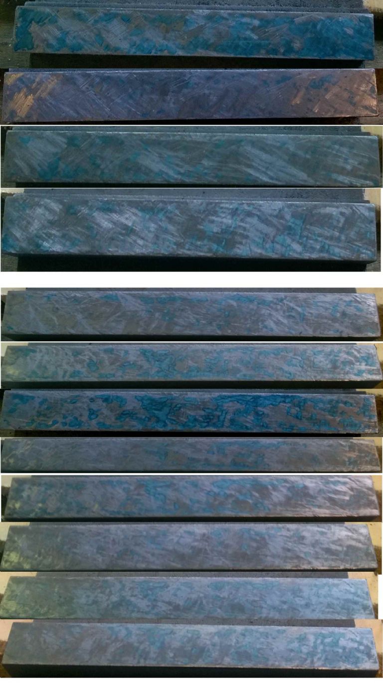

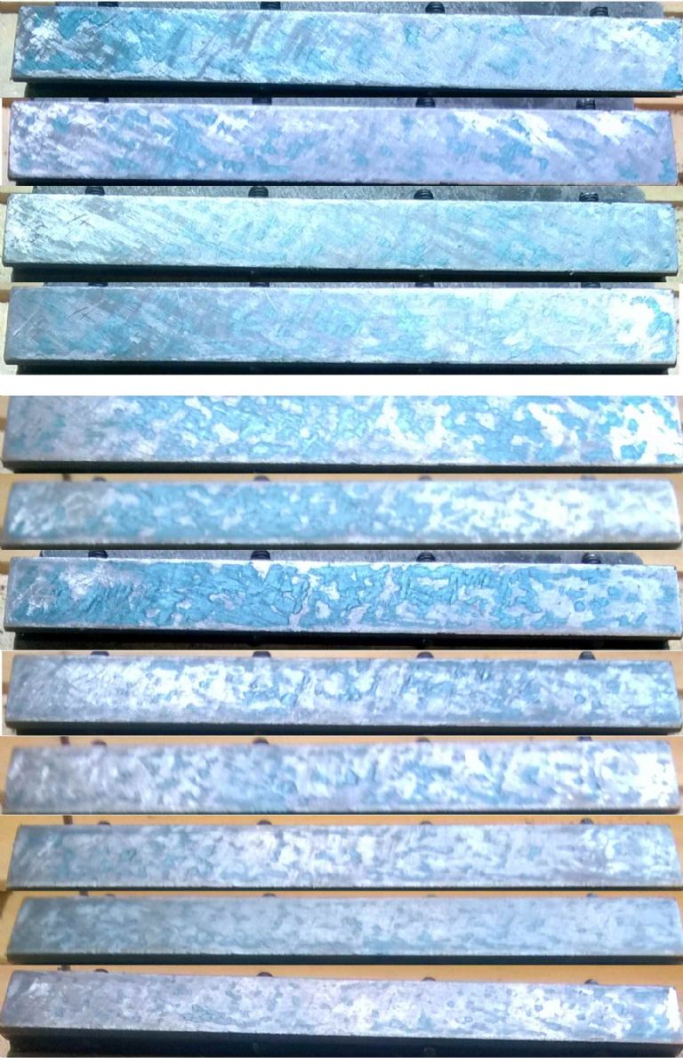

      So I set to. I've spent about 8 hours now on two bits of iron which are about 15 square cm each and I'm not entirely sure I'm making any progress.
      Having re-read some MEW forum posts and re-watched some you tube I changed things around this afternoon. The first thing I did was to switch to putting the blue on the table and not on the way. I liked this because it seems to give a more 3D effect which makes it easier to spot higher spots.
      I also ground the scraper into a mild arc and put a 80 slope on the end. The scraper arrived flat and square and I suspect that I've been scoring things badly with the edges and not taking off the right bits.
      Here are two 'time-lapsed' pictures of where i've got to today. i'd appreciate any helpful comments. The gap in the image is where I changed my approach.
      Non-Gib way
      Gib Way
      I *think* that I'm finally showing some progress. The last set of (8) images took about 45 mins to scrape and it's the first time I thought I might be making progress.
      Some of the ways on this little think quite clearly show milling marks, so it's not been made to the highest standard of precision and I do wonder if I'm wasting time on this…
      Iain

        Hopper
          @hopper
          Oh boy, can o' worms ahoy!
          You probably should sit down and read the book "Machine Tool Reconditioning" by Connelly. It is basically the scraper's Bible.
          There is more to it than mere contact area. You need to be sure that everything is staying flat and square as well. Usually one would start by knocking the burrs and high spots off everything with a dead smooth file and see if that helps.
          Then as far as scraping goes, one would most often start by scraping the fixed bed ways flat against a known flat surface plate, a small one that can be lifted on to the job. At the same time you have to make sure the ways you are scraping are aslo dead square to the vertical ways (z axis). Depending on the shape/set up of your mill, this might require a scraped square or at home you might use a good quality try square clamped to the way and run a dial indicator up and down it attached to the quill (which must be of course free of excess play).
          Then once you have the flat surfaces of the fixed ways flat and square in two directions, you might use a scraped prism to scrape the dovetails flat, and using a pair of rollers and a micrometer, parallel.
          Once you have that all sorted, then you are ready to blue up the fixed ways and scrape the moving ways on the table to match.
          It is a lot of work and as you are beginning to realize, of questionable worth on a cheap machine.
          You say you have the front of the table .1mm lower than the back, due to more metal at the back of the table. The cure for this might be to take a cut with a flycutter over the top surface of the table, after you have first made sure the fixed ways on the bed of the machine are not the cause of the problem. Proceed with caution, and measure everything several times before taking drastic action such as this.
          The lack of ability to hold true after tramming indicates something is loose somewhere. Maybe the column is not secure, or is too flimsy and is bending? Is the head the type that can be angled? If so, it may need pinning in the true position as they can tend to move under load. You cant really proceed with scraping until you have the z axis set right, as all ways need to match it.

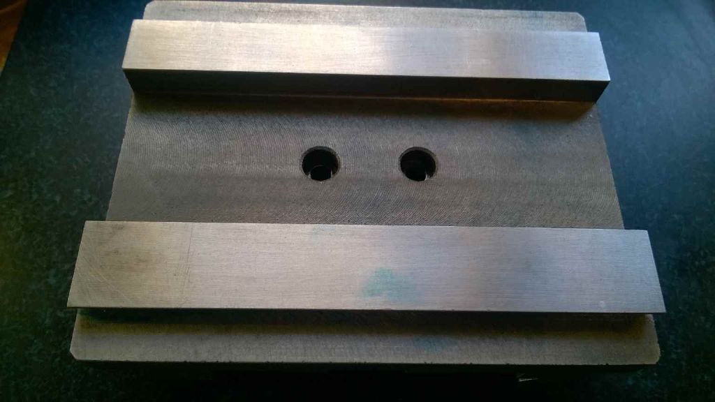

                To give you some idea of the ways, here is a photo of the lowest set of ways. To be clear. The way is NOT the smooth surface on top but the rather badly machined surface lower down in the dovetail.
                The way on the table is worse.
                Ian I like the idea of a grinder, it may work better for me than trying to fly cut the table as Neil has suggested.
                Micheal, the lead screws and nuts are fine – the binding happens with the lead screw out completely.
                Iain

                    Think should be treated scraping as some sort of oil retention rather than accuracy.
                    The only decent quality stuff is precision ground some with scraping some not.
                    Reason chasing the high spots around is because taking too much off. Seen this rooks of times and wish had a tenner for each that said only took 4 thou off. Its too easy to take 10 thou chunks time and time again that could take 80 thou off to put right, as Hopper says tip of the iceberg one flat surface still could be way out but flat!
