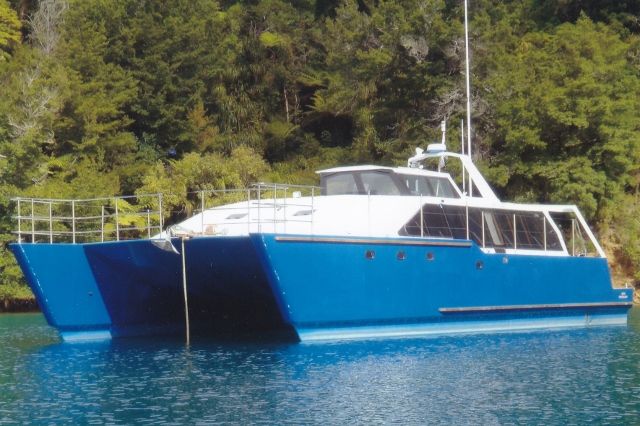

                                I think I used Delrin for the bushes on the rudders of my brother in law's 16 m/ 12 tonne catamaran. Built to Safe Ship Management survey standards, steering is hydraulic. Folie a Deux is a twin 150hp Volvo powered ocean cruising boat now based in Australia. The rudders did have a problem on the voyage from NZ to Fiji, over use of the steering caused the hydraulic fluid to over heat, so the sensitivity of the steering (electronically controlled with a Navman G pilot 3100 autopilot), I don't think it was tight bushes that put a load on the steering as the manual steering was quite free.

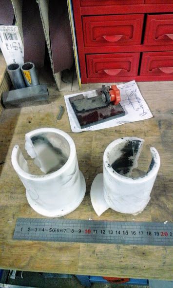

                                  Her's a photo of the old ones …
                                  Thank's again, everyone, for the interest.

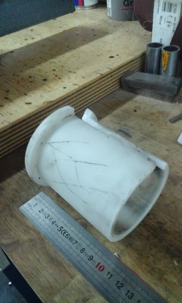

                                      Like always, a picture says it all. I wondered if you were talking about small bearing inserts like in a dinghy rudder gudgeon or as your picture shows, larger bushing for the rudder shaft. You did say bushes, but best to check.
                                      Hard to be certain, but the way the break has happened it looks like a form of Acetal. Delrin/Acetal tends to be quite hard and boney , if that is even a word (like bone), so it breaks cleaner than a lot of other plastics, which stretch and deform before they and break.

                                        For clarity, the physical damage to the old bushes (all of it), was the result of my father's efforts in extracting them. He has since told me that the top bush had no play at all; and the bottom one had about 1/4" (6mm), side to side.

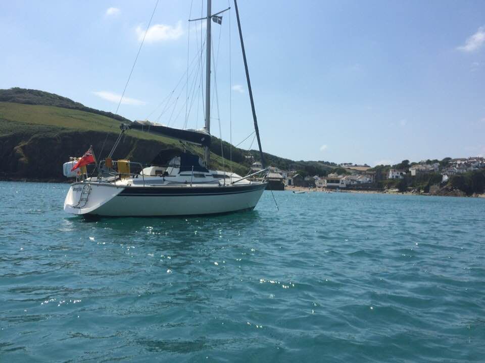

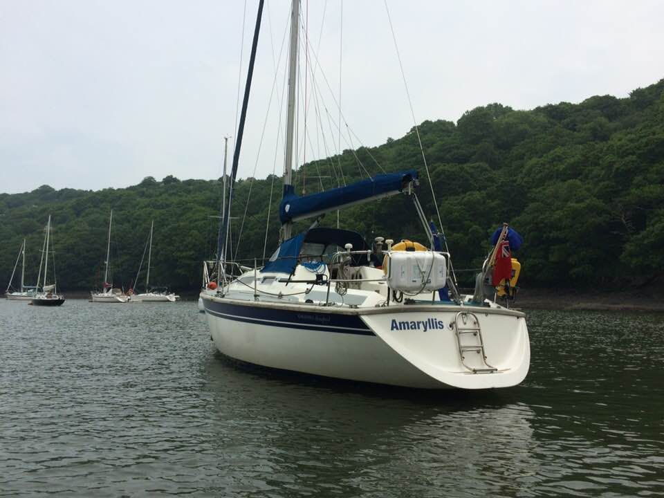

                                        For those who may be interested; here are a couple of pics, of said boat.
                                        Thank's again for your interest and help.

                                          Okay, you are into it. I'm sure the PE will do the job. Seeing the boat moored like that takes me back to my youth. No sailing anymore, but now I spend a lot less money as well.
                                          You mentioned about the top and bottom bearing/bushing of the rudder stock. Just keep in mind that the bottom one is the fulcrum and takes most of the load, so any slop down there is not good. If either is to be an interference fit, it should be that bottom one. The top one can handle a small amount of tolerance if needed to ease things up.
                                          Once made, let us know how it went. Just as a matter of interest, where is the boat moored in that photo?
                                          Craig.

                                                Yes Craig, another hobby that demands deep pockets.
                                                She's moored just up from the Bodinnick Ferry, at Fowey, in Cornwall.
                                                I think it's called Wiseman's Creek, or similar.
