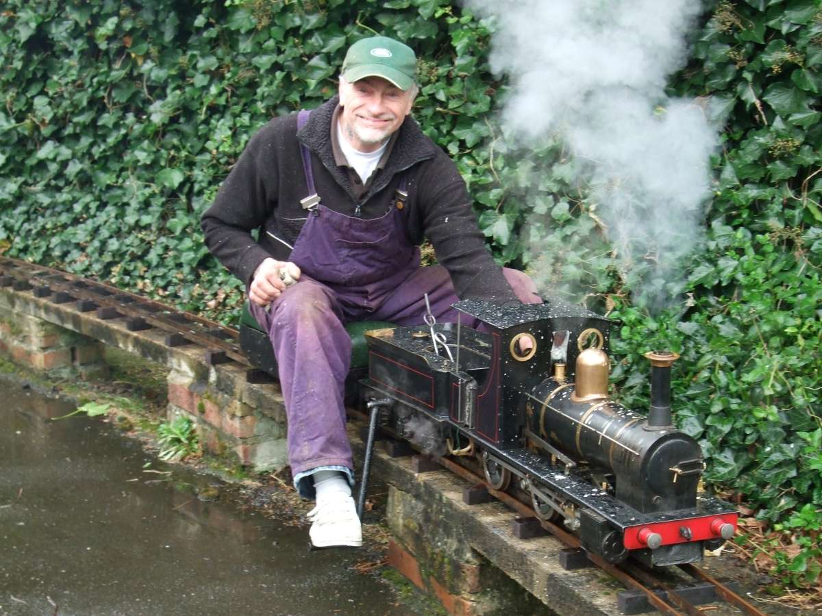

            It’s best that you don’t have a rigid set of leg irons. At my club generally we have bar onto we hang the leg irons and allow them to swing. This also allows to adjust the width of leg iron by putting collars on the bar. If you have a tender loco it is better and more comfortable to fit the leg irons on the tender rather than the driving skate.
