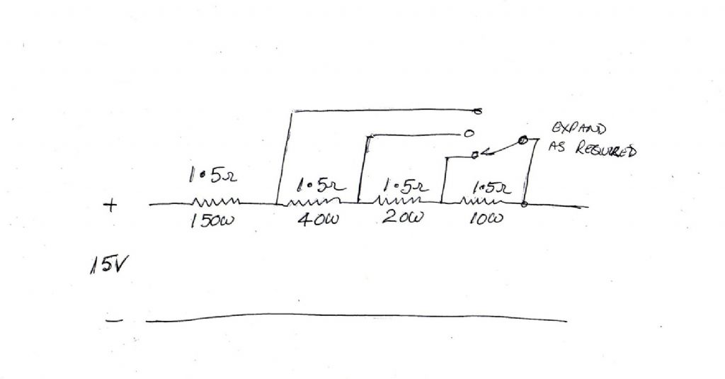

                  what kind of power supply do you have , a a simple transformer and rectifier
                  or a 13v regulated supply you would use with a CB for instance ?
                   how often do you need to adjust the current and how fine a control do you need
                  a simple solution could some thing like maplin’s 3-15v  25a power supply  RP10L
                  but at £99-99  I expect  several high power aluminium clad resistors from RS or Rapid
                  and a simple diy switch ( to switch  one or more resistors in series or parallel combination )
                  will be the  less expensive solution your looking for
                  another diy sollution is to build an electronic regulator to control the output from your existing
                  power supply
                  the simplest using a low power potentiometer to control one or more power transistors to
                  emulate a high power potentiometer
                  diagrams to follow

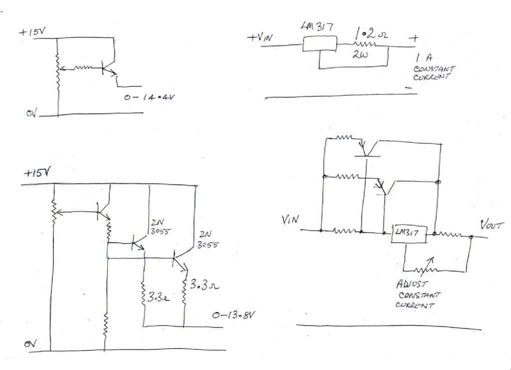

                  #56527
                  john swift 1
                    @johnswift1
                    Hi Ray
                    just some ideas to replace rheostat
                    more details required to calculate missing component values
                    does this help ?

                          I think i ‘d use the constant current circuit  to adjust the plating / anodising current

                        Thank you John, I’ll take all that on board.  I have sufficient knowledge of electronics but power supplies are a different kettle of fish.
                        My first priority is to get a power supply up and running to get going on whilst I build a 12 – 24v 30A variable voltage, variable current PS.
                        This small unit will supply up to about 6Amps and the rheostat, (variable resistor ex RS) will enable me to cope with small numbers of parts.
                        I have a transformer for the heavy power supply  and suitable caps. I just need to get 8 off 2n3055’s and 4 off rectifiers. these will come from RS.
                        The anodising current is not critical, a working figure is 150ma per sq inch.  Calculating the actual area to be anodised, especially when there are screw threads, is to say the least hit and miss. So within reason wire up the parts, connect PS and let them take what they want.  The thing to watch is letting it take too much. The current/time affects the size of the surface holes. Too small and the dye won’t go in and too big and the dye won’t stay in.  The actual current only needs to be near enough. I might actually use a bank of 1 ohm HSA type resistors wired in series parallel and switch them in to achieve a supply rising in 3A steps.
                        Thank you all for the help.  I’ll get it built in the next week and put up  a pic of the finished unit.

                                Ray
                                Would you be better off running a constant current supply instead of a constant voltage with dropper resistors? One way of arranging this is to have a number of -say- 1A current sources, you then switch in as many as you need to get the current desired. Or if you wanted to be digital have 1A,2A,4A, 8A sources seperatly switchable.
                                 For a 1A module you might use  something like a TIP120, output from the collector , emitter to -ve supply via 0.68 ohms  1W . BC184 or any other small NPN , emitter to negative supply, base to TIP120, collector to TIP120 base. A 4k7 from the last node to + supply completes the job. You can mount all TIP120’s without insulators on a common heatsink. Wire a switch between -ve supply and the TIP120 base to turn off that current source. Dirt cheap, simple and reliable.
                                As you might be warming a heatsink a fan might be good news. Nowadays instead of spending a fortune on finned ali extrusions,  people are using smaller ali heatsinks and blowing air over them ( the heatsink should get the airflow FROM the fan for best cooling as the flow is turbulent).
