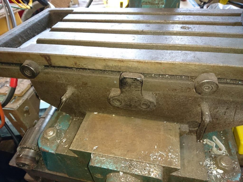

        I've just bought an old Rong-Fu RF-25 mill/drill which is in need of a bit of TLC.
        It has what appears to be two new belts but they are too long to set the right tension on the pulleys without fouling the housing. Can anyone tell me the right sizes for these belts please so that I can fit the right ones?
        The table stops are also missing completely and so there isn't one I can copy. Could someone kindly take a picture of one to set me on the right lines please, or if there are better designs point me to one I could copy please?
        Very many thanks
        Jon

            If you look at the seventh picture here:
            **LINK**
            You'll see one of the table stops. The front of the table has a dovetail slot cut into it so you'll need to make a pair of "nuts" to match the slot. The other parts are just a suitable size cap screw and a counter bored "button". I made new stops for my mill and think the buttons are somewhere between 3/4" and 7/8".
            My mill actually has a dovetail slot on the front of the table and a T slot on the side so I had to make two different types.

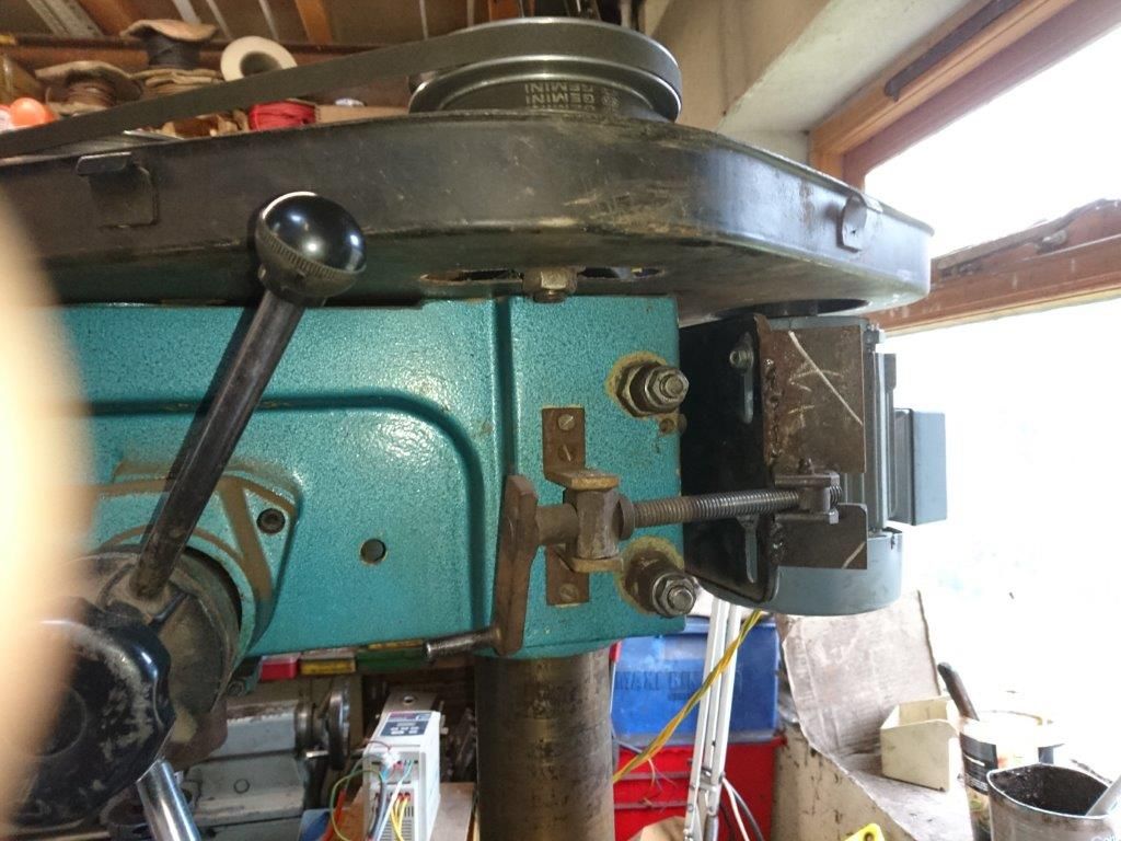

                            Hi again, the other modification I did to mine fairly early in its life was to fit a screw jack to the belt tensioner. At its simplest it's just a bit of all-thread from a bracket screwed to the RHS of the head casting to a pivot welded on the side of the motor mounting plate. The motor and its mounting plate swivel on two bolts on the LHS of the head casting. Originally there was a silly sliding peg and grubscrew affair to push the motor mounting plate backwards and tighten the belt.
                            Quite apart from this needing at least three hands to do, one of the main advantages of a belt driven machine is to be able to set the belt tension so the drive is firm enough to turn the cutter, drill etc, but if it all goes horribly wrong the belt slips rather than breaking things. Especially useful for drilling big holes! My experience with the peg and grubscrew arrangement it was originally fitted with was it was impossible to tighten the belt enough to drive properly – it's got a 1 hp motor and if you're drilling inch and a quarter holes you need the belt tight enough to transmit the torque of the motor. Otherwise you just keep stalling the spindle and chipping the edge off the drill.
                            If you're interested I'll show some photo's – it's a bit crude and made by a blacksmith (and an agricultural one at that!) but you'll get the idea. If I can work out how to upload piccy's…

                                    Assuming you let the arm carrying the middle idler pulley "float" i.e. rotate about the axis of the column, the tension in the two belts is nominally equal. So you just do up the belt tensioner to tighten both belts the same amount.
                                    I use mine mostly as a drilling machine, because it has a no 3 morse taper up the spout. It's a perfectly serviceable milling machine, but I haven't used it as such since the day I bought a Tom Senior vertical mill.
                                    By and large I use the mill/drill for drilling holes where you need the spindle running at less than 200 up to 800 rpm (drilling 10 mm dia up to say 25 mm or so). In these conditions the belt from the motor is used around a very small diameter pulley, whereas the others are around bigger sheaves. This means that the friction between the smallest pulley and the belt is what governs how much torque is actually transmitted to the belt drive. You need a fair bit of tension to get the belt to sit properly in the groove of the tiny pulley on the motor shaft.
                                    I've found my vsd allows me to do this speed variation without swapping belt positions. By using a VSD compatible motor (now there's a long story!) I get enough torque to do what I want to do and the belt stays put in one set of grooves. Yippee!
                                    At higher speeds the whole machine is over-designed anyway, so transmitting enough torque to drill say a 2 or 3 mm hole can pretty much be done without any significant tension in the belts at all.
                                    I tried uploading some piccy's – haven't worked out how to do it yet. I bet there are some instructions here somewhere in the forums.
                                    Simon

                                      Here's a picture of the screw operated belt tensioner. The longer column clamp bolts and packers (stacked nuts) on the right of the head stock are simply so you can get a spanner onto the clamp bolts without amputating your knuckles.

                                        Here is a close up of the table stop parts in situ

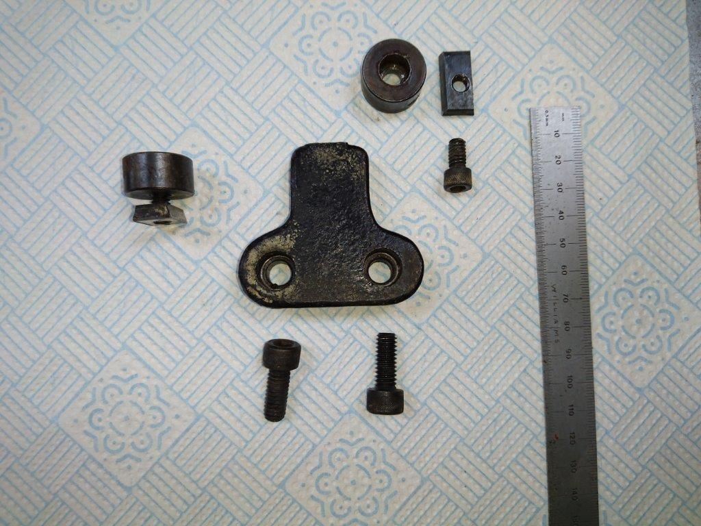

                                          And this is what the individual parts look like off the mill

                                            Simon,
                                            Thank you for the pictures – very much appreciated.

                                                  As a Post Script, here are the table stops I made. Decided to add a short spigot to engage with the outside of the dovetail slot to keep them central…
