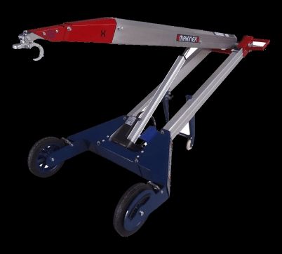

                There are also things called mini lifter stackers for shifting stuff about

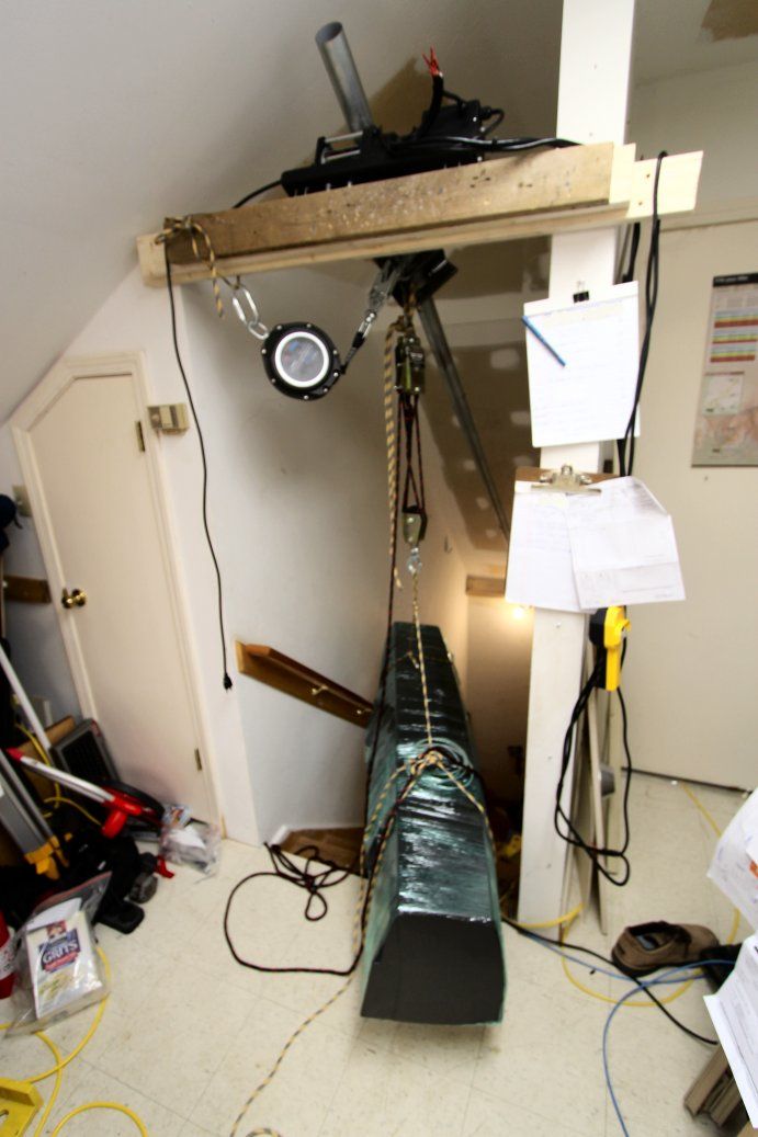

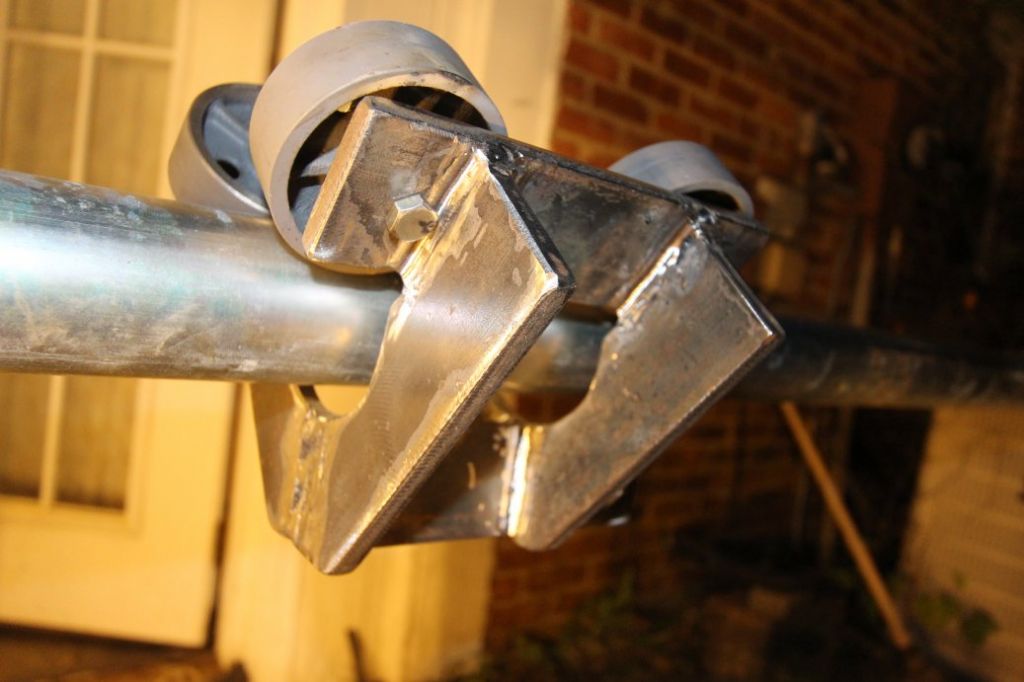

                  My office is on the 2nd floor of my house, and with the virus thing going around, nobody is willing to come over and give a hand to carry equipment up and down the stairs.
                  I purchased new equipment this year, and had to take down the old equipment, and it was beyond what I could do.

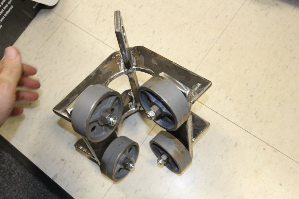

                  I built a hoist using a 2.5" piece of EMT conduit (IMC would have been better but they were out of that).
                  I made a trolley, and bought a 120V winch.
                  I did not want to get fancy until I could prove it worked, and thus the rough arrangement so far.
                  It actually works every well, and I moved 5 pieces of equipment at 250 lbs each easily by myself up and down the stairs.
                  Next on my list is a mini-lift truck that is light enough to be folded down and put into the minivan.
                  It will be manually powered.
                  I will post a few photos in a minute.
                  Having built this hoist, I think I could build a mini-lift using similar construction.
                  Edited By PatJ on 12/11/2020 02:01:52
                  Edited By PatJ on 12/11/2020 02:03:11

                    For a mini-lift truck, I think I would build it where I can add weights to the back (perhaps a container with water), in case I cannot have feet protruding out forward, and then have feet with wheels that can be slid out forward, if the event the back weights were not being used.
                    I would want it as light as possible, and so that would probably be a monopole with 2.5" IMC conduit.
                    And I would have it fold down, and also disassemble into at least two pieces.

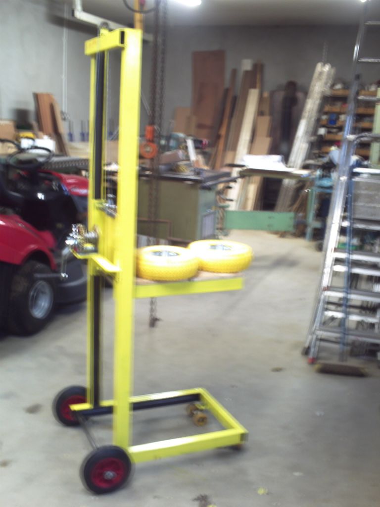

                          A few years ago, I made a lifting barrow based on a design seen in MEW.
                          There are photos of it in my album, it,s nothing fancy but it works, can lift from ground level to lathe or drill table height. Chucks or heavy workpieces are no problem. Can be used as an extra table if required, was cheap to build and great for loading/unloading stuff from cars/vans..
                          Would be happy to send you more photos or details if required.
                          This is a back and a toe saver, believe me !smiley

                                Posted by larry phelan 1 on 12/11/2020 09:32:39:
                                Hi Ady1
                                Looks pretty good to me
                                Once on board you can drop the load to the floor and move it about, only lifting it up for the initial and final part of the operation

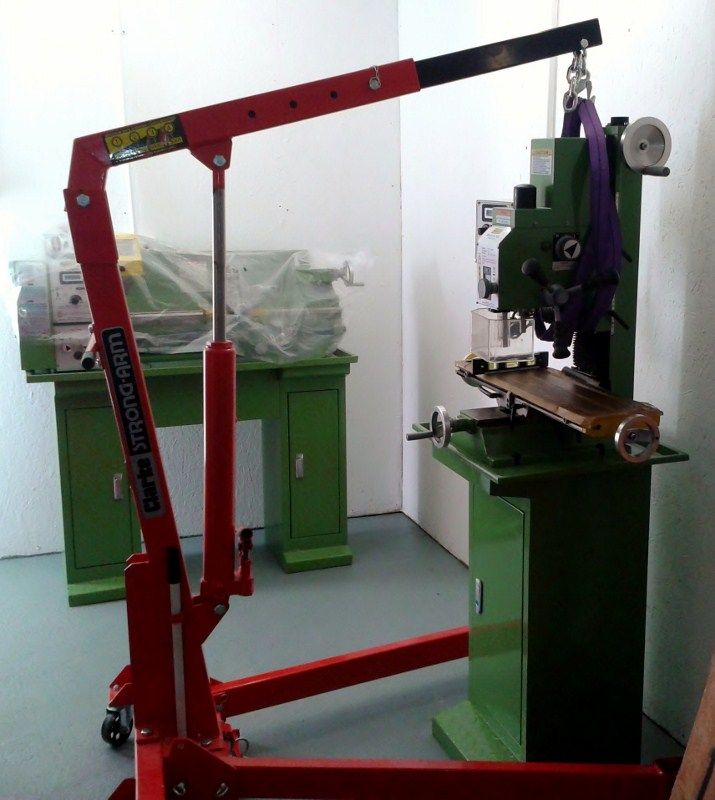

                                                  When I converted my garage to a 'Hobby shop' I'd bought a 1 ton engine hoist from M/Mart ( usual disclaimer applies ) in preparation for lifting lathe & mill, well worth it, trouble is I've now filled the 'Hobby shop' & having stacked the hoist in a corner I doubt if I could get it out now, & if I could I doubt I would have the room to manouvre it for use should I move… conundrum ?
                                                  George.
                                                  Edited By mechman48 on 13/11/2020 14:07:10

                                                    That's what a cutting torch and welder are for George, just snip the legs off and weld em back on after getting the hoist free! smiley
