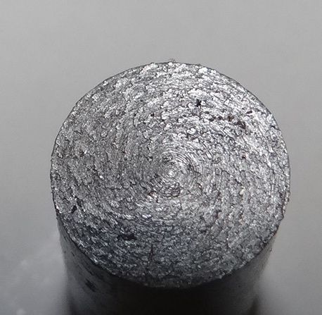

        In a recent thread Curtis Rutter asked for help with a facing cut taken with his new lathe. Reading the thread It struck me that many beginners struggle with finish, not being clear if they have a faulty lathe, blunt tool, wrong speed, wrong type of tool or a difficult material.
        I wonder if anyone else would care to contribute photographs of poor cuts either with an explanation of the cause or asking for one.
        Here's my offering. It's a powered facing cut on a 3/8" diameter BMS rod taken with an 8mm 'Form No2' HSS knife.

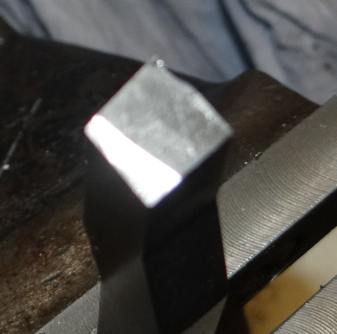

        Yuk! This was caused by a badly ground tool rubbing after the point has made the cut. You can see a spiral of smudged metal where the surface of the rod has been smeared by the HSS tool.
        Sorry about the poor focus, but you can make out at least four facets where a wobbly Duffer messed up sharpening the tool on his grinder. There isn't enough relief across the whole of the tool face.
        This was partly due to lack of practice but mostly because I was in a hurry. (Strange how often there's not enough time to do a job properly in the first place when there's no shortage of time to fix it later.)
        Anyone else got examples they aren't too embarrassed to share?

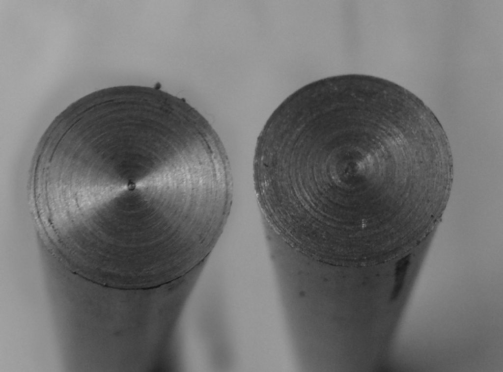

                  This example is 'quite interesting'.
                  Courtesy of GIMP I combined two photos into one. As if by magic the picture shows opposite ends of the same BMS rod.
                  The ends were faced one after the other by the same sharp point 'Form 2' HSS tool. Both were cut at 500rpm with no lubricant.
                  Hardly exhibition standard but the finish of the left-hand face is markedly better than that achieved on the right. The difference between the two cuts is that the right-hand was faced with the tool exactly on centre height whilst the left-hand end was faced with the tool about 0.3mm lower.
                  I converted the picture to black and white because artificial light fooled my camera. In colour the BMS looks exactly like brass!
