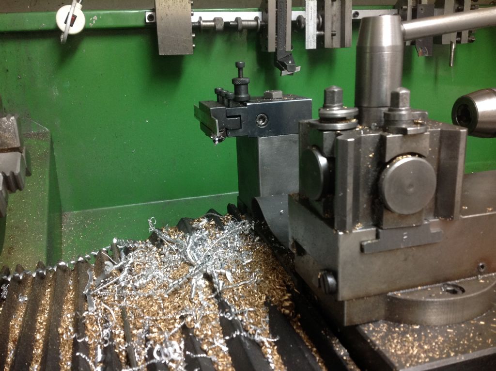

                    I have a rear tool post made from a kit & it works fine after a couple of mods; ( see my album; rear tool post ). I also have the x slide tool post wound back along the compound slide to allow more support under the tool point ( rigidity )…It also helps part off under power feed quite easily as it allows the parting tool to locate nearer the centre of the cross slide.
                    George.
                    Edited By mechman48 on 23/07/2018 14:03:32

                            # My Dickson (genuine Bison copy) is dismantled and cleaned a couple of times a year. The first time i did this was prolly after 10 years of ownership – could not believe the crap in there…
                            # The tool post has a location peg/hole in the top slide.
                            # i have learnt to have the part off tool over the cross slide – this does help.
                            # Cross slide is a t slot type with longer dovetails than the stock "Yankee style". It's not on the top of my list of Things To Do, but maybe, one day, i'll get around to making a rear tool post. In the meantime………..
