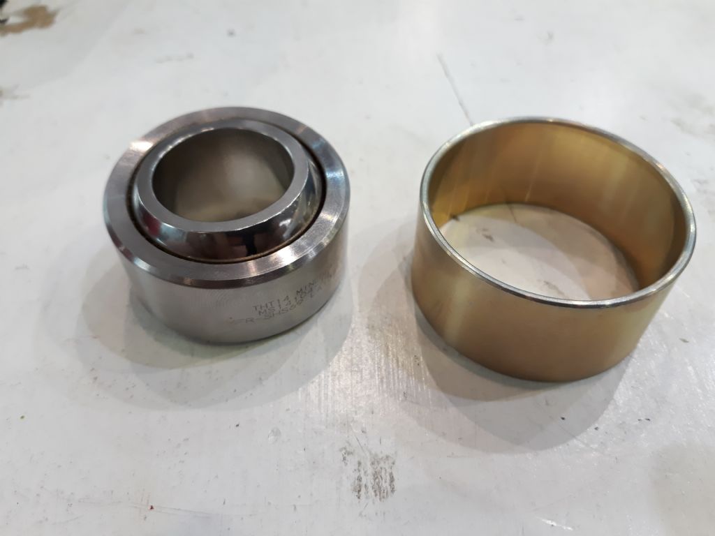

                  The bush is actually a sleeve into which a spherical plain bearing is inserted and staked (similar to a hydraulic ram rod end bearing) That's the reason the bush is aluminium as it needs to be cold worked and form a lip.
                  The process calls for the sleeve to be press fit into the fitting. The sleeve is then to be reamed to the diameter of the spherical plain bearing. The bearing is inserted into the sleeve and staked to form "swage".

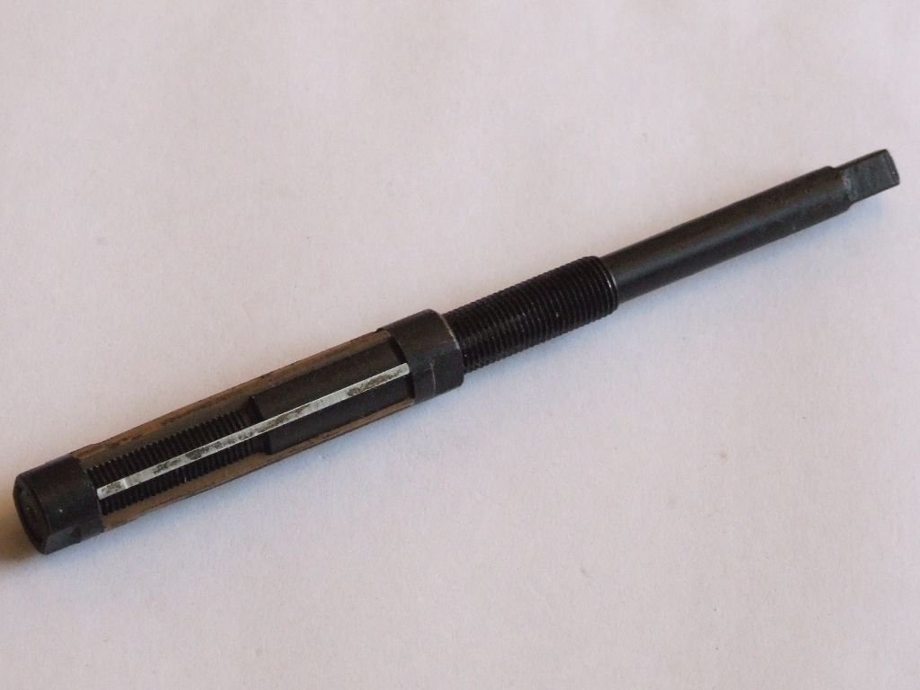

                      I'm not sure what is meant by an adjustable hand reamer? Something like this:
                      This type of adjustable reamer is intended to take out minimal material per cut, mainly for repairs or fitting oversize pins in the field. They're not easy to use or particularly precise, and as Hopper says the hole in question is really too short.

                        Yes that's the type of reamer I have, it's no good for this application.

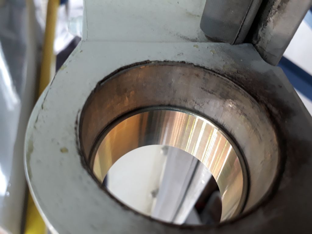

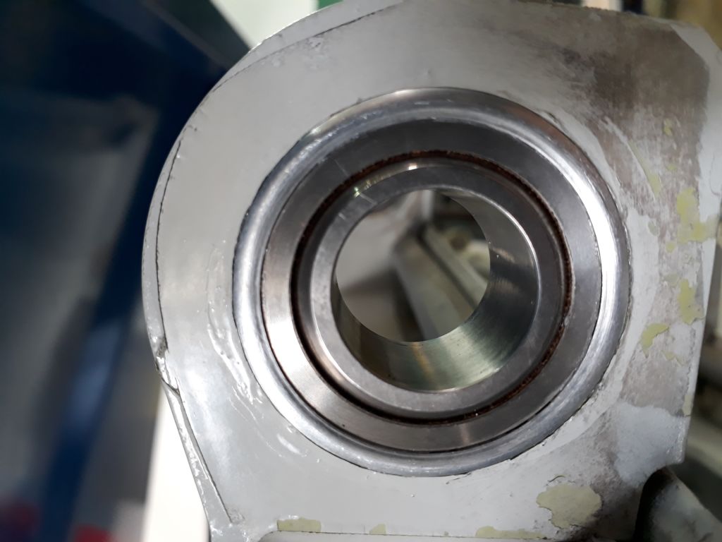

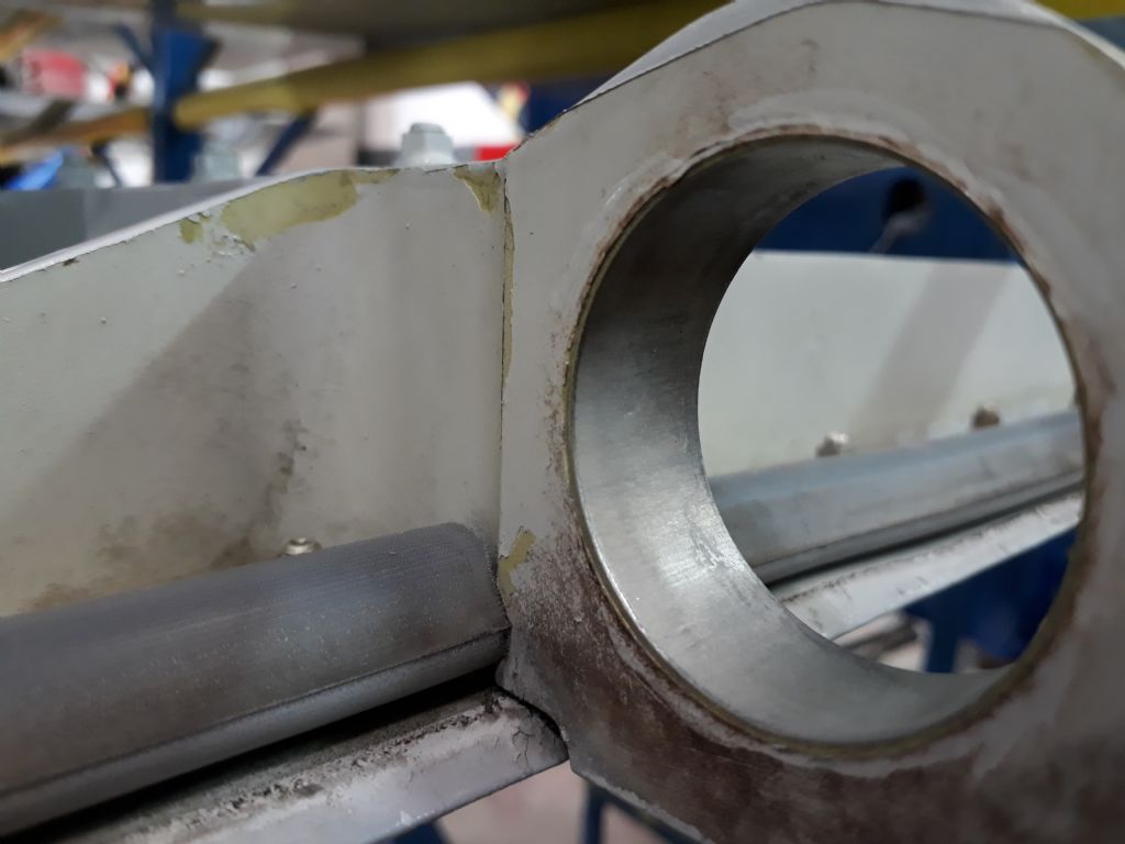

                        Incidentally the application is for an aircraft component. I have been replacing and staking these bearings and sleeves for years – boring the sleeve on the lathe and then installing on the component. Unfortunately an audit found that I'm not following closely the process as specified in the relevant manual, so as the process states that the sleeve should be reamed in situ and then staked, I have to adapt my method…the problem is reaming the damn sleeve with a reamer is proving next to impossible unless I'm missing something!
                        This is what the sleeve and bearing looks like
                        The fitting after removal of the old worn bearing
                        This is the sleeve partially installed into the fitting. The sleeve needs to be fully driven in and then reamed to size.
                        The finished installed bearing with the staked sleeve retaining the bearing

                          You will have to make a fixture to hold the reamer dead straight, and buy a proper spiral fluted reamer. There is not much of a chamfer on the hole to keep the bush in place after staking. Does the reamed bush get inspected before fitting the bearing? Could you get away with lapping the bush? I have fitted lots of these type and the variation where the bearing fits directly in the hole and has a grooved edge which is staked. Roller staking was used.
                          You may be able to get away with careful measuring and only ending up with about 0.05mm undersize, then use the reamer to rub out the rest.
