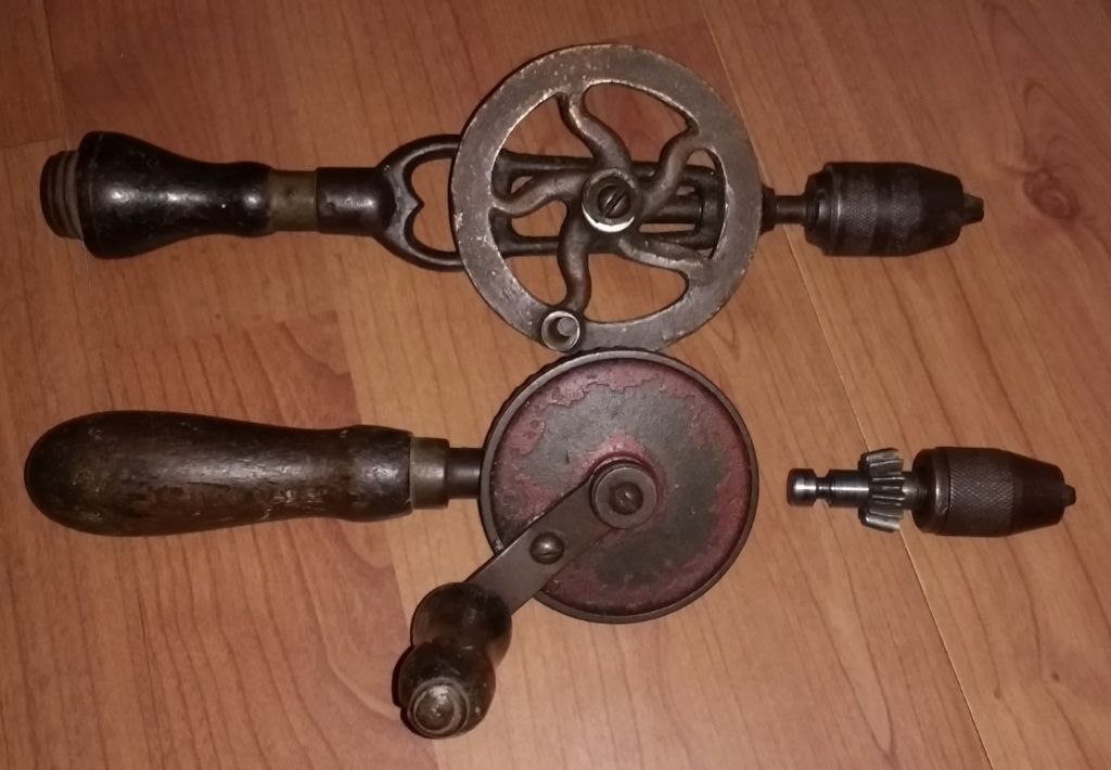

      I bought these two old hand drills for £1 the pair a few years back with the intention of refurbishing them (or butchering them for small engine flywheels!) but never got round to it. While thinking about making a piloted tap holder today it occurred to me that these little chucks could probably be re-purposed and would certainly be better than trying to adapt the awful holders and wrenches supplied with the tap and die set I bought a month ago. I've already made a tail-stock die-holder so I'm hoping this conversion will allow me to throw away the wrenches.
      The chuck I've removed has a 10mm shank and will hold taps up to 6mm. I'm thinking of turning away the teeth to leave a plain shank then brazing it into a boss fitted with a tommy bar. I don't fancy turning a morse taper so I'll just make the boss long enough to slide along a parallel bar held in the tailstock chuck like the die-holder I made.
      But if anyone has a better idea Id be happy to hear it smiley
      I guess the one I've dismantled is from the 1960's but I wonder how old the other one is? Shame the threaded end of the handle is missing, I'm guessing it was used for holding bits?

                    Hopper, I'm not sure about the older one – it all has the look and feel of 19th C except the chuck, although the hand-wheel (or whatever it's called) is very crudely cast. I'm loathe to dismantle that one, I need to find someone who can make a new wooden top for it.
                    EDIT: I take that back – it's definitely 'No. 1 (early frame)', hollow-head version from 1880!
                    http://oldtoolheaven.com/hand_drills/drill1.htm
                    Edited By PaulR on 15/01/2017 08:13:47

                      The top one is an American 'Millers Falls' item from 1878 catalogue…..

                            Nice Millers Falls drill missing the end cover for the drill compartment, handle is rosewood as would have breen the small turning handle which would have the makers marks and number. If the chuck has the MF marks will sell quite well as a spare part.The small springs inside the chuck are like hens teeth to find! I scour old drills at car boots just for the chuck springs!

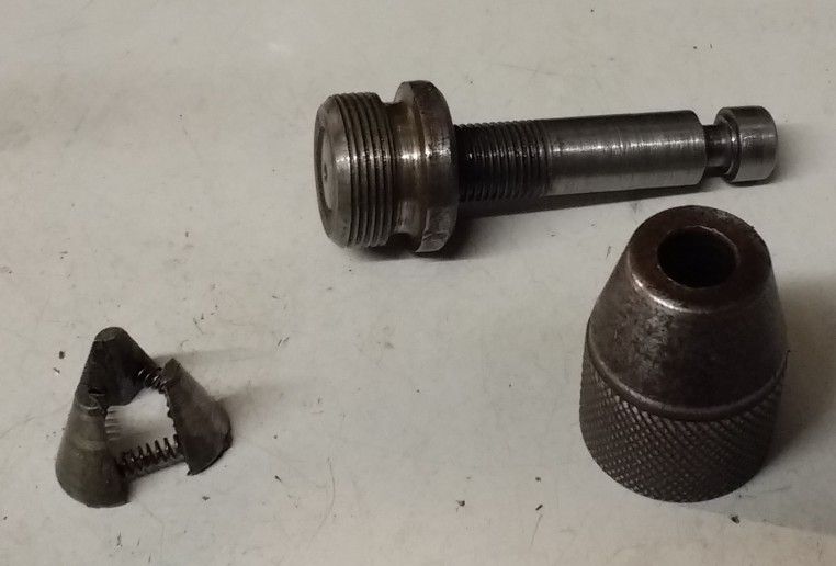

                              Martin: Having never dismantled a chuck before I didn't realise there were three separate springs lurking within – even on this later hand drill (I haven't dismantled the MF one yet). I can see how they get lost so easily!

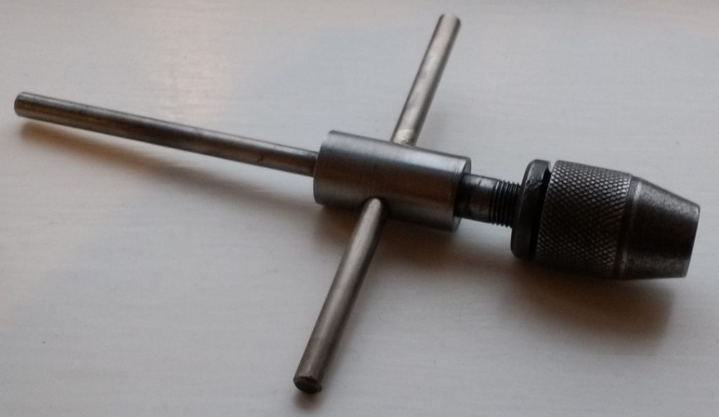

                              Anyway, I've completed the 'conversion', except for making a simple elongated bush to go in the tail-stock…
                              The chuck parts after turning away the gear teeth:
                              Hand drill chuck parts

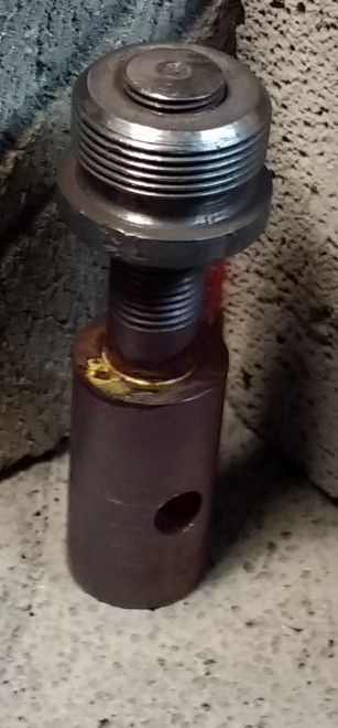

                              The parts required to convert it (the tommy bar is also re-purposed material… ground steel from a circa 2005 printer, you might notice some figures on it!!), the boss was a very rusty lump of steel that needed a purpose in life:
                              Parts for piloted tap wrench
                              Soldering the chuck to the boss (I hate that weedy wire type silver solder, I always make a mess with it but I've got a yard I have to use up wink) :
                              Soldering chuck/boss
                              The pretty much finished item:
                              Piloted wrench

                                  Re the little springs holding the chuck jaws apart. Last time I needed some the internal spring out of an aerosol can did the deed. For the larger, 1/2", chucks sometimes the spring out of a retractable type ball point pen will do. Seem to be different sizes of these, I got lucky with one smaller in diameter than most.
