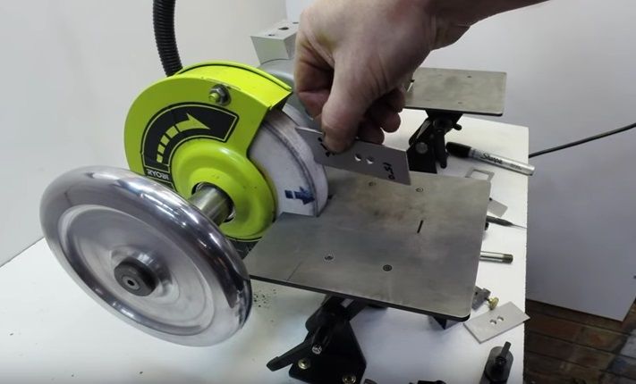

      grinder brake wheelWhat kind of tool or method would be best to make a radius on something like this please?

          Aren't you already creating a radius on the plate with the grinding wheel dia.? If I've got the wrong end of your question then you could use a boring head set up on the mill with the cutter set to the required radius, or even a fly cutter, also maybe a rota broach if you can borrow one of the correct diameter.

            a) mark it out accurately and saw / grind/ file to the middle of the marked line. To mark out, pointed dividers set to radius with a vernier or digital caliper will be quite accurate. locate one point of dividers in a centre punch divot and scribe your line. To help see the line better, colour your plate with permanent marker or marking out fluid or engineers' blue prior to scribing. Also, when approaching the line in final filing, use 10X optical magnifier of some kind.
            b) send a DXF file for it to your local wire edm house, arrange money transfer, and wait for the postman
            Good luck JD

              I meant the brake wheel on the end of the grinder.
              I don't have a mill as yet. Have a good lathe though.

                You could try a form tool but sounds hard work.
                I have tackled this sort of job by creating a spreadsheet of feeds to form a semi-circular arc from the circle equation and used the handwheels and a lashed up DRO using a digital caliper for the longitudinal axis. That works fine – gives you a stepped approximation to the curve that you file to a smooth shape afterwards.  I can give you some further information on doing this if you want.
                Nowadays I'd just give the problem to my CNC…

                  If the radius matches a standard woodworking TCT router ball bearing bit you could do both sides then finish with files..
                  10mins in here :
                  #280340
                    As John H says work out a few co ordinates at regular intervals which will give you the basic shape then blend further by eye and finish with a file.

                          Have a look at this **LINK**
                          its for a ball end but looks like it could be modified to make the radius on the handle.
                          You say you dont have a mill but if you have a drill press you might be able to drill a tapered hole or hold the taper bit in the chuck/collet on the lathe and clamp the workpiece to the toolpost.

                            Instead of calculating co-ordinates just use a fixed template (use your tailstock to mount it, it can be a drawing on card!) and a wire bent pointer from the tool-holder,

                                This is part of an email that Gary from eccentric engineering kindly sent me.
                                The brake wheel is just a large diameter aluminium disc cut from a piece of bar, I rounded the circumference on it with a radius form tool.
                                The rest of making it etc I am comfortable with doing.

                                  As the actual radius is largely cosmetic, I'd form the curves by hand with a graver and my GHT hand turning rest.

                                            Easiest way for a beginner to get the job done with limited machinery might be to set the aluminium disc up in the lathe, probably mounted on a rough mandrel made from a bolt and nut, then by setting the top slide to progressively different angles, go around and machine a series of small flats on the OD approximating the shape you want. Start by setting the topslide to 45 degrees and make a large chamfer across half the OD surface, then move the top slide around to 30 degrees and make another smaller chamfer, then 15 degrees and repeat. Then move the topslide around to the the other side of the job and repeat teh process. Once you have a nice series of flats approximating the radius you want, you can finish the job off with a file while the job is spinning. It will help to make a rough radius gauge by drawing up and cutting out a piece of cardboard or plastic ice cream container etc etc just to make a reference to work to.

                                                This is what the guy from eccentric means by a form tool, it is a piece of metal thet is ground or cut to the negative of teh shape you want to form. If small they can be ground from an HSS toolbit, if large as in this case then better to use gauge plate also known as ground glat stock.
                                                To do a half round drill or bore a hole in your gauge plate, saw inhalf across the centre line of teh hole, use a dremel to put relief on teh underside of teh cutting edge then harden and temper.
                                                As your rounded edge is quite wide and the job of a large dia you would probably be better off making the tool a quater circle and then when one side is done reverse the work in the lathe and do the other side. Still going to be quite a wide cut so you will need a reasonably sized lathe.
                                                If you are not happy grinding a tool then I think RDG do radius forming tool bits ready ground or as suggested above a rounding over router cutter can be used.
                                                You probably don't really need to have as rounded an edge as the one in the photo, just turn it like a disk flywheel and round off the corners to say 3mm radius so you don't rip up your hands anymore than needed.

                                                  With a system like the Acute grinder there's quite a lot of tool adjustments to do as you sharpen, e.g. Going from one tooth of a cutter to the next. A bit dodgy doing this when the wheel is rotating, but on my Elu grinder it takes easily 2 minutes to come to a stop after switching off. So nice to be able to brake the wheel quickly.
                                                  Using a form tool of any width on large diameter aluminium would be quite an adventure, and this is a one off non critical job. I think the suggestion of using a number of chamfer cuts using the top slide to approximate the curve with straight lines, then filing to a smooth curve, is probably the quickest and easiest.
                                                    Going with this I think.
