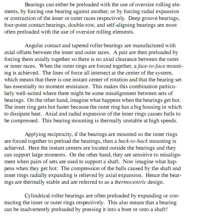

                Anyway some years ago I wanted some specific information on bearings and came across a pdf by MIT as usual it is in no way complete and refers to various standards that most people will have problems getting their hands on. It does mention why bearings tend to tighten when they warm up which they must do in realistic machine tools except probably certain grinders etc that use spring derived preload. There are also the strange aspect of plain bearing that have been known to not wear out. An area that is much more clearly understood now. That goes back a very long time.
                I still have it about. An extract.
                It's still about and I would add if only some of it could be so simple. Some will probably disagree on that. A google link unfortunately.
                **LINK**

                  Having seen the correct drawing for the spindle it is very similar to the one on the mill with the heating seal, the contact point of the seal had worn a flat and increased the contact area thus increase in temperature. just thought it is cheaper to investigate the seal to see if it is increasing in temperature at the contact point. can you get the thermometer on to the seal in that area.
