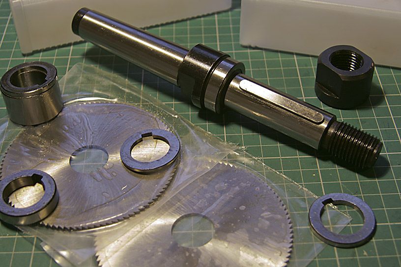

      I recently purchased a milling arbor having a 22mm shaft. As it happens, it was necessary to purchase the slitting saws from a different supplier.
      As one can plainly see in the photo, the shaft of the milling arbor is keyed and the slitting saws have completely round (keyless) holes. Hmmmmm.
      I have already tried to remove said key by 'gentle' pursuasion with a pair of large pliers, but it is seems to be quite firmly seated.
      The question then is as follows. Is my best solution to simply grab rotary tool and file and cut keyways in the slitting saws or (alternately) is there some special trick that someone can share with me to prise that extended key from the shaft of the milling arbor when I wish to use the slitting saws.

          Gentle heating, in the domestic oven, might loosen the key.
          #218226
          Gordon W
            @gordonw
            I would hazard a guess that the key has a drop of glue on it, gentle heat might loosen it. Standard way is drill and tap the key in a couple of places and jack it out.

              I'd try Michael & Gordon's approach and leave the keyway reusable – but of course you could also simply (and carefully) turn the key off.

                      Hold the key along its whole length by gripping in the top of your mill vice, it will grip better than pliers and not damage the key. Pull the taper or give a gentle tap with a softblow hammer.

                        If all that fails drill and tap and ease it off by screwing the screw in.

                              I have seen arguments both for and against keys in slitting saws. The view of some people is that if no key is used then in the event of the saw being grabbed it will slip on the arbor so will not be destroyed. It does assume manual feed rather than power feed so operator response is rapid. I have no view to push either way regarding key or not but thought I would let you know the use of a key with slitting saws is debatable.

                                    Hi Ignatz, in my experience it is quite common for this type of key to be tight in the key way and I doubt that it will be glued in. A simple way to remove it, is to hold the shaft in a vice with suitable soft jaws to stop it being damaged and using a small cold chisel, gently tap the rounded end of the key upwards. You will need to dig the chisel into the key slightly and the key will need dressing afterwards and you must watch that you do not damage the shaft or threaded portion in the process. This method will be frowned upon by many people, but it does work and you can then drill and tap the key, if you wish, with a little more ease for the next time you need to remove it.

                                      The Arbors are made with a key not for slitting saws but for milling cutters! I would never use a slitting saw with a key fitted. Regarding purchase of slitting saws, visit Ebay and you will find many bargains there. I think manual feeding of a slitting saw is absolutely necessary as you can feel the bite and control it, as slow as possible also!

                                              Hold the key in a vice and tap the arbour upwards with a soft copper or lead hammer,I have seen the result of slitting saws overloaded and trying to slip,a narrow saw will put a neat slot in the arbour key,or break, a thicker saw usually breaks,it either collapses in a heap or bits start to fly, I was never a safety maniac ,though goggles should be worn but not in my early days ,when using thin saws, we were instructed to remove keys, When using small saws the arbours did not have keys,they were used to cut hundreds of double slots on microscope eyepiece tubes,the narrow tab between the slots was gently squeezed in to give the eyepiece a nice sliding fit. Nearly all work was handfed I can remember one job was power fed as it involved cutting off rectangular brass bar about 60mm x 10mm about a hundred batch,(though there was a job sheet giving the speed and feed to use.(Victria horizontal mill) never thought at the time that I would have similar mill in my shed 50 years later.

                                                No need to use a key in the saw. However a key in the plain portion of a collar wil help stop the cutter turning.

                                                  Got the key out of the arbor. Ahhh, the taste of sweet success! laugh
                                                  Again a big thank you to all for the tips and suggestions and a special shoutout to both Nicholas and Nigel – using the vise to hold the key while oh-so-gently tapping the arbor upwards with a padded hammer did the trick.
                                                  Evidently there was a combination of a slightly roughened key along with a wee touch of manufacturing swarf that was preventing me from removing the little sucker. I cleaned out the groove and then very lightly stoned the sides and corners of the key. It now slides in and out of position as it should without any undo play.
                                                  Problem solved and I can now mount my slitting saws as hoped for!
