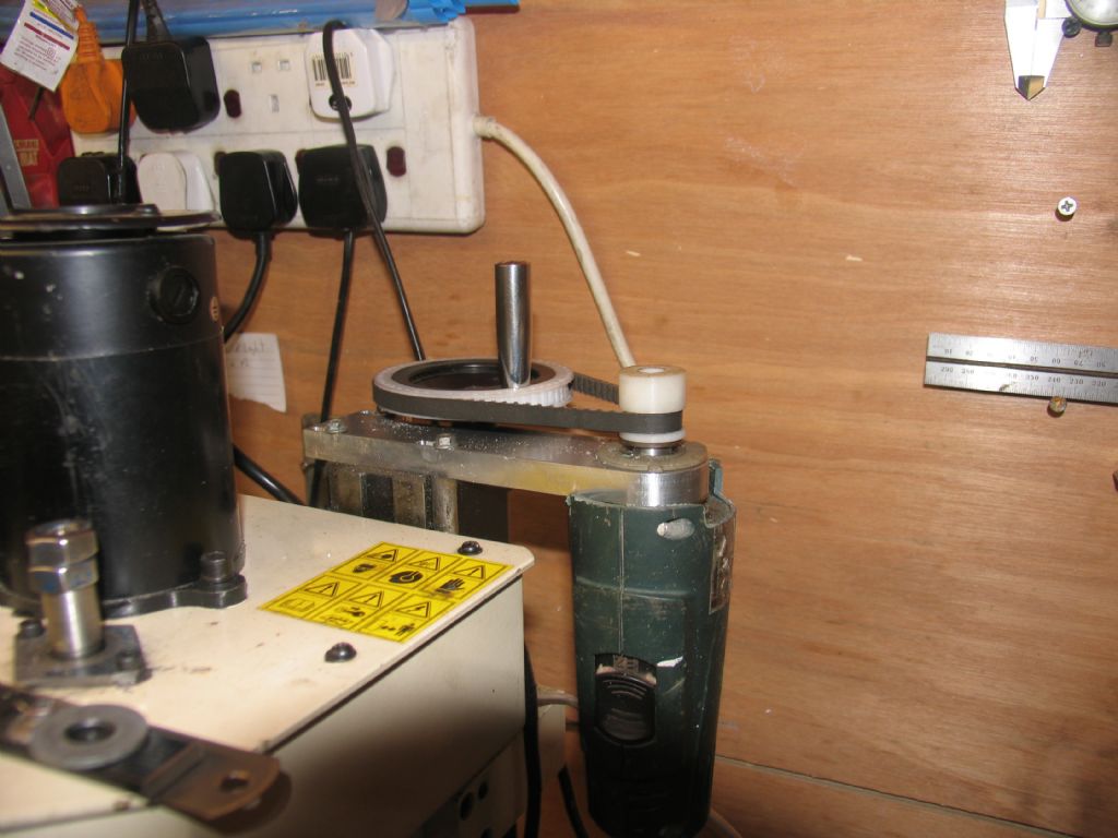

                                #103227
                                VC
                                  @vc44480
                                  Hi All
                                  I have one of these little mills, did break a motor gear so now have three spares with my luck it will be the other gear that breaks
                                  I have a question for wotsit in regards to how he fixed the electrics, mine has a mind of it's own, (works fine then loads of switching on and off )Cordless drill have bought a new switch (one that increases the speed) and the two IC's that bolt on to heat sinks but a bit weary so will wait until it gives up the ghost..
                                  Going to post a photo of what has saved me a load of hand cranking

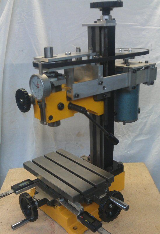

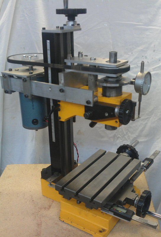

                                  Michael Cox 1
                                    @michaelcox1
                                    Hi All,
                                    I have done a belt drive conversion on my X1 mill. I made the pulleys from a cast aluminium blank but it coulld easily be made from stack of discs cut from aluminium plate pinned together and then machined.
                                    I have not had any problems with the spindle bearings. In fact when I designed the belt drive I was much more worried by the lateral load on the very small motor bearings rather than the much larger spindle bearings. For this reason I used a timing belt drive from the motor to a layshaft and then a vee belt drive to the the spindle. For further information see:
                                    **LINK**
                                    Mike

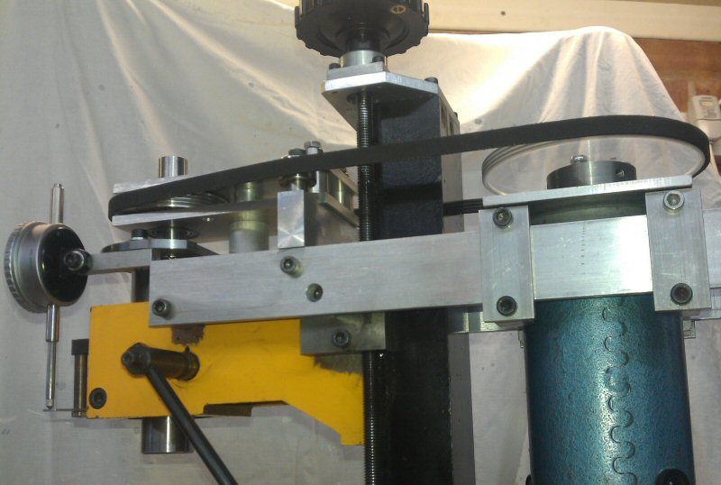

                                    Ian P
                                      @ianp

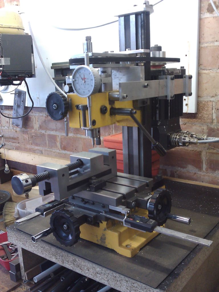

                                      imag0260.jpgI have just added some picture of my conversion in an 'X1 Mill' album
