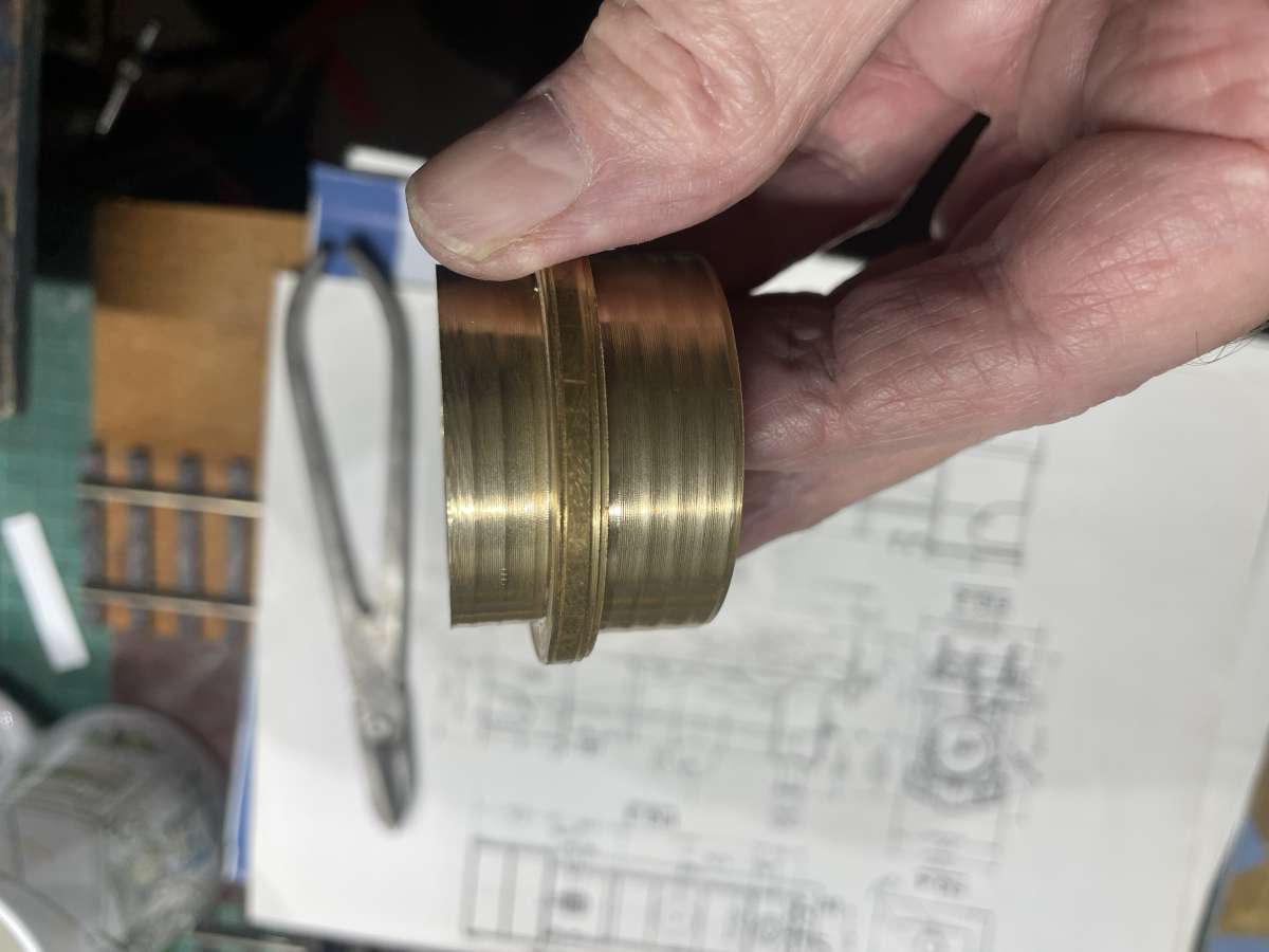

      Hi all
      i am a new member and I have an problem? I am a member of the men’s shed ( a men’s mental health charity)  who help with all types of repair projects helping the local community ( it is a national charity please look for us )
      we have an Axminster metal working lathe ( type not known ) a bit like a Colchester student ( that size )
      it has been working fine until the auto cross slide hit the stop and broke the safety pin ( which is supposed to brake to prevent damage which it does ) on replacing the pin the finish on the work piece is uneven on auto? to say the least, the finish is very consistent much like a large thread? This is on both forward and back, left to right I have checked for any broken parts misaligned adjustments, the gibs are nice and tight but free, no free play in the main spindle or the tool holder or slide.  I have now run out of ideas hence the request for help
      Any ideas would be gratfull
      kind regards
      Byron (Devon)

                    #831920
                    Byron Williams
                      @byronwilliams39920
                      Hi guys
                      Sorry for not replying sooner but other issues have occurred
                      please find attached a photo of the issue on our Axminster metal working lathe
                      i have checked all the items you guys have informed to give it a go
                      still got the same issue perhaps not as bad, but still not right⚒️
                      please any further thoughts ?????? Would be greatly appreciated
                      best regards
                      byron
                      exeter
                      IMG_1844
                      #831931
                      Bazyle
                        @bazyle
                        Byron, Can you let us know the model number of the lathe; it makes a difference whether it has just a leadscrew along the front or 3 rods (two plus leadscrew). The pattern looks about 1/8 spacing but you need to measure it accurately over several cycles and compare that to the pitch of the rack. Also what were the settings for the feed when you made this part.
                        It may be that the rack has been pushed up so the meshing is poor. Try getting a bit of paper in between the gear and rack and if so whether more layer will fit. This will indicate how poor a fit it is.
                        You could also do a longer test piece, like 4 inch, with just one light cut to show if it has a pattern. If the feed gear shaft is bent as mentioned by Sillyoldduffer above you will see a pattern corresponding to one turn of the gear – about 15 to 20 rack teeth.

                          Howard Lewis
                            @howardlewis46836
                            An Axminster lathe will probably have been made by SEIG; a WARCO by a different manufacturer, so is likely to be different, in dimensions, if not construction.
                            All that we know is that you have an Axmister lathe with a problem, probably in the drive to the saddle.
                            The picture does not show a “brass” component with a problem with the facing feed, but with the sliding drive; along the bed. A crash when facing, may well have damaged the drive to the saddle rather than to the Cross Feed.
                            A power Cross Feed suggests one of the more sophisticated models. If you want help, you must give as much detail as possible.
                            The problem MIGHT be caused by by a feed rate that varies because of a bent shaft.
                            Knowing the Model Number will make life easier, since the parts list / diagrams in the Operator Manual will show how the Saddle is driven along the lathe bed, rather than relying on guesswork.
                            Even if you do not have the operator manual with this information, some one else may have, and will be able to provide the detailed information that is required to address your problem.
                            Once you have the information, only then can you start to strip the machine in investigate the cause of the problem.
                            It may be possible to press a bent shaft, between Vee blocks, until it is straight; but this might well require lots of care and iterations to get it within 0.0005″ (0.0125 mm) T I R.
                            Possibly, the quickest , and easiest for you, will be be buy and fit new parts; once you have found where the damage is.
                            Afterwards, it will be worth making a shearpin to, replace what is probably a rollpin in the drive to the feedshaft (if it has one) or the leadscrew (Which night drive the Saddle traverse pinion via a key way in the Leadscrew). Make it from brass, (Mine are 5 mm dia with a 2.5 mm hole drilled down the centre, and they are probably a little too strong)
                            Consulting the parts list / diagram will probably simplify working out what the problem is, and how to cure it.

                                #840657
                                Howard Lewis
                                  @howardlewis46836
                                  Nothing heard since January!
                                  The ” banding” may be a sign of varying drive speed.
                                  Did the crash damage any pulleys, or move them slightly on the shaft?
                                  How about an update?
