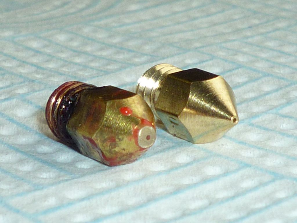

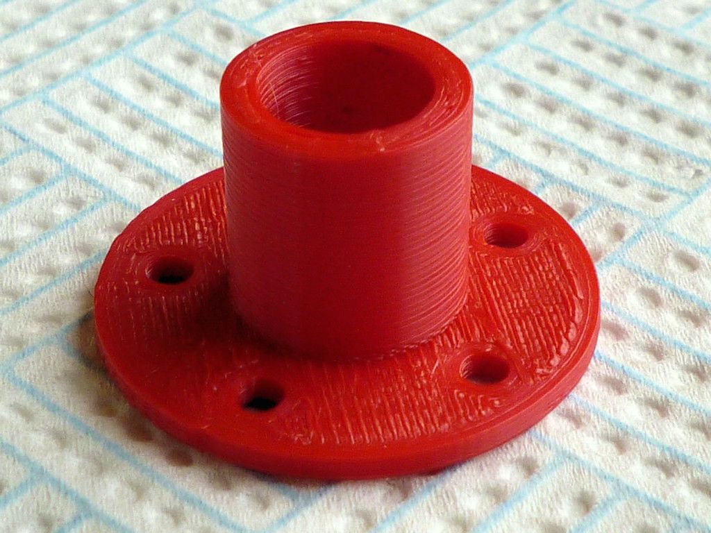

                          Whilst re-doing the wiring I also swapped out the hot end nozzle and tube. My latest print effort has a top surface that looks like a ploughed field!
                          I was wondering if this could be down to the nozzle width, the new ones are much more pointed. The old one has a flat end approx 2mm dia the new one has less than 1mm flat.
                          Should I make the flat bit bigger, easily done on the lathe?
                          #318906
                            No, the smaller nozzle will work fine.
                            Check your cura settings, especially filament width, that problem may be under-extrusion
