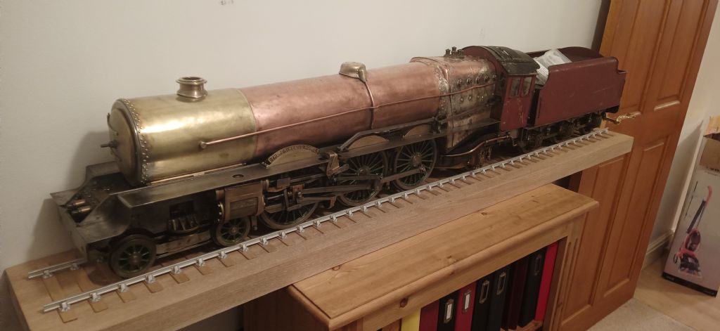

      I am in the process of completing a 3 1/2" Princess Royal that I purchased in a half finished state. The engine is to a set of drawings from H P Jackson, which on the whole have proved to be very good.
      My current sticking point are the buffers. There is very limited information on the drawings, I think I can probably guess the rear buffer dimensions from the side profile on a drawing, but the front "Oval" faces are more difficult. Does anyone have a drawing or a few key dimensions for LMS oval buffer heads and stocks?
      Many thanks

          I do not know if it is any help, but there seem to be some good photos of the class here:
          From the archive: Princess in waiting
          Also,
          8P 46200 – 46212 4-6-2 LMS Stanier Princess Royal
          https://modelengineeringwebsite.com/Princess_Royal.html
          https://collection.sciencemuseumgroup.org.uk/objects/co212771/model-steam-locomotive-princess-royal-model-locomotive
          Perhaps send a suitable donation to these people and they will pootle off into their shed with a tape measure for you:
          http://www.prclt.co.uk/
