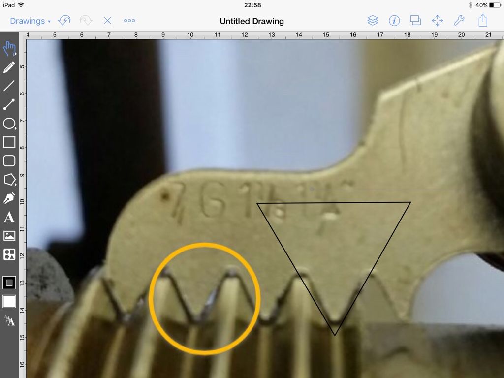

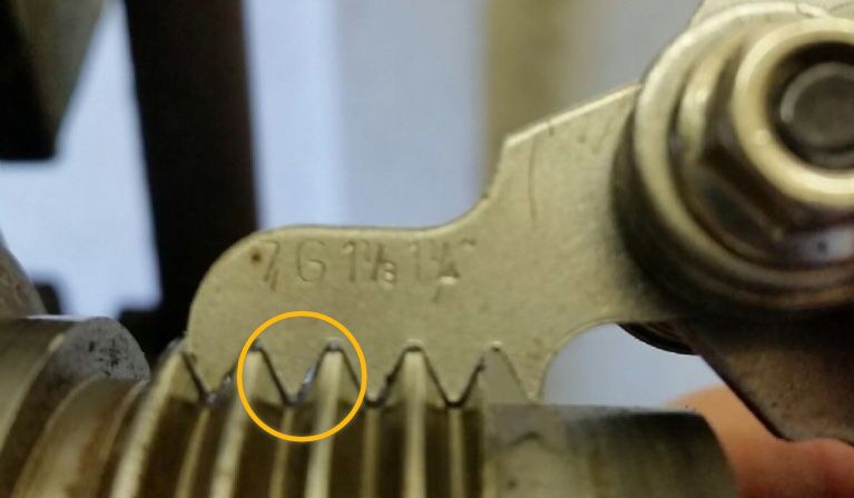

      … So we're agreed on a 7 tpi , but we haven't agreed on 60 or 55 degree ,a member on here whom I've been pming has the same lathe says his nose thread is 55 …
      Sean,
      I think we are all now agreed that your thread gauges are Whitworth form [and therefore 55°]
      … although I remain a little dubious about their quality.
      We still don't know if the 'daylight' I circled is because of a worn thread or a badly made gauge dont know
      … But the first two threads on the nose appear to be a good fit to the gauge, and therefore [if the gauge is accurately made] will be 55°.
      Appearances can be deceptive, especially on photos; so I suggest that you double check the 'fit'.

        This is pretty rough [finger-painting on the iPad] but
        The slope of the thread flanks is steeper than the equilateral triangle; so 55° would be a good guess.

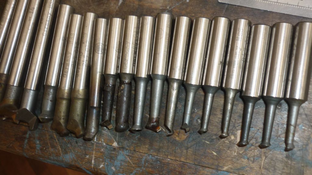

              Sean, these type of home made threading tools work well,
              Described here how to make ,ive used round o1 steel (silver steel ground rod)to make them in the past for boring and one or two threading jobs  as the design is very similar .
              The cutting angle can be accurately made using your compound(topslide).The shank can be flattened to hold in your tool post if you dont have a boring bar holder. The cutting end can be heated to cherry red and quenched in water  (supposed to use oil but water works fine)and used directly without tempering(on soft steels.aluminium and cast iron,etc..)
              **LINK**
              I think the design is taken from a German/Swiss design. I have a few deckel ones (photo here) for boring ,that work superbly.

                Great minds and that ,was thinking about it last night . I don’t have 01 steel ,I have some 30mm rod that came off an elevator, this was what I used for the boring bar I tried to drill a hole for a m6 tap unsuccessfully I may add . It seemed very hard material . I might try it out on that . I can hardly mark it with a file .
