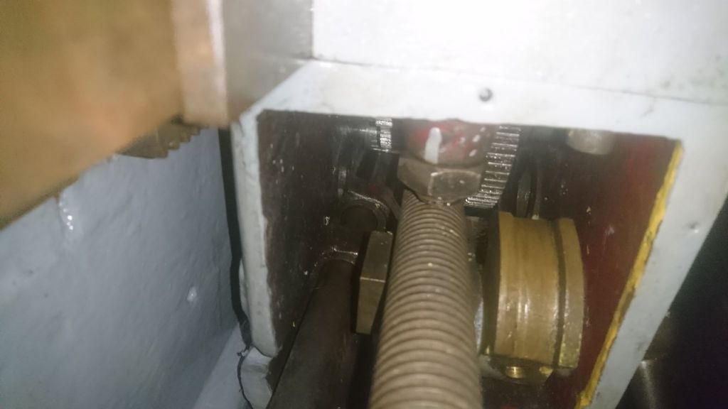

      Some of you may remember my lathe identification question
      Against all sensibility that lathe got bought and mostly restored so far
      However the apron is missing a few part: the worm screw that mounts on the power feed shaft and the assorted gears that transfer that power to either the rack and pinion or cross slide leadscrew.
      Option 1: design and build a replacement for the missing gearing to the power feed shaft – the rarity of Wilfins means I can't expect to find someone to give me dimensions as per the original build
      Option 2: Slap an electric motor somewhere in or on the saddle and belt it onto the existing gears
      To me option 2 sounds much easier but at the same time its rare to see it outside of 1 or 2 modified mini lathes which makes me think there is a catch, A 21W, 60 RPM worm gear motor on ebay is only £15 so why wouldn't more lathes use that instead of all the cost of gear cutting?

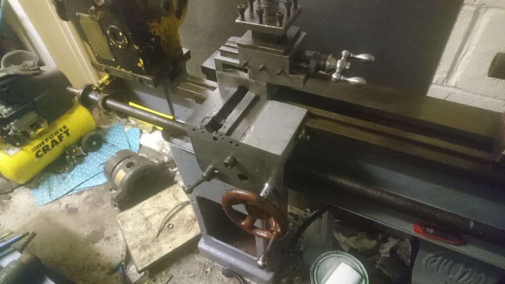

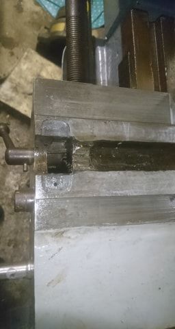

                Rainbows
                  @rainbows
                  Throwing in some newer pictures. To the mention of change wheels- one of the gears in the apron is stamped 72T and has been welded onto a hub and fixed to the shaft with a taper pin. Probably a farm repair, or maybe the Wilfin factory ran out of the right gear blank.
                  I do in fact have the shaft for the power feeds, though I managed to obscure it with the leadscrew in the first pic.
                  My mini lathe is currently in a half state of repair being mid way through a CNC conversion when I decided to restore the Wilfin. I do have a 3D printer though which would be useful for prototyping (taking bets on how long a PLA wormgear would last in actual use). No dividing head but I could maybe bungle something together on this lathe.
                  Checking out HLVs they have a 1/10HP (~75w) motor according to the internet (couldn't tell if AC or DC) which is beyond the majority of chinese worm motors on ebay but would be well within a drill motor.
                  I would trust Hardinge would spec a strong enough motor that the issues Bayzle mentioned wouldn't happen though I'd be interested in a first hand account if it maybe has issues on roughing cuts or the like.
                  While the leadscrew is fully working there aren't any change gears, so I have been wondering about trying an electronic leadscrew but that's for another day. Buying in metric ones is a neat idea though I'd never thought of that before.
