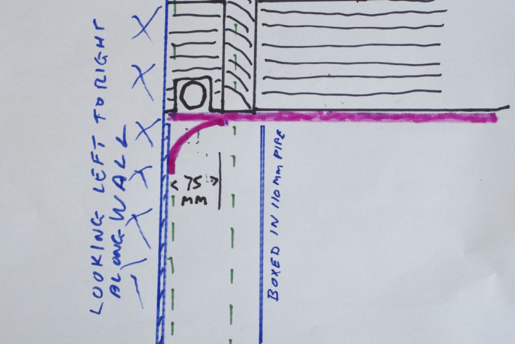

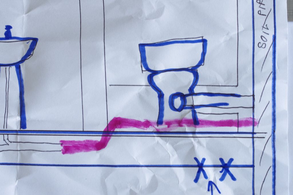

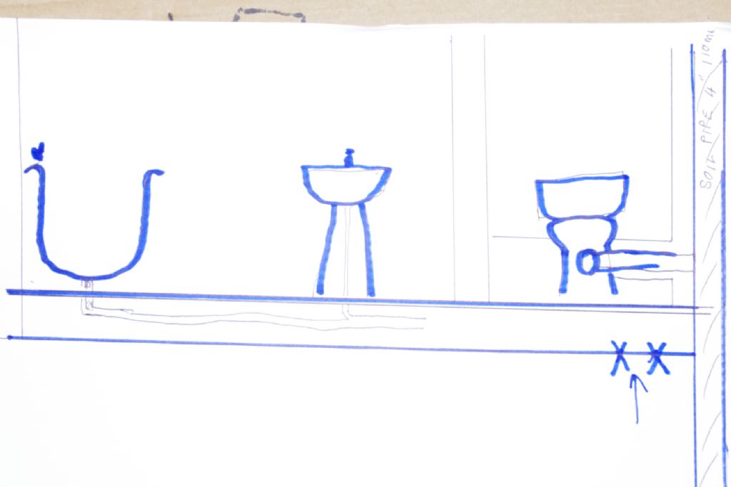

      Our house has been built with separate WC and bathroom, they are adjacent to one another. The waste from the bath and washbasin run underneath the floor. The WC waste is above floor level and is boxed in. The connections to the main vertical soil pipe are boxed in the far wall of the WC. There is a slight leak running down the vertical soil pipe. I assumed that if I drilled a hole in the ceiling below, I would be able to see the bath/basin waste pipe. The pipes run within 6" of the outer wall so I drilled where the X marks are. There is no sign of the pipe. Surely, it doesn't rise up as it passes the lavatory?_igp2739.jpg

              I looked using an 8mm USB snake and my laptop through some 1/2" holes I have drilled. There is about 8" between the upstairs floorboards and the ceiling downstairs. Fortunately, the leak is from the bath/basin, not the lavatory.

                      I had to measure the distance between the ground floor ceiling and the underside of the floorboards hoping there was a section of boarding, but it measured 8", confirmed by direct measuring from the stairwell. Those pipes must rise up when they pass through the lavatory. Next week I will be in a position to remove the toilet which will give me plenty of room to work. I already know where the waste pipes run in the bathroom, a few years ago, I refitted it with all new stuff and also the toilet. Removing the bath panel confirms that the floorboards run at right angles from the wall and the waste pipes run parallel to the wall just below floor level. There is no sign of wet anywhere except lower down on the line of the vertical 4", 110mm main waste.

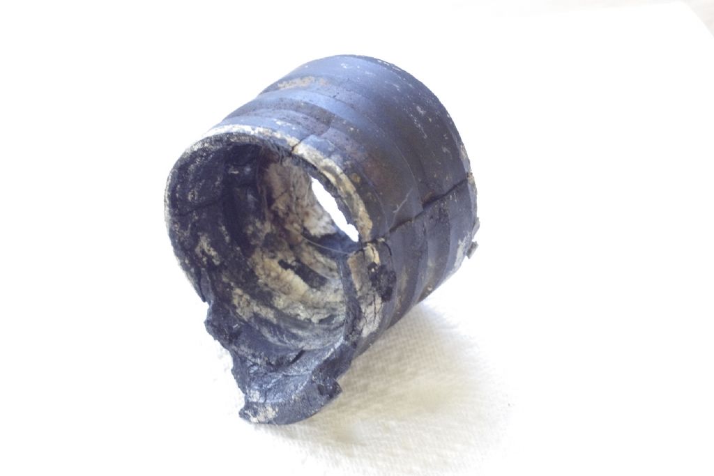

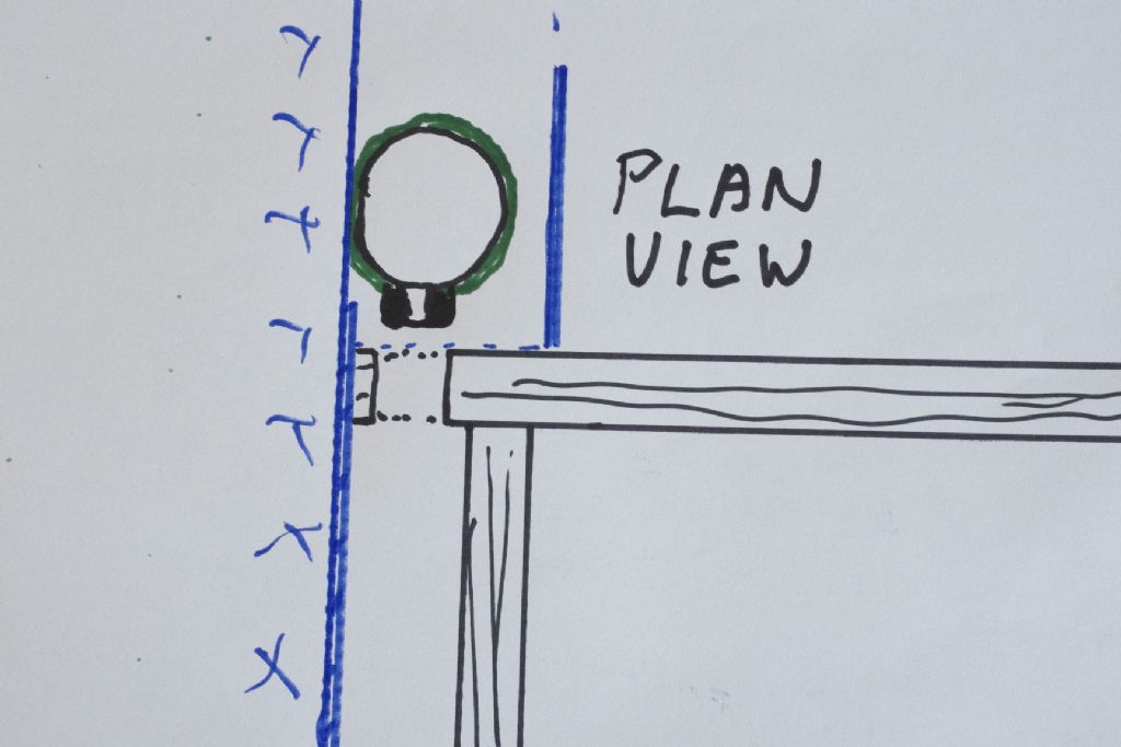

                                  _igp2748.jpg_igp2745.jpgI thought I would show you where the pipe actually was. Firstly, my cheap USB endoscope gave up the ghost and I was forced to go to Screwfix and get their cheapest self contained one. It is a Magnusson with a 1 metre flexible camera. It is much better than the broken one, not exactly cheap at £70, but easier to use and the picture is better.
                                  I found the pipe below the floorboards, but hidden behind two joists. I cut a notch in the joist which ran parallel to the 40mm pipe and cut the pipe with the ratchet cutters, they don't leave a burr inside the pipe. The pipe was not properly inserted (about 12mm) and the rubber sealing bush was perished, no wonder it leaked. The strapped and glued adaptor has a smaller diameter boss than a modern one, so I had to make a one off coupling. I cut one end off a push fit coupling and removed the raised lettering on the od. I bought a 40mm tee with the screw up ends and the plastic rings just fitted the coupling and I could fit one of the rubber seals. The seal was too tight to push into the boss, so I had to reduce the seal od by 1mm using a scalpel blade. Wilr plenty of silicone grease on everything, I just managed to push it home. A new length of pipe 35mm longer than the original was fitted to just reach the inner wall of the 110mm pipe. As the ends of the old and new pipe were touching, I cut the centre stop out of a pushfit coupling and made a sliding joint.
