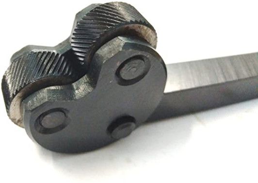

      I want to knock up a knurling tool along these lines:
      I have wheels and am reluctant to cough up £18.60 for a tool which I could make from offcuts in an hour or so.
      What I don't know is how hard the pins should be – I assume that they should be hardened to some extent, but obviously not to the point of brittleness.
      My experience of hardening high carbon steel is limited to making cutting tools. Maybe here I should deliberately not heat for long enough to through-harden?
      Any advice woud be welcome.
      Robin.

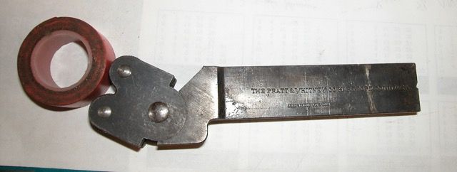

                            If you plan to make your own push tool may I suggest that you follow the Pratt & Whiney design where the pivot is offset so one wheel is effectively underslung.
                            My experience is that this style is less likely to mis register producing double knurls. Subjectively it seems to need a bit less force than the common style of pivoting push knurling tool. But that may be due to the push tool in question being hobby bran whilst P&W were a high end maker of machines and tooling.
                            That said I still consider the "nutcracker" hand squeezed style excellent for casual use. Mostly because set up time is about 30 seconds!

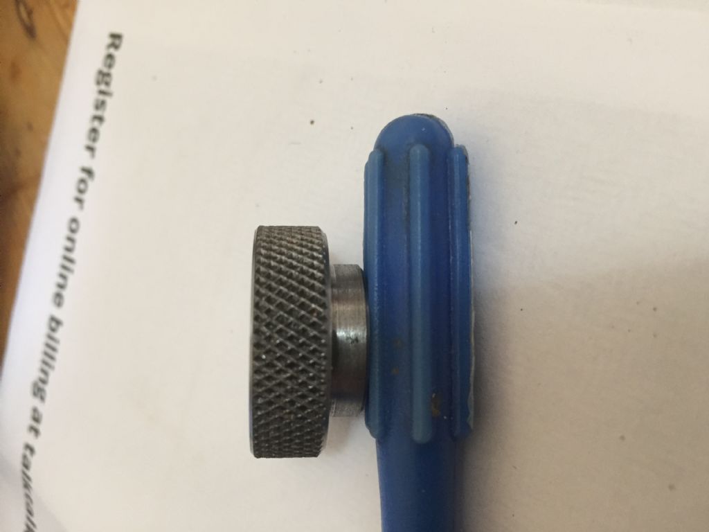

                                              Thanks for replies. I actually have a cheap clamp-type tool, which works OKish in brass, but I've never got the thing to produce clean knurls in steel. I think it's partly to do with the arms being too floppy and partly to do with the difficulty of twiddling the wheel fast enough to get a deep enough cut on the first rotation of the work to give registration on subsequent turns. Minimum speed on my lathe is 65rpm.
                                              I'm looking at better designs for clamp tools, but the reason for my post was that I wanted to make a lash-up push knurler for a job in hand an wasn't sure how hard the pins needed to be. I'm confident that the the lathe bearings are up to it.
                                              I ended up buying a 'single point' diamond wheel from Zoro and, as the consensus was that I didn't need to harden the pin, I lashed up an ugly tool with an untreated silver steel pin:
                                              The good news is that the pin seems fine. Bad news is that I can't put enough force on using a QCTP – so I need to make something more in line with the cross slide screw. Or make a proper clamp tool. One lives and learns!

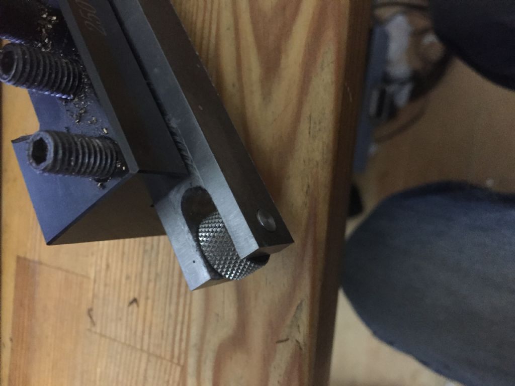

                                                  But aren't the shanks of HSS drills much softer than the business end? I've certainly scored drill shanks when I've not tightened the drill chuck enough. And is bronze really hard/strong enough for this sort of thing? The numbers (hardness / Young's modulus) suggest not. But it's never that simple I suppose. Or maybe the smiley means it's a joke. I don't know – I'm a tyro, you could probably send me to the store for a metric monkey wrench.
                                                  I did get eventually get a half-decent knurl with my improvised tool:
                                                  but it's not sharp.
                                                  I think I have to make a clamp-type tool. David George has kindly sent me detailed plans for his version – thank you David.
