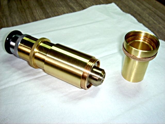

                  Here's an unexciting photo of a tool block aimed to be practical rather than pretty, so it shows lots of machining marks (and swarf). But see how the diffuse light sources don't exaggerate the marks – if this was a flash photo it would look even worse!

                    Maurice,
                    The polarising filter is unlikely to be much help, because reflections from metallic surfaces do not change the polarisation of the light.
                    Neil is on the right lines, but the classic solution to the problem is a 'light tent' …. This can be anything from a rolled tube of tracing paper, through to an opal Perspex sphere [use your initiative, and maybe visit the lighting department at IKEA]. Put the subject inside, shine the light at it from outside, photograph through a suitable hole.

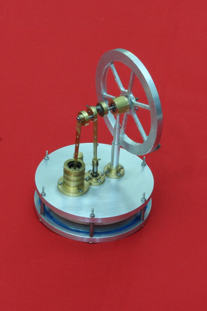

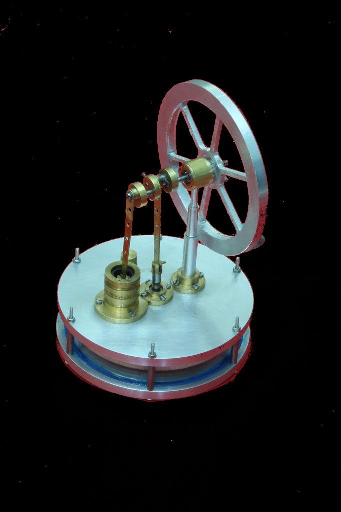

                                      Here's a variation I'm struggling with at the moment. I'm trying to photograph a shiny object and then separate it from the background. It's the "Green Screen" technique, except I'm using red because the model has some green in it. The tool is gimp, not used skillfully in this example.
                                      Looks like it works, except for the unnatural red reflections that become obvious as soon as I select by colour and then delete the red background. My replacement background happens to be black but you get the unwanted effect with other backgrounds too.
                                      The picture is a long exposure aperture priority lit by light bounced off the ceiling. Good news, you can't see the scratches. Bad news, it looks as if it's red-hot!
                                      Has anyone any suggestions about how to get rid of the red reflections? I'm going to try making a light box next unless someone saves me with a good idea.
                                      Sorry about the size of the photos.

                                        I'm in the early days of experimenting with Green [etc.] screen, but I understand that you need to light the subject and the screen separately. … Which means a bigger 'set' than one might have hoped sad
                                        Found a good video the other day … B&H
                                        Edit: [for still photography] here is a different approach.

                                          In photo-paint & photoshop you can adjust the tolerance by hue, brightness and colour.
                                          paintbucket fill is a bit of a blunt instrument.
                                          Best way is to select a mask by colour rather than use the paint bucket. Tidy up by using subtract or add mask, then make sure anti-alias is switched on. Now clear to paper colour or fill it. You may need to expand or contract tyeh mask by a pixel or two or feather it to get the best results.
                                          Our retouchers usually just go straight in with the freehand mask tool as ME contributors rarely do us the favour of a mono-colour background!

                                              There's so much variation in the density of the red Dave I think you'll find it much quicker to do it again. This time on a white background. A few sheets of printer paper should do. Black should be ok too.
                                              If you want to change the background then try GIMP's foreground select. Once that's right invert the selection and bucket fill with what ever you like. It's a plugin and could be used to select the background as well really. Depends on which is easiest.

                                                Another Gimp option is the Color to Alpha function, info: LINK
                                                Also in Gimp you could,
                                                – Load the picture.
                                                – Select the red channel in the Channels tool window, click on th eye to make the red channel invisible.
                                                – Press ALT-PrintScreen key combination on the main picture window to copy the photo to the clip-board.
                                                – Choose File/New and paste the clipboard content into the new image, then save.
