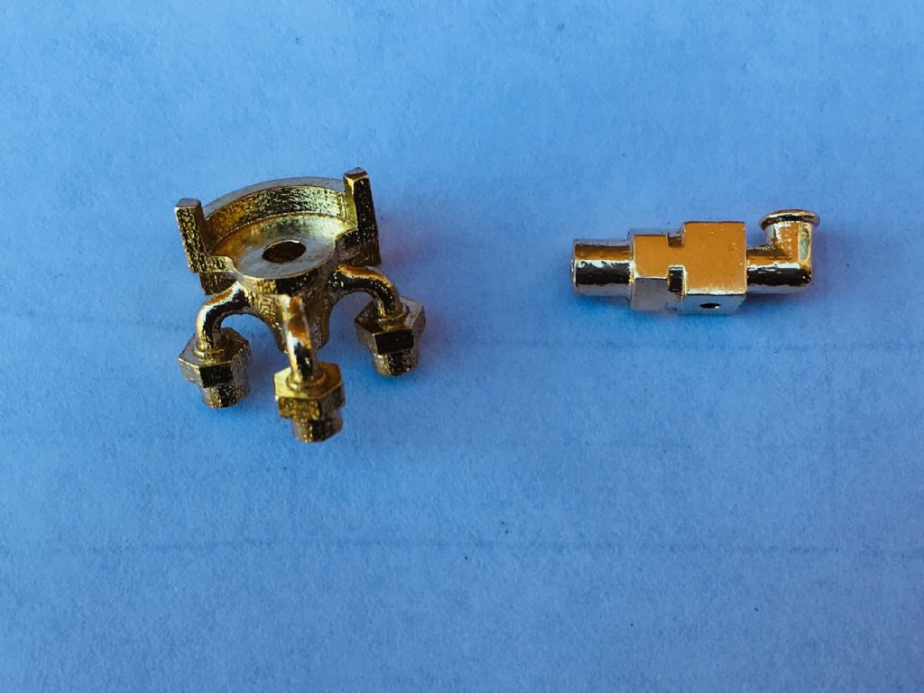

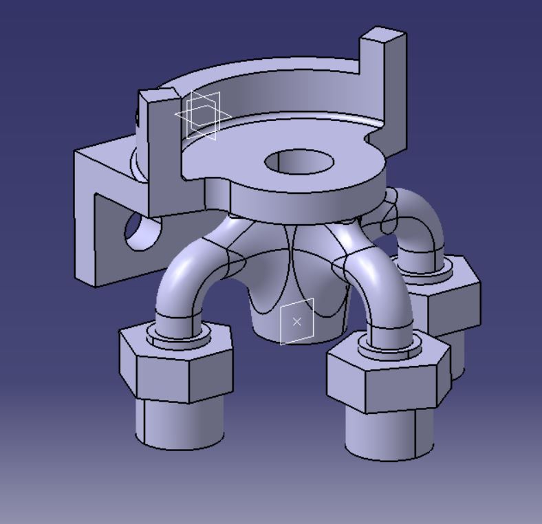

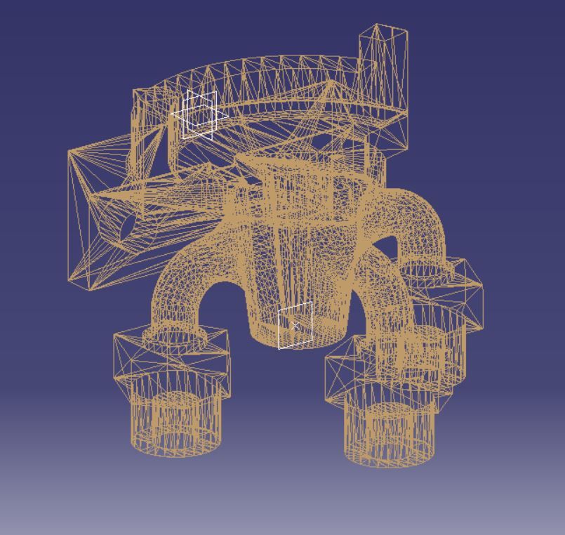

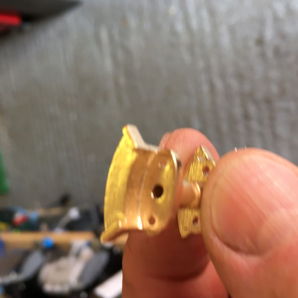

                      I have had some lost wax castings done by Shapeways as a trial for a 5" gauge loco. They are small parts typically around a 12mm long but complex and a pain to make conventionally. They only cost around £12 each plus postage so it was well worth the punt. The quality is reasonable and at normal viewing distances look completely acceptable.
                      The first photo shows a typical CAD model, The second shows the mesh for the stl file (note This was a coarse mesh and on subsequent parts I have increased the cells numbers. the rest of the photos shows the finished parts and a couple of other castings. hope this may be of interest.
