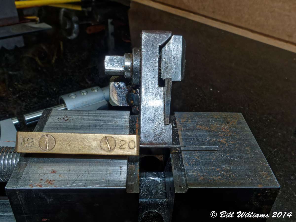

        This really is the last one; I just remembered I had a cut down HSS blade holder which I no longer use.
        As you can see, the “vertical” face isn’t; it’s at half the included angle of a tapered HSS blade.
        The bottom of the blade shows the ground angle OK, though it’s hidden at the top as it’s been sharpened to a horizontal cutting surface.

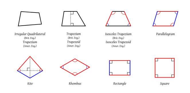

        It’s only just dawned on me, that I and others, have been describing the HSS blades as trapezoidal, but I guess that’s not strictly correct, as no two sides are parallel; avoiding discussion of the ends of course.
        image_2024-02-06_202447202
        Irregular Quadrilateral maybe? (depending on which side of the pond you reside)
        Also shown is the, ex-GPO wire feeler gauge I mentioned earlier
        Bill

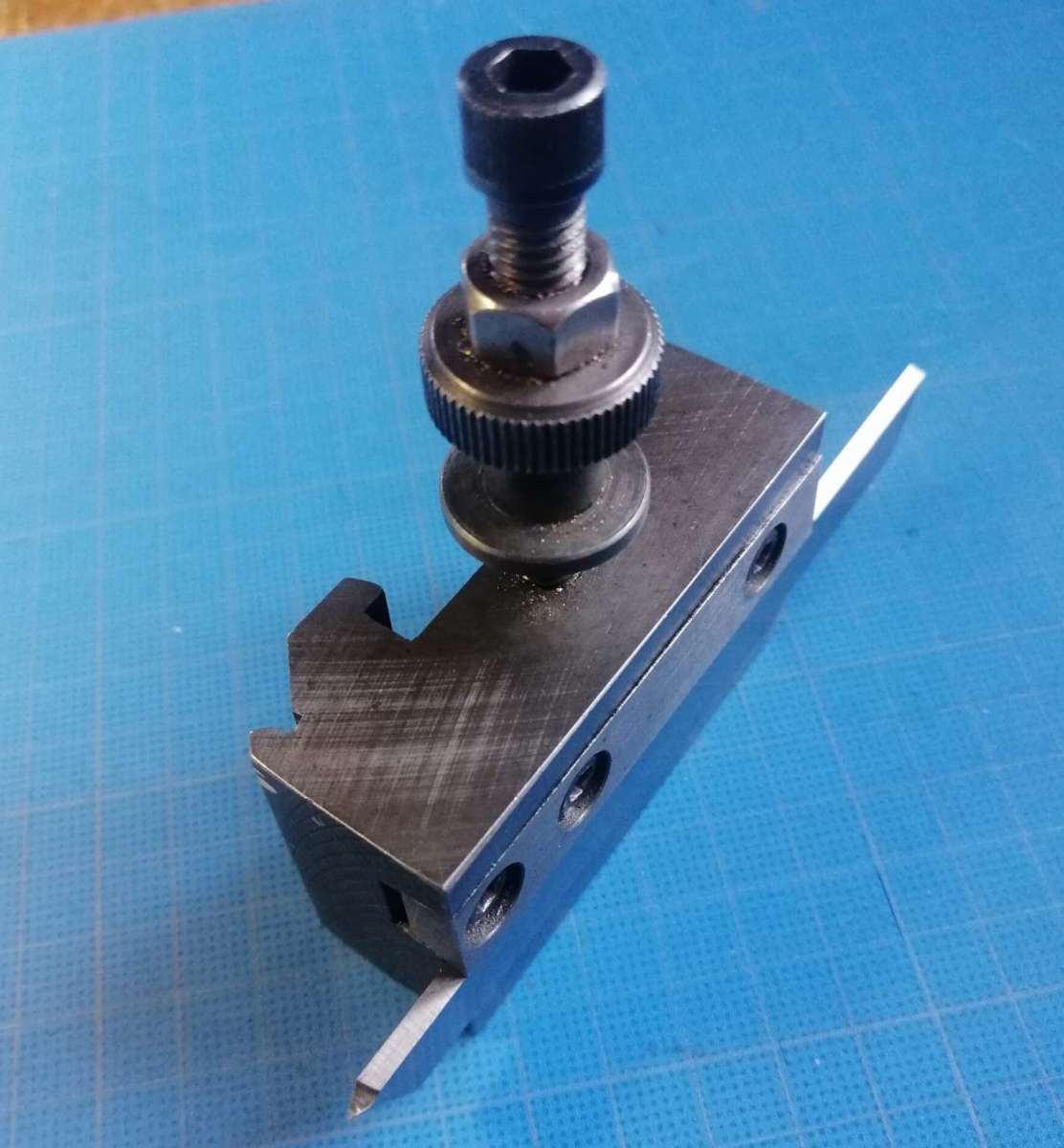

            By way of an update, this is all very strange. A replacement holder and a replacement blade have arrived.
            • New Blade c/w New Holder – everything is fine, and the blade sits vertically.
            • Old Blade c/w New Holder – everything is fine, and the blade sits vertically.
            • New Blade c/w Old Holder – everything is fine, and the blade sits vertically.
            • Old Blade c/w Old Holder – blade rotates away from vertical.
            Even with swapping the locking “wedges” over between holders & blades, the _only_ combination that always fails / rotates in the old wedge in the old holder with the old blade. All other combinations are fine. I will return the old bits to Arc and see if they can work out what is wrong.

                how does the cross section of the new and old blades compare?
                Bill

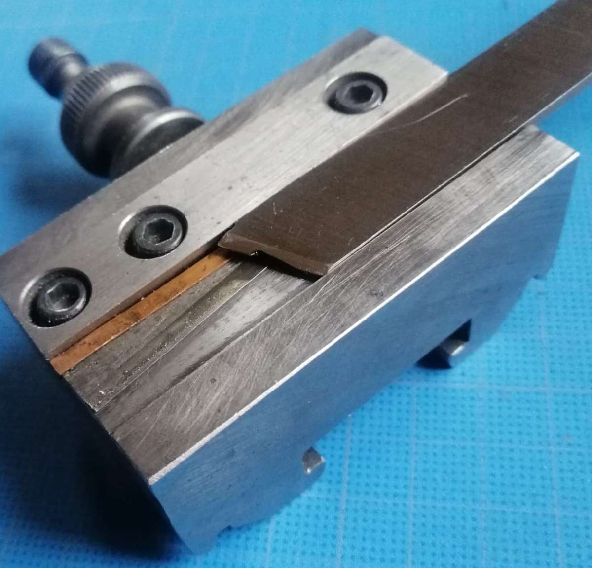

                  Just adding another parting blade holder version to the ones that Bill showed. I do not know whether this is a Dickson part as it came along with other toolholders with a second hand lathe.
                  I have no idea what the correct blade for it should be but the ones it came with were not held correctly and had no side clearance whatsoever on the chuck facing side. I packed the top of the blade recess with a shim (two actually, one brass, folded into an angle for retention, and steel strip that sits under it, retained by grease) steel strip is displaced in lower picture.
                  Compared with the OP’s 250-107 this holder has the advantage of being able to part off very close to a shoulder or the chuck as the LH edge of the blade is almost flush with the face of the holder.
                  Ian P
                  P.S. The blade in the picture is ground to suit making a PolyVee pulley.
