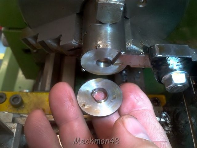

            As for parting on my WM 250V-F , I use both a front mounted insert type (RDG.. usual disc. ) plus a HSS home ground tool, on Ally, Brass & BMS ( up to approx' 20mm ) anything larger in BMS I have used my home made rear parting system. Larger dia' in Ally, Brass I can use the front mounted inserted tip holder (2mm wide tip ).
            Some 2mm x 25mm dia. large BMS washers trialled when I finished constructing my rear tool post system…
            This shows I have used a front mounting holder upside down as it proved that the original design meant that there was too much flex in the original blade .. too much unsupported overhang… creating a concave/convex surface.. this is much more rigid..
            The front system link is..
            **LINK**
            As mentioned, Make sure that everything is rigid, compound slide snugged up, saddle locked, tool square to the X axis, tip dead on centre height, plenty of lubricant ( flood or brush fed ) &, once started keep the infeed going, I parted the above washers using approx' 260 rpm with the auto crossfeed at the machines lowest setting, have just recently ( yesterday ) parted off 16mm Brass @ approx 600rpm, lowest set auto feed, with the RDG tool system.
            What was once a job filled with dread now is now confidently done.
