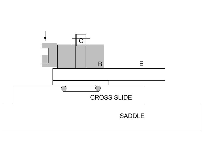

Yet another sketch to start off with:
Once again not to scale, but the top slide etc. are sitting in about the right position relative to the saddle.
The force at the tool tip now pushes the tip down, and since the tip is out-board of the top slide base, it exerts a turning moment trying to tip the top slide over. In this case, the pivot point is obvious, it’s at P3, the in-board edge of the top slide. We now need to look at what resists this turning moment, attempting to keep the tool tip stable relative to the work.
The obvious answer to that question is the gib strip, i.e. not very much! Just a floating strip of steel, held lightly (it has to be lightly, or the slide wouldn’t slide) against the inner vee of the base, located laterally and vertically by four round-nosed grub screws pushing into shallow dimples in the gib strip. Since the assembly bears the same relationship to rigidity as blancmange does to concrete, one might expect it to deflect when a load is applied to the tool tip. And it really does deflect:

Units for deflections are again 0.0001”, for A, B, C & E negative numbers are down movement, positive numbers are up. D is inward movement of the tool tip. I tried to keep the loadings the same as for the rear post, but they’re probably a bit different, perhaps slightly higher.
Some of the results might not seem to be consistent with each other, that’s for two reasons: 1) the readings for A, B, C & E are all vertical, but they’re not coplanar, and 2) it’s a complicated situation with things bending, tilting & twisting all over the place!
As far as the inward movement of the tool (D) is concerned, it's very low, but I'll deal with that later, if I may.
Before that, where is measurement E taken? Sketch:
E is the back end of the top slide. The cutting load, being outboard to the left of the circular base, causes it to lift. Quite possibly this is not just down to the gib strip, but also by lifting of the right hand side of the dovetail spigot securing the top slide to the cross slide, pivoting about the point where the front edge of the top slide base meets the cross slide.
This upward movement of the back end, and the corresponding downward shift of the tool tip, and both are BADLY affected should the top slide be extended off the base, towards the headstock. My tests were undertaken with the top slide arranged as shown above, i.e. NOT overhanging the base.

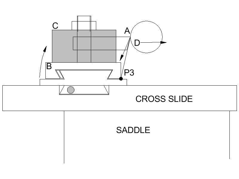

So what have we got? The tool load causes the slide part of the top slide to pivot inwards about P3, movement allowed by the gib strip allowing the operator side of the slide to lift. The cantilever load on the tool on the headstock side of the base pushes down and lifts the tailstock end, gib strip flexure again, probably augmented by movement in the circular dovetail spigot. The Dickson block moves differently to the top slide on which it sits, presumably as a result of stressing of the holding down bolt. Oh yes, let’s not forget the tool holder and the tenon bolt that holds it to the main tool block.

Given that my loading system was vertically down on the tool, and not inclined as in reality, the static measurements of inward tool movement D must be regarded as marginal as far as coming to any firm conclusions is concerned. To resolve the matter I did some dynamic tests, measuring the in/out movement whilst actually parting off. The photograph shows the position at which I set the indicator to ‘measure’ this movement.

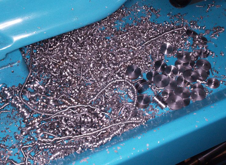

Not if we avoid jams in the first place! Here's the residue of about 50% of the tests, there's something like 40 cuts there (some of the bits have multiple grooves), all using the same tip and not a single jam up for the whole 100%:
P.S. – can we have a whip round for some replacement 19mm bar, please?!

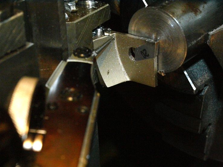

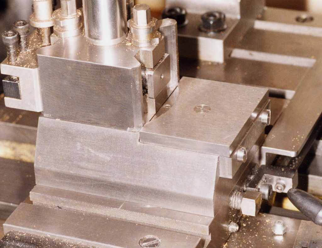

Here we go again, but no sketch this time, just verbage & one photograph!
It should now be apparent that we are dealing with a complex mechanical system, with many variables, any detail of which can adversely affect the results of parting… and I’m only dealing with tool support systems here. each variable got right, in a logical and methodical manner, whilst and avoiding false assumptions.
So first eliminate everything you can – slide adjustment, obviously, but also little details like swarf trapped under a tool post, or dings and burrs on the top slide. They prevent metal-to-metal contact over the full available area, and add more flexibility and unpredictability into the system. Make sure the tool post bolt is vertical in both planes so that the tool post sits flat, and the tool post is either a good fit on the bolt, or sleeved to fit, so that it can’t shift around on the bolt.
Then understand what’s going on when the top slide and tool post come under stress, so to that end let’s think about what might be happening with that gib strip under a range of loading conditions – let’s designate them as light, intermediate and heavy.
Light: small depth of cut and feed, low tip load, gib strip very lightly loaded, virtually undisturbed, it’s life is comfortable and all proceeds normally. Probably only applies when scraping a thou or two at low feed, with a sharp cornered tool – it wouldn’t take much of a tip radius to increase the load sufficiently to get the gib into:
Intermediate: moderate tip load, gib under some stress, operating in what we could call its ‘squashy’ mode. Any variation in tip load will disturb it one way or another from its mean position, the tip will wobble about a bit and not be stable relative to the work. An alternative designation for intermediate mode could be ‘chatter mode’, for reasons that I think you will find obvious.
Heavy: some serious cutting work now, the gib is fully disturbed, by which I mean that all flexibility has been taken up by the forces at the tool tip, and it’s locked up solid. The tip position is stable relative to the work, variations in the cutting load do not result in its position changing. Please note that here I’m only considering the behaviour of the gib strip, not the other components of the tool support system.
I suggest that getting the gib into the chatter mode accounts for the chatter part of the parting problems, because due to the width of a parting tool it would be very unlikely that light mode would ever be experienced – one touch from the wide tool and the jib goes straight into chatter mode. Then it all gets exacerbated by the driver, who hears chatter start and backs off. Then re-approaches gently, and it starts to chatter immediately, as the tip gets rattled about by the previously engraved chatter markings, and it just seems to go from bad to worse.
So the answer to chatter when parting is to load the tool up more so that the load takes the gib strip into ‘heavy’ mode, where it’s stable. If it chatters, don’t back off, but speed up. This provides the rationale for the success of two techniques that have been described in this topic:
1) Use power feed – manual feed will inevitably result in variations in the depth of cut, and therefore the tip load, giving unstable conditions and risking the gib going into chatter mode, perhaps when the driver is changing hands. Power feed will be constant, much more stable, and will typically feed at a minimum of 0.002”/rev (which I find to be a satisfactory rate), which is equivalent to:
2) Feed faster – greater depth of cut, higher tip load, forces the gib strip into ‘heavy’ cutting mode where all play has been taken up, so stable cutting conditions with no further deflection. If no power feed, just wind the handle faster, and keep it as smooth as possible.
Now it must be said that the gib behaviour I’ve described is NOT proven beyond doubt, for that one would have to do a lot more detailed work on the gib itself, and such work is beyond any facilites available to me. I would like to think that it’s not just mere conjecture, perhaps ‘rational explanation’ of what could be happening might be the appropriate terminology. There is further support for the theory, as it also explains three other situations that you will probably have come across during normal turning. These are:
Q1) You take a ‘decent’ cut down a bar, then wind the saddle back without retracting the tool, and get a left hand screw thread formed on the work.
A1) On the ‘decent’ cut the tool tip was deflected down and out, and cut a larger diameter than you expected, on the return path the flexure had gone, and the tool tip was able to form the pretty (or should that be ‘pretty annoying’?) pattern.
Q2) Making say six parts to the same diameter, taking say 0.080” off the stock. You work down to diameter carefully, frequent micrometer checks to see where you are up to, final cut to size say 0.003” deep, spot on, set the micrometer dial to zero, or the DRO to diameter, and make the next one using those settings, but going down to size in two equal cuts of 0.020”/0/020” – and the size comes out wrong!
A2) The DRO or dial thought it knew where the tool tip was, but the top slide had flexed more with the heavier cut, and fooled you by shifting the tool tip away from where it ‘should’ have been. The solution is to always take the final cut on the subsequent parts at the same depth of cut used to bring the first part to diameter, so cut at 0.020”/0.017”/0.003” instead of 0.020”/0/020”.
Q3) Having cut the stock to near finished size without any problems, you take the final cut at two or three thou. and the d**n thing chatters and wrecks the job!
A3) The roughing cuts had the gib in ‘heavy’ mode, the light cut let it drop down into the ‘chatter’ region.
So what can be done about it? Well, if you’re using the top slide… nothing that I can think of! You’ve just got to live with the behaviour, understand it, and work around it. Or use something more rigid to support the tool system, such as the rear tool post – and by now it should be obvious why this works better: it’s a more rigid structure. It’s as simple as that. A bit if chatter is still possible, because of lifting of the cross slide, but in my experience it’s significantly less of a problem than with a top slide. And, of course, it’s lifting against a block gib, securely bolted to the cross slide
But I do think that the front position is the best option, if the flexing behaviour can be overcome, because the forces are directly down into the bed, and lifting of the cross slide is also eliminated. For that you need something like Tubal Cain’s Gibraltar tool post, or Neil’s solid support block. I’ve no experience of those specific units, but this is my version on the theme:
It works very well, and I can be 100% confident that the Gibraltar would work at least as well. You will be surprised at the cutting capability of an S7 with such a tool support system. And in addition, you will eliminate the Q1, Q2 and Q3 problems described above.
A further improvement to mine and the Gibraltar would be to extend the base in and out to cover the adjacent tee slots, and provide two bolts in each ‘wing’ of the base, thereby eliminating any weakness connected with the dovetail spigot. Just like John Radford did, heaven only knows how many years ago. Have a look on the Hemingway site, Tool Holding & Positioning/Myford Specific Items/Improved Top Slide to see what it looks like – it’s beyond me why Myford never took this up!
Oh, if you do look at that, you’ll see that Radford fitted his top slide gib with a locating dowel and slide lock, exactly as GHT did – but who had the original idea?! I have that on my S7 top slide, and it certainly makes a difference to adjustment and smoothness of the top slide, but does it solve the gib flexing problem? Well, I’ve tested it, and unfortunately the answer is a definite no, not a bit of difference, I’m afraid. Locking the gib at one point only, roughly in the middle of the gib, still leaves the end under the tool post free to move.
A solid front support does work better than the rear tool post. But despite that I still use the rear post, because it has a significant advantage: the front position is where all the ‘normal’ tools go, and their support system (4-way turret, Dickson tool post, Aloris, etc.) frequently gets twisted around, so every time a parting tool is required, it has to be clocked true. And if that’s not done, and it’s even a little bit off-square, you end up with additional unknown/unpredictable behaviour. With the rear post the parting tool can be set accurately to centre height and accurately SQUARE to the work, and then just left there, ready when needed.
An obvious difficulty of all solid front supports is that there’s no feed screw with micrometer collar, but if you have a DRO fitted, who needs a micrometer dial? Put the top slide away, and keep it for turning short tapers. And if you haven’t got a DRO… well, you can work out for yourself what needs to be done!
I hope that’s explained chatter adequately, and provided some indications of how to deal with it. In the next chapter I’ll look at my conclusions re. jam-ups and dig-ins (yes, they can still happen), how they happen, why they happen, and how to avoid them. Most of the time, but not always!

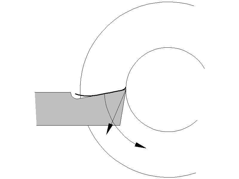

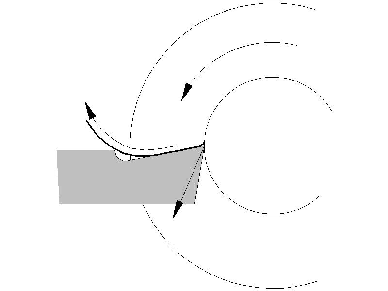

The following sketch shows a section through a parting off operation – let’s assume 1” bar, 500 rpm, tool half-way through the cut, so tip at 0.25” from the centre line:
The chip is flowing over the rake edge, then being curled up a bit by the step to full tool height. The tip experiences the cutting force, which is pushing the tip down and out, but as we have seen, this is ok, the tool support structure can hack it. But should that chip jam by either seizing to the tool, or seizing to the sides of the cut, we enter a very different situation.
So what does the motor do? First, let’s assume there’s no belt slip to think about, i.e. we’re working on the world’s only direct-coupled geared-head S7! The gearing is set to produce 500 rpm at the work, and it’s using about 0.25 h.p. Then the chip jams – the motor tries to maintain its speed, so provides more power, with the slip angle increasing, until it gives up the ghost and drops out. For a single phase motor, that will happen at about 33% overload, so it drops out at about 1 h.p. The situation as this is just about to happen now changes to that shown here:
Note that the cutting force is still there (it hasn’t quite stalled at this moment), an additional force is now applied to the tool by the attempted rotation of the bar, driven by the motor, and this additional force is most definitely down and IN.
It also has a positive feedback characteristic, in that it tries to pull the tool further into the work. Which increases the depth of cut, increases the cutting force (it still hasn’t quite stopped rotating!), pushing the tool further down, which changes the direction of the rotation force to slightly more inwards, and off we go to a complete jam up and dig-in.
How much down & in force from the rotation, I hear you ask…. 1 h.p. at 500 rpm results in 10.5 lb.-ft. of torque, which is being resisted by the jammed chip and tool., centred at 0.375” radius (half way between the tip position and the outside of the bar), giving a force on the tool top surface of 336 lbs, on top of the 70lbs or so of cutting force for a 2mm tip at 0.002” feed/rev.
