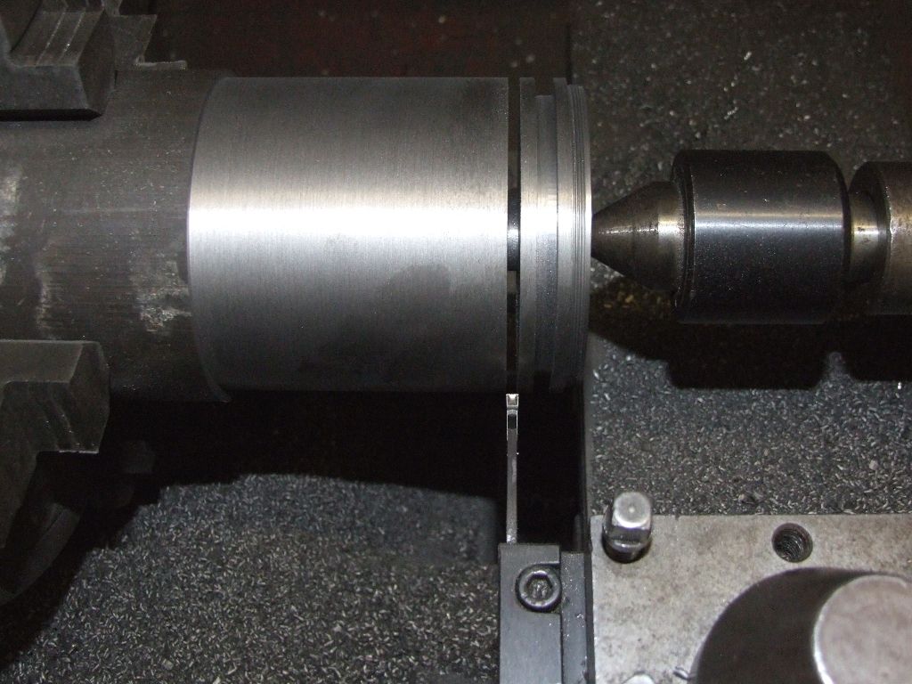

Andrew, you mention using better inserts, which ones
I've used assorted brands over the years but I've settled on Korloy inserts from Cutwel. I use CCMT inserts for everything except aluminium, where I use CCGT polished inserts.
For parting I use an Interstate blade system and whatever insert came with it. I use the same insert for all materials, including aluminium. Flood coolant is used for all materials except those which are short chipping, ie, brass and cast iron. The single most important factor is feedrate. Below 4 thou/rev the insert chatters. At higher feedrates 6-8 thou/rev the chips curl properly, are folded inwards and break into relatively short chips. The system seems to work fine on deep grooving too:
