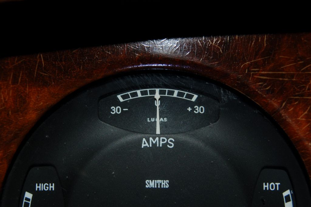

        Hi, is anyone familiar with the above topic? I have a classic car which I have converted from dynamo to alternator and am in the process off converting from ammeter to volt meter and need to change the wording . I know that instrument manufacturers use the pad printer process for their dials but what paint to use etc. Any info would be helpful.

                                dsc_0005.jpgWow, thanks guy's, that's given me something to think about.
                                I think that a vinyl stencil would be the easiest way forward with this one.
                                Thanks geary for your offer, I have downloaded some photo's to show what needs to be done.dsc_0001.jpg

                                  I'm curious how the ammeter on a classic car can be adapted to read volts?
                                  I would have thought the ammeter was a moving iron type gauge (and be centre zero) so far from idea to read volts.
                                  As an aside, but relevant to the original question, I created scales for the analogue gauges in my car using two different techniques. The Speedo and Tacho were drawn in AutoCAD and laser printed on good paper that was glued to the original dial (flat fortunately). For the smaller gauges which had concave faces, I used white Letraset on the dial that was black painted.
                                  Ian P
                                  #267734
                                  Ian P
                                    @ianp
                                    After posting my reply I saw the pictures of your instruments. I'm pretty sure the ammeter is a moving iron type but if you could get another 'OIL' meter movement it would probably fit in place of the ammeter leaving you with your original problem of how to change the label.
                                    White Letraset would be OK…. but
                                    It unlikely that a suitable font is available nowadays, also obliterating the old text and achieving flat unbroken black background would be challenging. Actually applying the Letraset is easy by comparison.
                                    Ian P
                                    #267736
                                    Clive Haynes
                                      @clivehaynes74488
                                      Hi Ian P, I said that I was in the process of converting from ammeter to volt meter, not converting the ammeter.
                                      I have got a segment type volt meter from a Triumph Stag which I intend to graph into position.
                                      The lettering must be exact as there is other lettering on the same dial face which I think would rule out letraset.

                                          Hi Ian, I intend to change just the one word from amps to volts and to use the guts of the volt meter but keep the original dial face but remove the +30, -30 and the 0.
