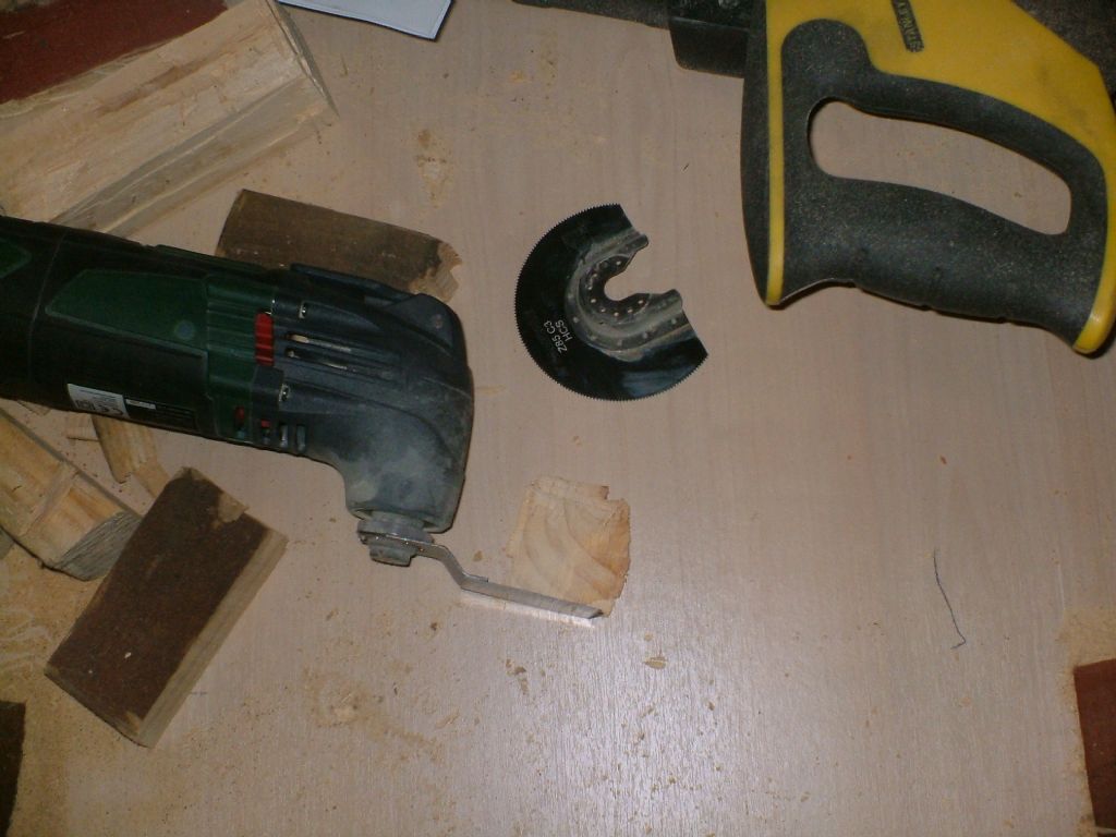

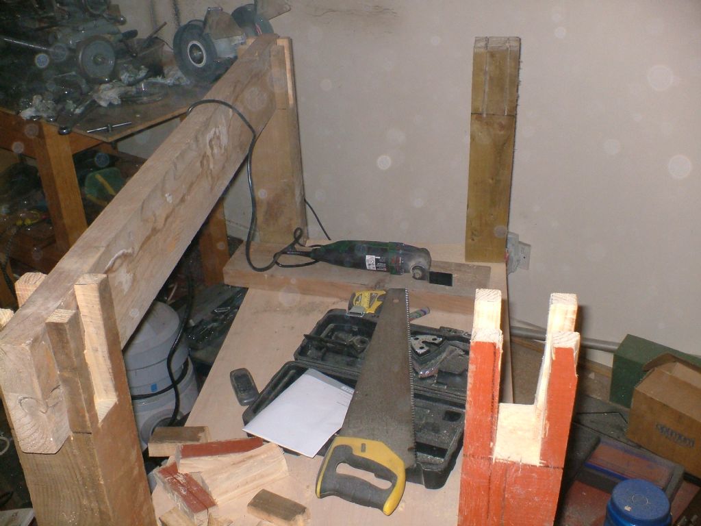

      I had cut a few big slots with the handsaw yesterday and it jigged my back so I thought that was it on this job until Monday at least
      but no…. !
      This new toy really can do the lot, and even better, my work is more accurate because it's so good at making woodwork for numpties easier
      So this weak pathetic old geezer has been romping along with a knackered back
      Got to stop now but I was wondering if anyone in here uses them for cutting steel metal and thin metal plate?
      They are miles easier to handle than a jigsaw and I notice quite a few fancy cutters on a well known auction site which seem to be aimed at the metal market

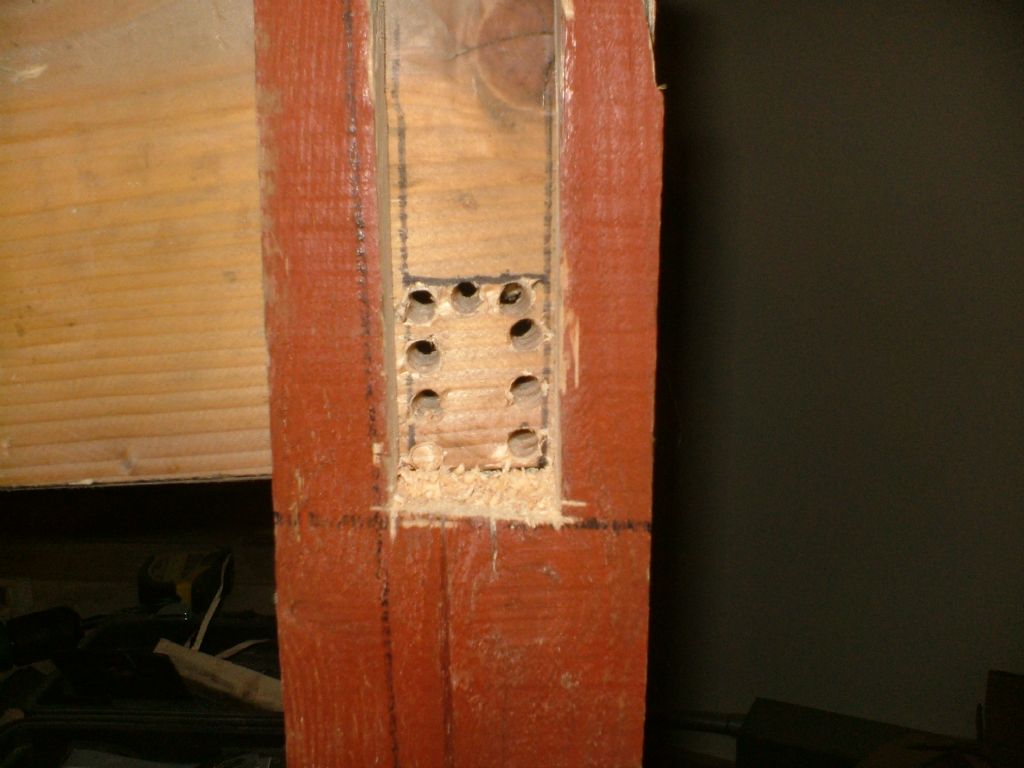

                    I have found you can speed a job up considerably by drilling holes to give the saw less work and prolong the life of the blade at the same time
                    It's also great for shaving down close fits and can file away 0.5mm at a time from a tight joint until it fits right
