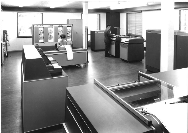

                          In the early '60s, we used a system called Numerical Master Geometry, ran it on an ICL 1905 main frame computer (using all of it for a single run). With the system, we defined 3-D shapes like wings, cockpits, fuselage etc. Forerunner of CAD ??
                          https://pdfslide.net/documents/numerical-master-geometry.html

                            Probably got the processing power of a wrist watch today
