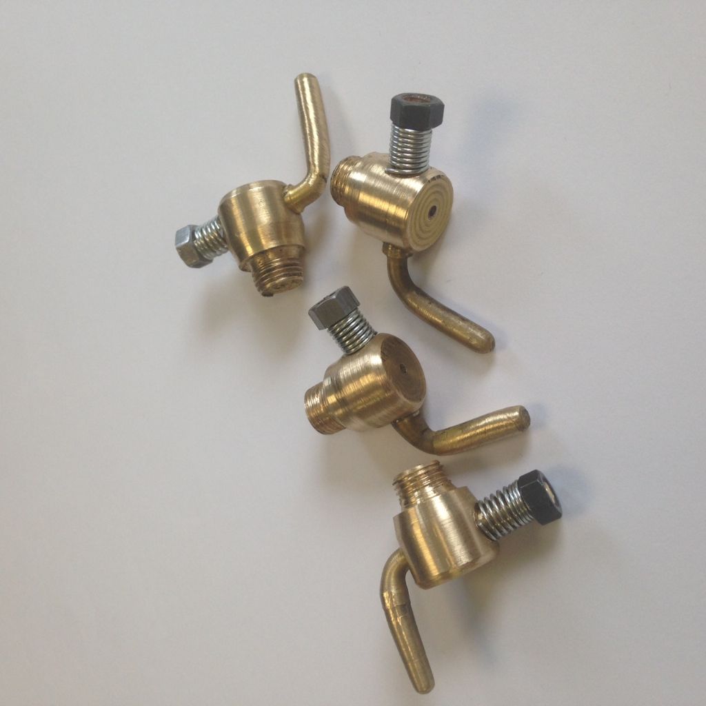

      It is fair to say that there are more skills required to be mastered when making cylinder drain cocks than might first meet the eye. A lot more! Whilst these are a long way from aesthetic perfection they operate correctly and most importantly don't leak. I might make some pretty ones later but for now im happy.img_1633 (3).jpg

          They look excellent. I bought mine from the UK as I did not think I have the skills yet to make my own. What size thread is on those ?

            Thread size is why I had to make my own as no one seems to make 5/16 x32 and I didn't want to sleeve the holes.

              I realised that "watchmaker skills" were required for doing ME a while ago, but haven't gone down that path yet in my own journey
              Which lathe did you use to make them Fizzy?

                Did you take any progress photos ? I am interested in how you made these.

                  Now theres an idea, a progress thread for those like me….. I tried to make them on my Harrison L5 but way to big so I used the Clarke Mini lathe. The key skill to develop is to move the topslide very smoothly without pulling or pushing the wheel.
                  #248208
                    Short bit of allen key in hand drill run at low speed and poked into the screw on the top slide handle.
